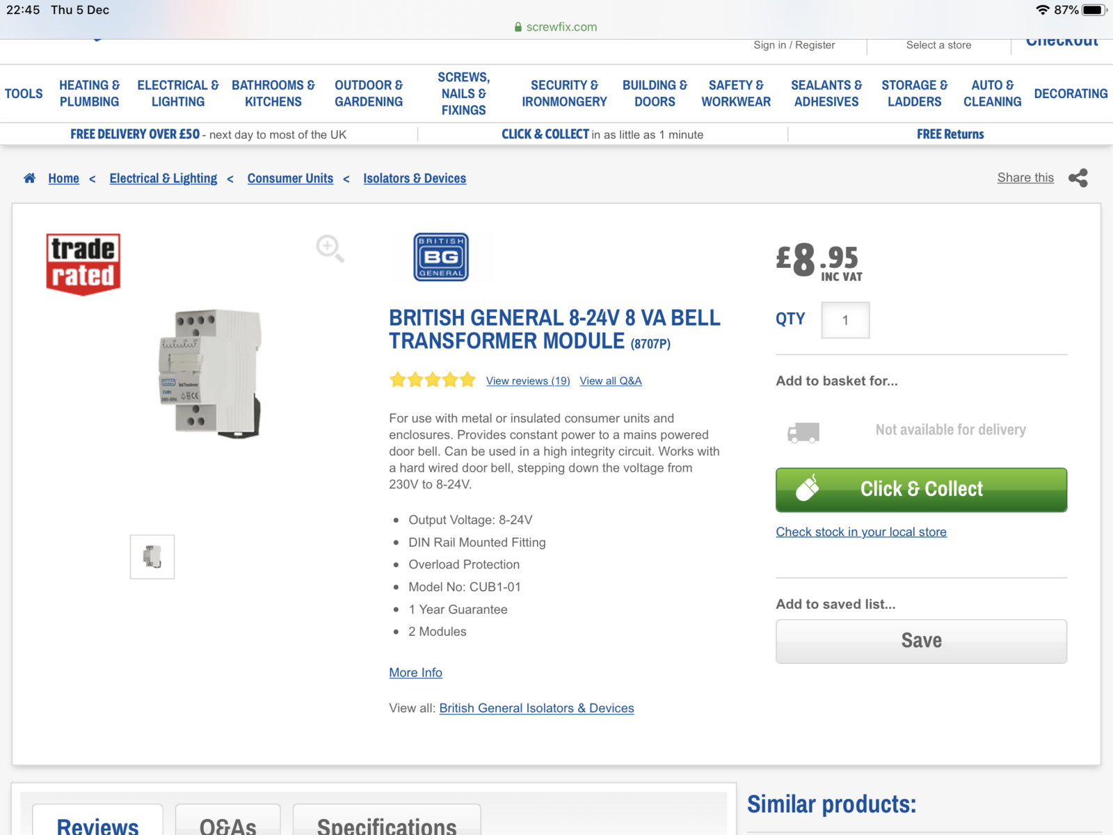

Sorry to wake this thread finding it hard to find a chime for the nest hello. Have the above transformer module from Bg that can supply 8,12 or 24 volts , obviously nest hello doorbell works fine on this but issue comes with the chime.
Honeywell have a chime but will only take up to 16v. Lots of people just stay put 24 v through the transformer to the nest and Honeywell chime but I am concerned?

Last year, my customer asked me to connect his nest hello to a Honeywell chime (HONEYWELL DW915S).
His electrician had tried, failed and gave up.
From memory, I used the 12v supply on the transformer.
The chime is not officially supported by Google but I found wiring advice on the web.
I may be doing some work at the house tomorrow or sunday. I can make a note of the wiring if you want (assuming that you have the same chime).
Thanks for the reply opps. A friend has been running 12 volt from the transformer to a d117 Honeywell and it's been working fine he advises. Thank you for the offer for looking though.
Sorry for the noob question but on the transformer as the picture does it matter which way the live and neutral wire go into the transformer block as the red lines. Does polarity matter here? Thanks

It makes no difference which way the live and neutral go.
You will need an enclosure to put it in though.
On another job were the customer has a ring door bell, his builder's electrician just screwed the transformer to the wall...
Oh and the reason I offered to show you the wiring is that the DW915S uses 3 inputs. If yours only has two inputs it should be straight forward.
Screwfix do a din rail transformer (BG) for £9. I think they have 8/ 12/ 24V options.
