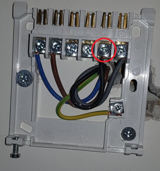

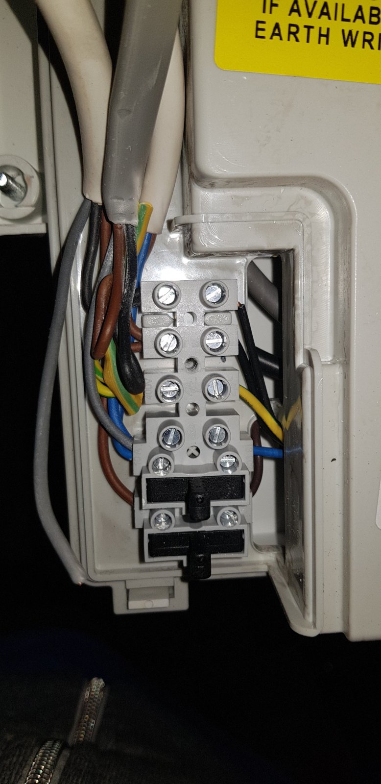

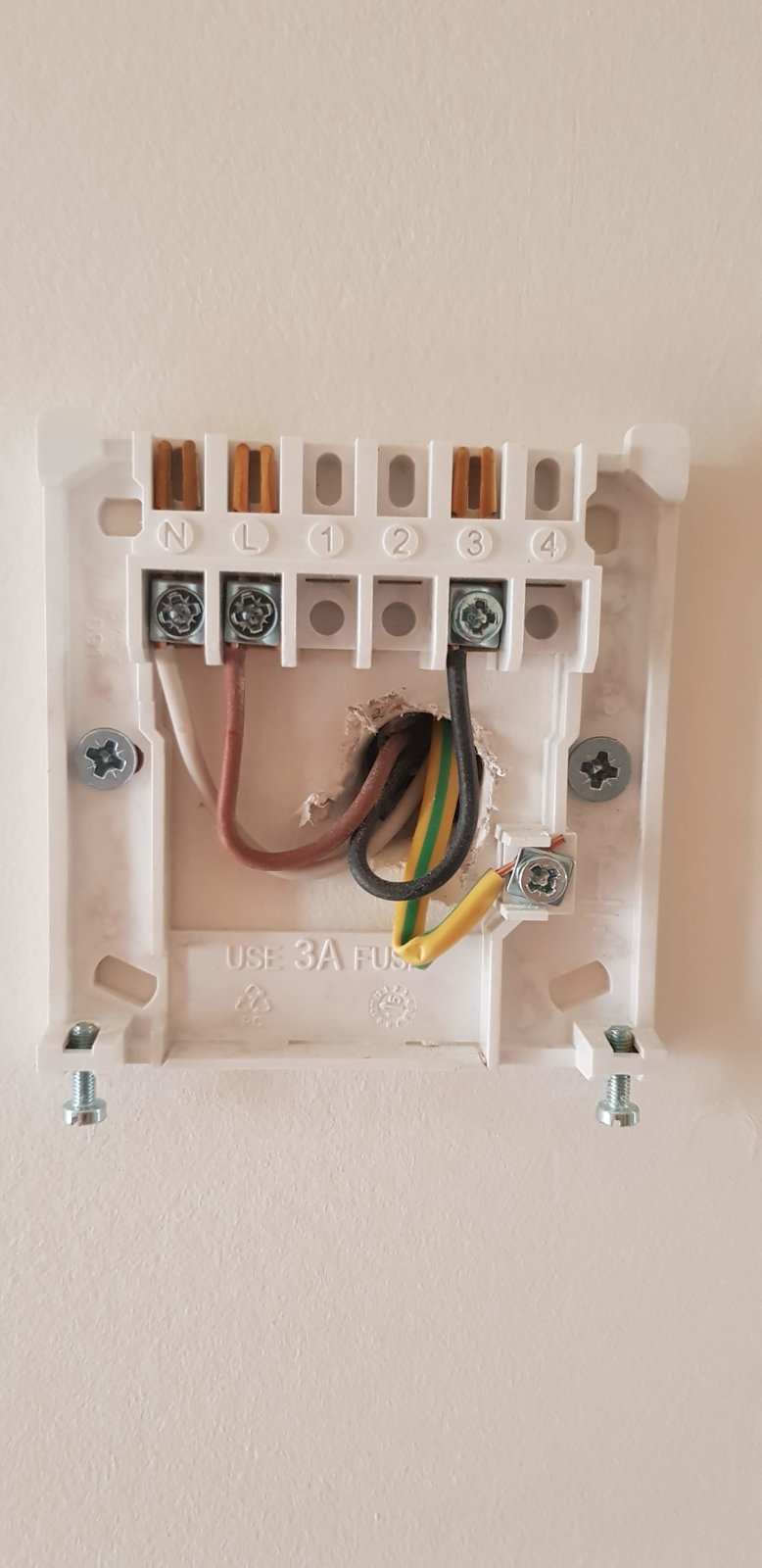

Understand how the heat link interacts with the boiler, was tossing up putting it in place of the existing LP822 but then thinking about the 12v requirement to the room stat I thought I'd put it by the boiler and re-use the existing stats wires...except I can't work out where the heck the existing stat is wired! I've attached photos of the boiler block + the back plates for the LP822 & RTS1...I cannot work out where that RTS wiring is going.
At the block you have power to the boiler, 3-core heading off to a frost protection stat in the garage and 5 core to the LP822. At the LP822 there are no wires heading away from it to anywhere but the boiler - anyone care to point out what is undoubtedly obvious?

From the boiler wiring photo, it appears that you have the combi version of the Promax; yet the Drayton LP822 programmer is a dual channel programmer designed to control central heating and stored hot water (ie a system with a hot water cylinder) ...so a bit unusual to find a connection to the LP822 terminal (3) which is there to provide control of stored hot water, on a combi system.
If you don't have a hot water cylinder, probably the easiest solution would be to remove the existing wiring going to the boiler. (with the exception of the 230V supply and the frost stat) Mount the Heat link next to it and wire it straight in.
The top terminal (with the wire bk 1 in) goes to the Heatlink terminal 'Heating Call for Heat' (3)
The next terminal (with the wire bk 2 in) goes to the Heatlink terminal 'Common' (2)
The N & L terminals connect to the Heat link N & L respectively
The frost thermostat and 230V wires stay as they are.
You should only do this though if you can access your boilers wiring terminals without having to open a room sealed compartment. If it is necessary to open up a room sealed compartment to access the wiring terminals, this should only be done by a Gas Safe engineer who can ensure it is properly sealed up again afterwards.
If you do have a hot water cylinder there will be other controls and a motorised valve / valves elsewhere, in which case more work would be involved and you would need to provide details of them for more advice.

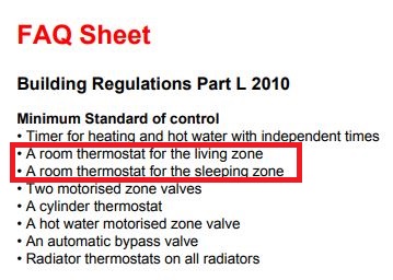

You say it is a "brand new house". New houses since 2010 should have more that one heating zone, usually one for upstairs and one for downstairs with separate controls. In which case, you would have a multi zone system and need two Nest thermostats and Heat links.

However, For properties built since 2010 the building regulations require at least two separate room thermostats, each with a dedicated motorised valve. (This is in addition to TRV's on the other radiators).....and as your home is "brand new"........ Are you sure there isn't one behind a wardrobe or something?

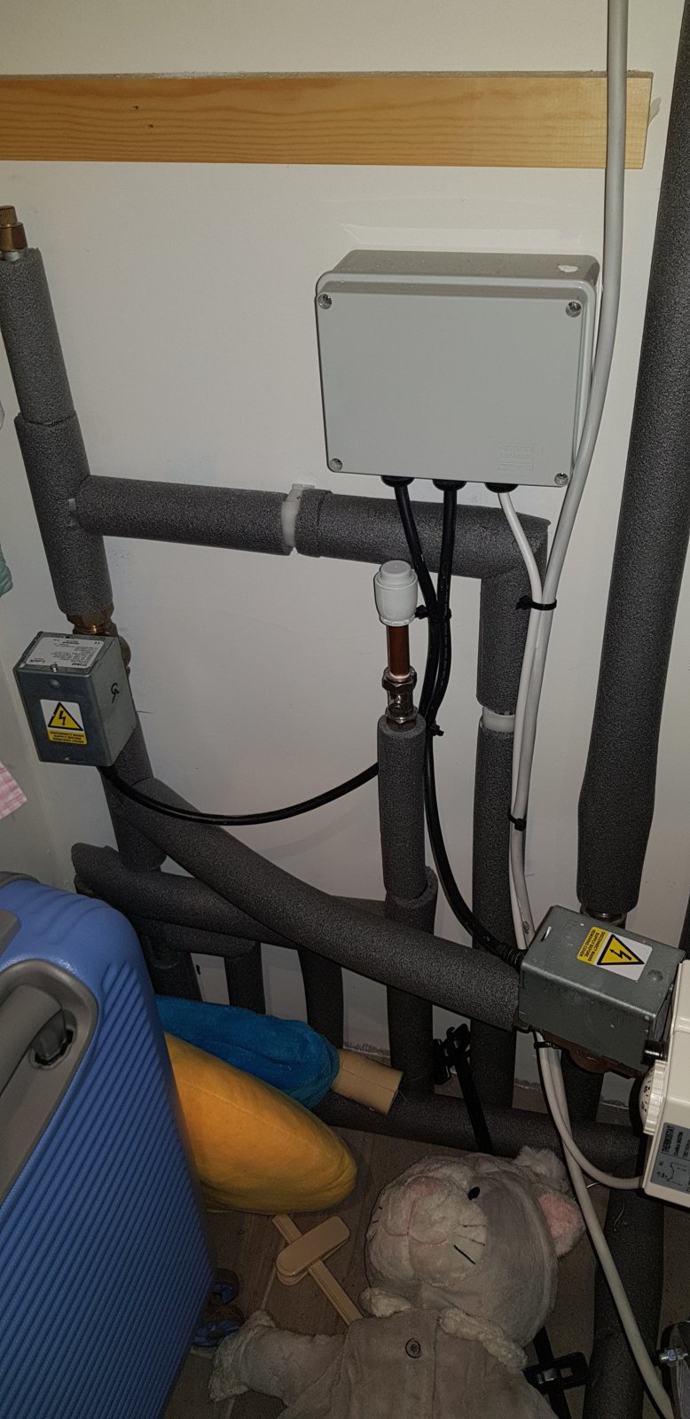

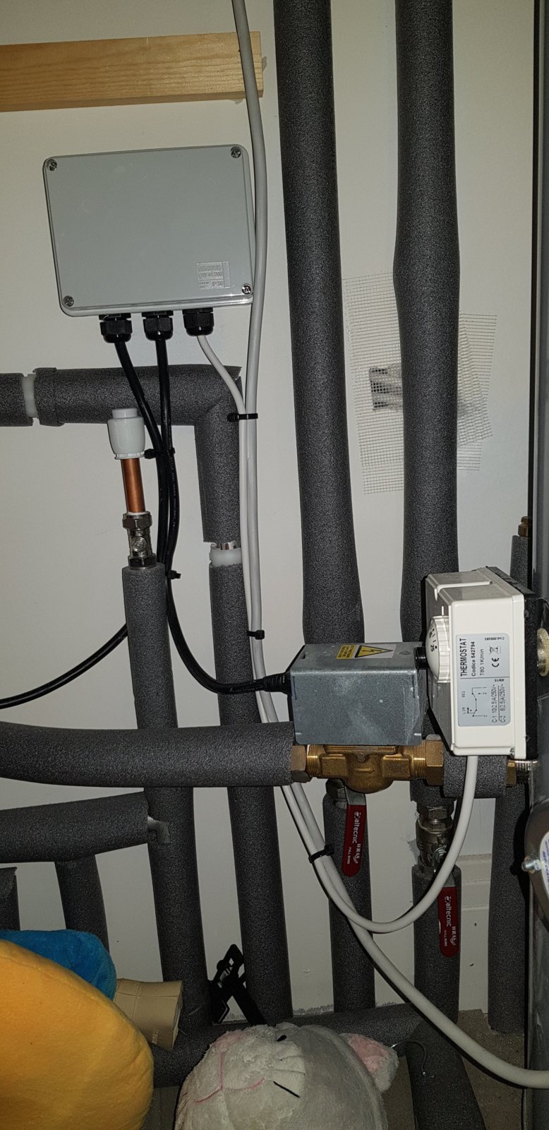

Meant to include this photo, it's of one of the motorised valves and the cylinder stat...unless I've got it entirely wrong.
That's indeed what they are. Looks like the motorised valve for the hot water control, there will be another one (or two;)) for the heating
Two sighted (only two!)! Unless one is hidden in that junction box!
Are there any issues with them potentially not doing the house to code?
Looks like you do only have one heating zone and hot water. (Don't know how it got past the building inspector, or what the implications are though.) So, one Nest will suffice.

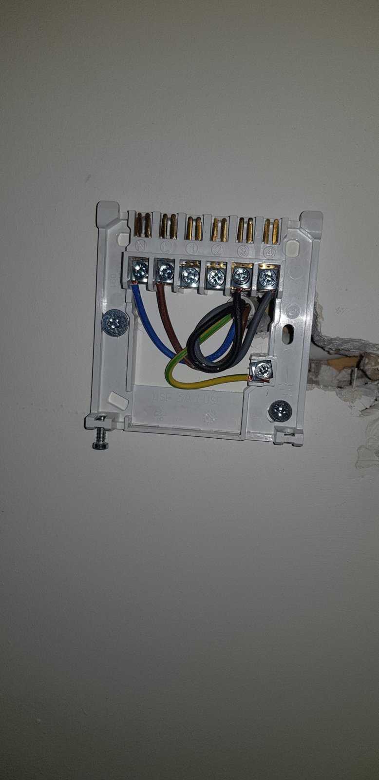

The Nest Heat Link replaces the Drayton LP822. The wires are moved from the terminals at the LP822 to the Nest Heat link terminals that have the same function.
Here are the Drayton terminals...
...and here is the Heat link
(N) & (L) are self explanatory
Drayton (3) 'HW ON' = Heat link (6) 'Hot Water Call For Heat'
Drayton (4) 'CH ON' = Heat link (3) 'Heating Call For Heat'
Then 'Common' terminals (2) and (5) need connecting to the (L) terminal with wire links
Earth wire goes in the earth terminal
Then trace the cable from the existing RTS room thermostat.....
.....back to it's origin. When you find the other end, note where the brown (L) and black (3) wires are connected. Then disconnect the entire cable and insert a link between the two terminals where you have just removed the brown and black wires from, take care not to disturb the other wires. The old thermostat can now be removed.
If you want to put the Nest Thermostat in this location, if you wish, you may reuse the old disconnected thermostat cable to connect the Nest Thermostat to the Heat link T1 & T2 terminals to power it. Otherwise the Thermostat can be powered by a separate plug in power supply.
