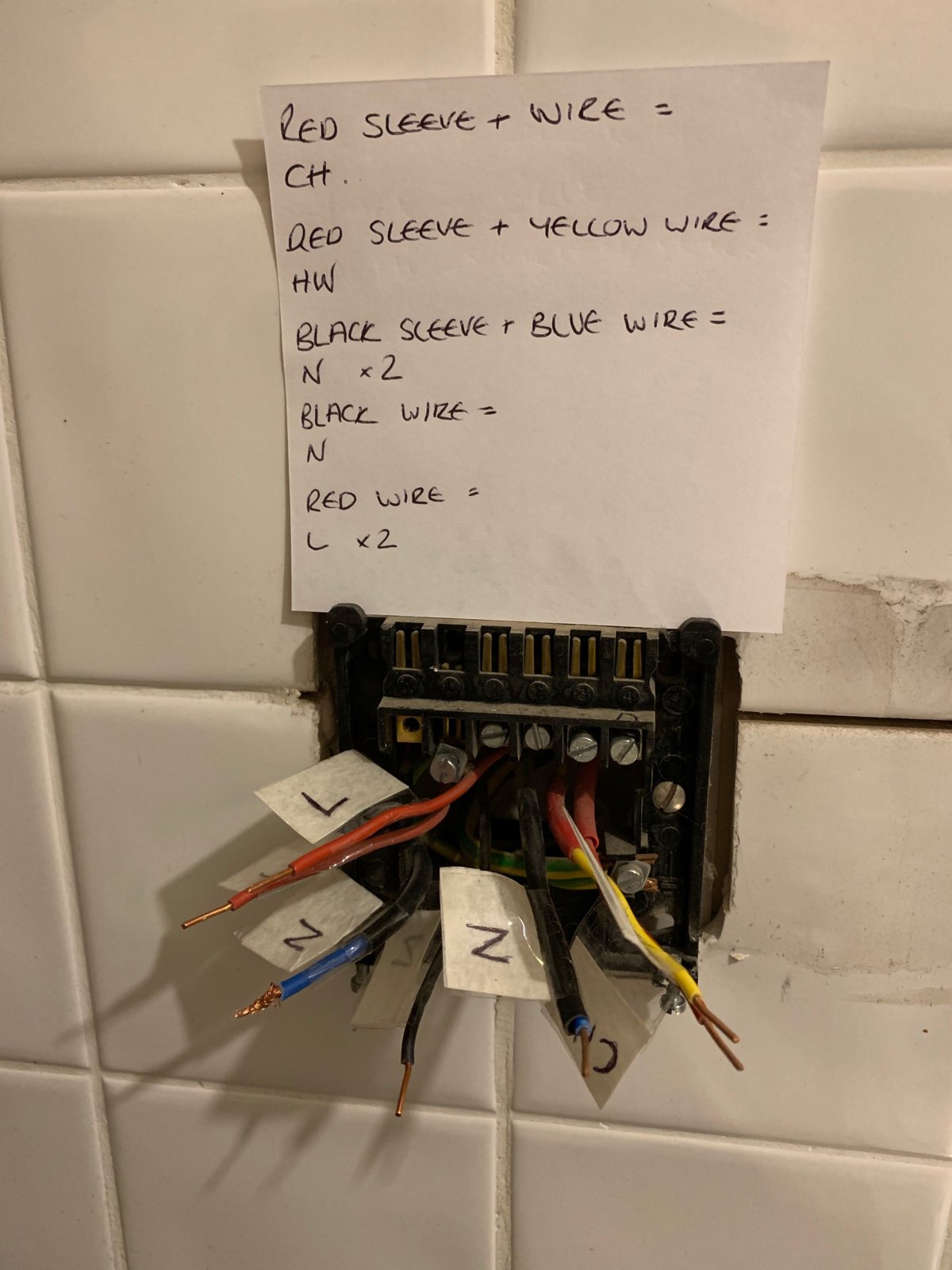

Nest Gen 3 even,

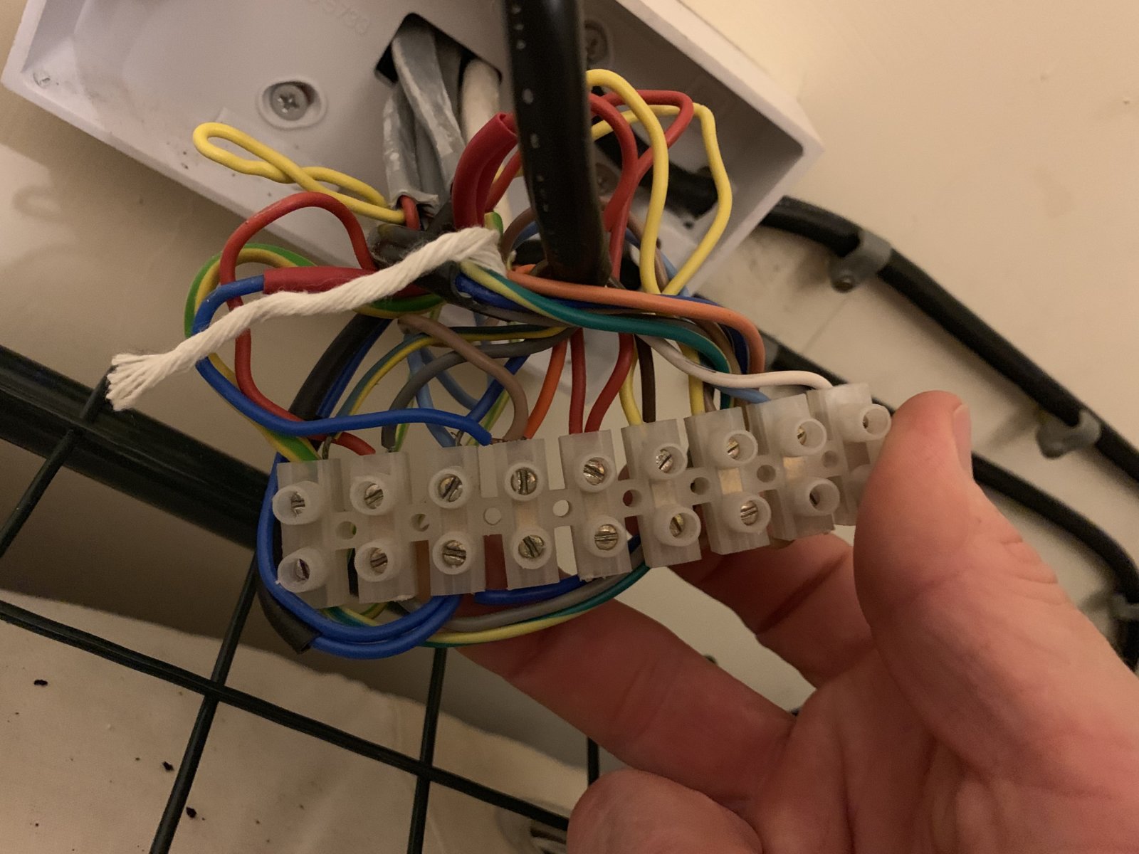

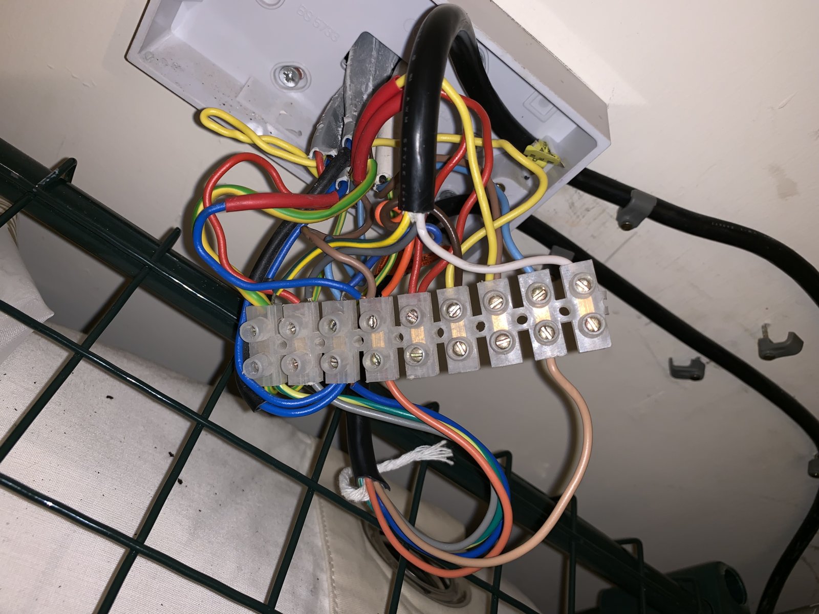

Currently have the following layout which is a S-Plan i believe

You need to wire your Nest Heat Link into the wiring centre on the first photo, which would benefit from re-wiring in itself to make things clearer. The wires at the existing programmer need to be safely terminated in the back box and hidden behind a blanking plate
