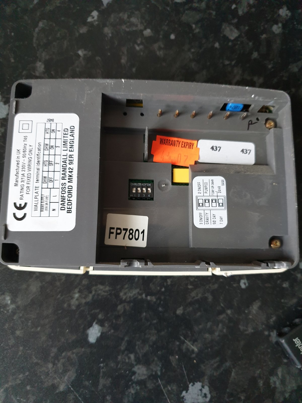

Hi,
I've recently bought a Nest 3rd Gen Thermostat and I'm looking to install it myself. I know how the system works but I'm unsure about a few things.
Currently, I've got an Ideal Classic Boiler and Danfoss FP7801/FP715si Programmer on a 3A spur in the Kitchen, Danfoss RMT230 in the Hallway, Danfoss WC4B Wiring Centre in the Airing Cupboard with Cylinder and 3 Port Valve.

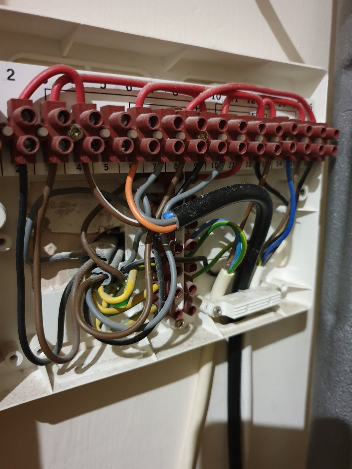

I managed to get more pictures of current wiring last night.
The Wiring Centre certainly seems wired as on lid.
It looks like Thermostat is a straight 4 core cable with Neutral and Earth into Wiring Centre Neutral and Earth terminals.

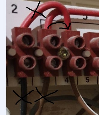

So to decommission it:
Disconnect all four cores and remove the thermostat cable, so that it is safely out of the way. The back and brown wires marked with X below should have gone.
Remove the loop between 2 & 4,
Move the top red wire currently in 3 to 4 where it will now be connected to the brown/white wire (that goes to the motorised valve) that is already there. [This is instead of the link I mentioned originally, but electrically achieves the same thing]
When you have removed the old thermostat from the other end of it, the cable should not be connected to anything. Ideally you should check it with a multimeter to be sure, [I once found someone had connected a wall light in an adjacent room to a thermostat cable by tapping into the L & N wires halfway along :eek:] If you wish you can then use two cores of this cable to connect the Heat link T1 and T2 to the Nest thermostat T1 & T2.

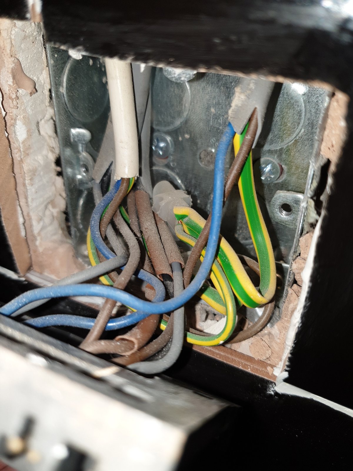

The Brown to Black in connector block behind Programmer, is that for Switch Live to Wiring Centre terminal 12?
Your guess is as good as ours, and probably better as you are actually present. Unfortunately there is no fixed or set way to wire a heating system. I have seen 100's and no two are exactly the same. The way wires are joined, the cables chosen and the wire colours used is solely at the discretion of the original installer and the layout of the various heating components in relation to each other inside your home. Photographs of the wires don't help unless you can tell us what is connected to the other end of each wire and any other wires that terminate from it.

Sometimes we can take an educated guess and then confirm our suspicions by electrical testing to make sure, but not over a forum. For DIY installation the simplest way would be to swap the existing programmer for the Heat link, and decommission the existing thermostat. The wires can be extended or shortened if required. Otherwise you will need to engage the services of someone competent that understands how all of the system components work and interconnect in relation to each other.
Hi Stem,
Thank you for all your replies, I've taken your advice onboard and I'm going to fit the Heat Link where the existing Programmer is and have the Nest Thermostat on a stand via USB.
