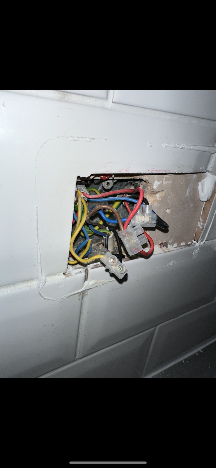

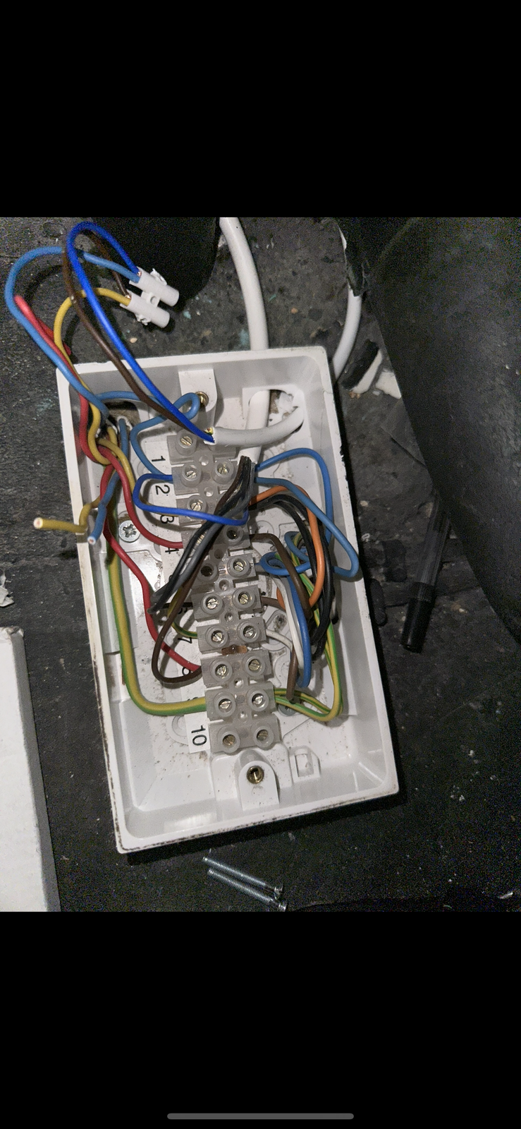

Hi all,
I currently have a Y plan heating system that previously had a Hive dual channel system installed.
I had Nest installed recently but it has been giving me problems so I wanted to revert back and as the old wiring was there, I thought it might be straight forward.
The Hive receiver was previously in the kitchen next to the boiler replacing the old thermostat control panel.

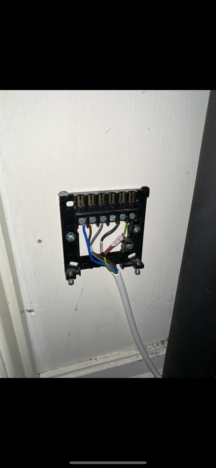

The Nest has been wired in the airing cupboard directly into the control center.
I’ve had a look at the old wiring near the boiler which was blanked off, and it seems there is only two spare wires, a yellow and blue wire (I know they can be used for anything in heating systems) bar the live and neutral, I’m thinking these were CH ON and HW ON but I’m confused as there is no HW OFF here?
The Hive was installed by a British Gas engineer and all was working fine.
How could this have been setup?
I can also see the other cables and there is a boiler 5 core wire, a 5 core wire going to the control box upstairs and then a 3 core wire from the FCU and then another 3 core from there to the contol box so I can’t see where the HW OFF would have come from.
The Nest HW satisfied has been wired to the control center to the cylinder stat and 3 way valve satisfied.
I also can’t see any loops in the control center so I’m at a loss.
I’ve wired it back in the airing cupboard with the HW OFF but I’d like to put it back in the original place near the boiler as I’ll need to replace a couple of tiles to make good of the area and blank the existing wiring off.
I also removed the HW OFF after rewiring the hive to see the outcome in case there was something else funky going on but the heating stopped working as expected.
One last thing, there is no loop between CH ON and the 3 way valve as the old room stat was disconnected so I’m not sure if this has any bearing.
Any advice appreciated.
Thanks!

Seems a strange one. The Hive was definitely in the kitchen? - that said, would still need a hot water off.
Terminal 7 in the wiring center is usually hot water off (white wire) which currently looks like it goes to the back plate, which is in the cylinder cupboard? If that’s the case, then it appears to be wired incorrectly, as that is heating on? Also a cpc/earth has been used, which isn’t good practice
Seems a strange one. The Hive was definitely in the kitchen? Terminal 7 in the wiring center is usually hot water off (white wire) which currently looks like it goes to the back plate, which is in the cylinder cupboard? If that’s the case, then it appears to be wired incorrectly, as that is heating on?
Yes it was definitely in the kitchen which is why I’m baffled. I’ve already tried removing the HW off but then the heating doesn’t work.

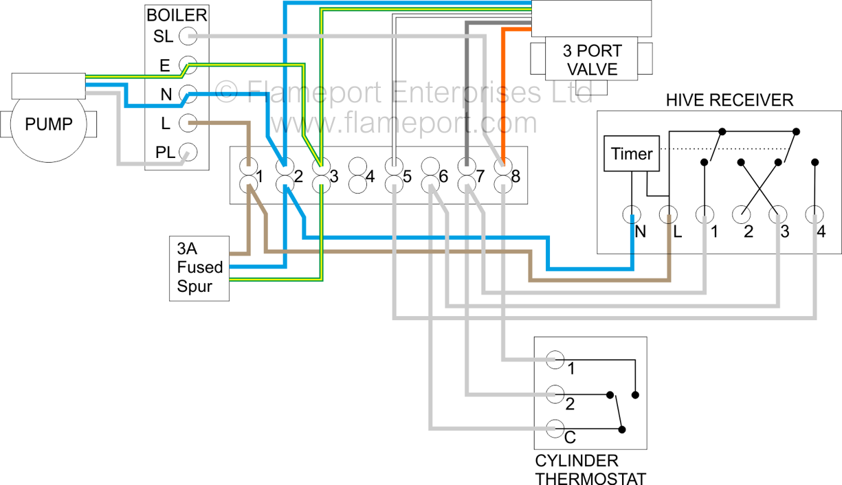

From the Hive diagram (and Nest) this does look like how it’s supposed to be wired?
I just don’t understand how it worked before without the HW OFF, unless the BG engineer put a link somewhere which allowed it to bypass somehow?

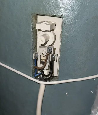

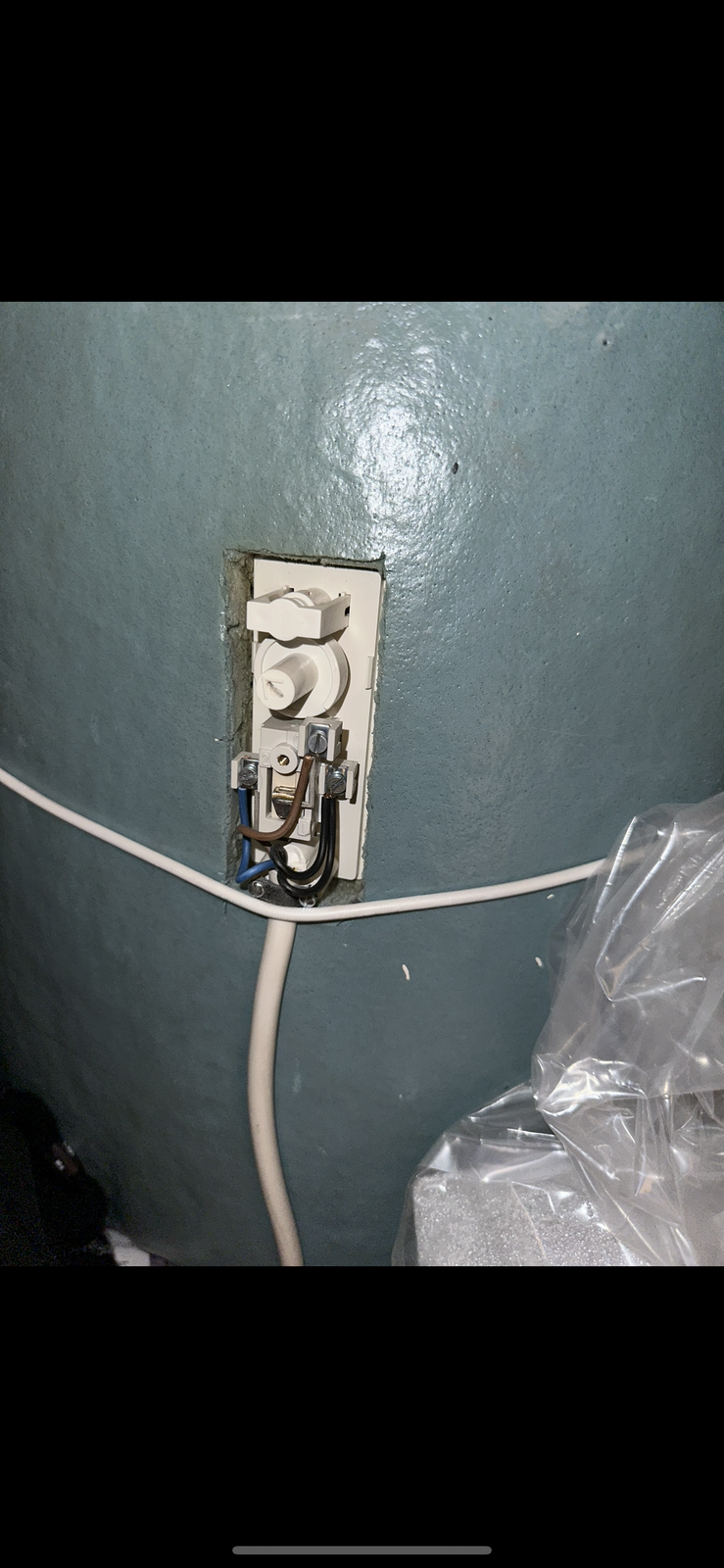

What I don’t understand is why is there x2 black wires in the cylinder thermostat, unless it was this that controlled the hot water off? Perhaps one of the more experienced can assist?

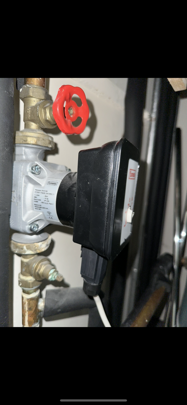

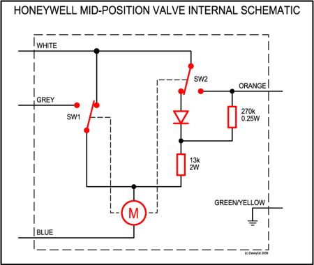

The mid position three port valve needs power to the grey wire to turn off domestic hot water (DHW) when the central heating is running. However the DHW can't get any warmer than the central heating water, so if missing it just means the valve will not travel all the way over switching off the DHW, so most people would not even realise the wire is missing.
With the modern gas modulating boiler it is important that the grey is powered, as the boiler can fail to give full output if the return water is too hot, with older boilers or oil boilers which don't modulate it would not matter.

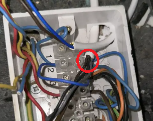

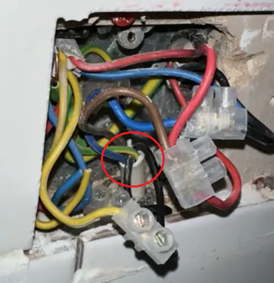

If the cable circled below...........

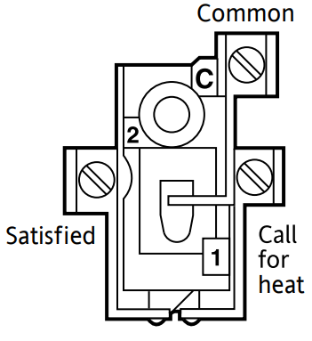

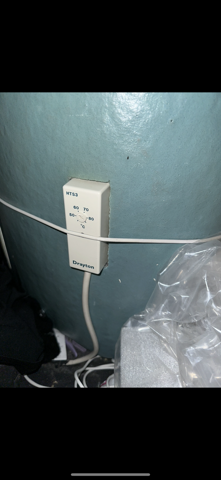

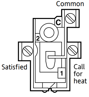

.....is the same one that goes to the HTS3 cylinder thermostat here.
Then the blue wire in this cable is the 'HW Off' (aka Satisfied)
If on the other hand, this is the cable from the cylinder thermostat, then what is connected to its blue wire? I can't see from the photo.
To be honest with this installation, I would probably disconnect everything and start again from scratch but still using the existing cables. It's difficult to see the wires properly and to know where they terminate from photos.
As an alternative you could put the wiring back as it was with the Nest and put the Hive receiver in the same place as the Nest, so it would just be a matter of swapping the wires over from the Nest to the Hive. However, that doesn't take into account...

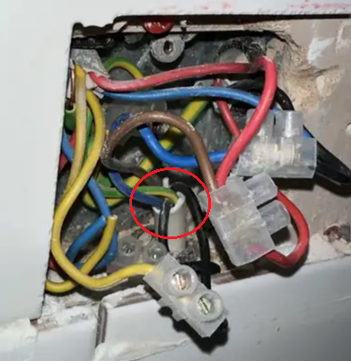

Hi Stem, thanks for your advice.
The cable you highlighted is one of the boiler cables either SL or PL, there’s two black cables coming from the boiler which are then going into the connector blocks independantly and then into the wiring center.
I think disconnecting everything would be a good idea but again I’d still be left with one wire short in the wall for HW OFF.
I had an idea which might be correvt, the boiler has the two black wires as mentioned above, could these have previously been connected to the same block? And then at the wiring center, connecting to the two current blocks? If so, this would free up a cable which could then be used for HW OFF.
Are the any implications of it being done this way or have you ever seen this done? This would mean if the boiler was triggered so would the pump and vice versa but I guess this makes sense as they both need each other anyway?
The boiler I have is a Potterton Suprema 50L if this helps.
Thanks again

Hi all,
Thanks for the replies.
I think I have figured it out with the help of my neighbours setup as they have the same system as myself (new build estate circa 2002).
The wire missing for the HW OFF (3rd wire which I needed) was repurposed as a permanent live to the Nest in the airing cupboard.
I’m not sure why the engineer decided to do this, he had all the cables he needed next to the boiler, N, L, HW OFF, HW ON, CH ON but decided to fit it in the airing cupboard anyway!
Thanks for all the help anyways to try and figure it out!
