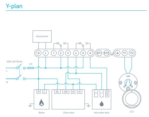

So that brings me to the wiring. Initially as @ianmcd I thought about the HW off connection which comes from the programmer and the hot water cylinder thermostat. I tried to introduce mistakes, including transposing the wires to create all sorts of errors, but can't come up with one that produces the symptoms you describe.
At the end of the day, I think it will have to be a matter of checking that the wiring between each of the components is correct and goes where it should.
[In the above diagram 'Hot water tank' = Hot water cylinder thermostat, and the boiler will probably also have a permanent Live]

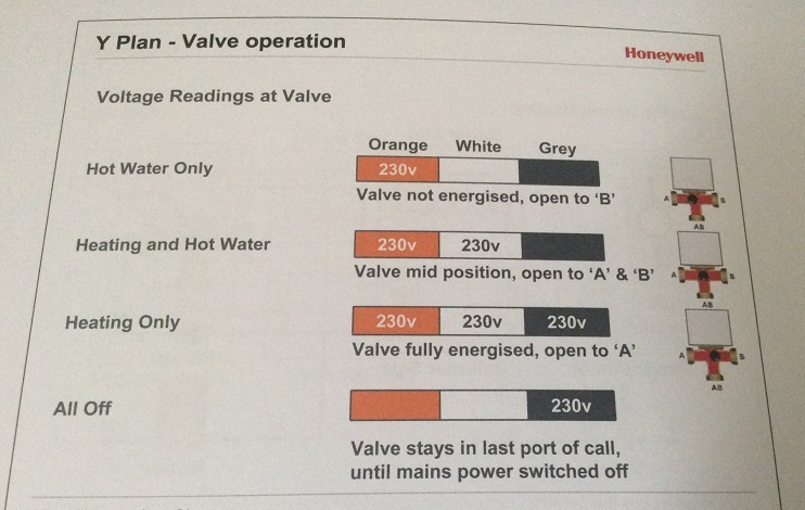

The motorised valve and its wiring can be tested with a multimeter if you are competent to do so. If you are, here's a table of the results you should find.
Heating 'on' = Nest set to heating 'on' and thermostat calling for heat
Hot water 'on' = Nest set to hot water 'on' and hot water cylinder thermostat calling for heat.
With regard to the 10v. That could be being fed back from other parts of the system. The motorised valve which has power on even when the hot water and central heating are 'off' has various resisters in circuit which can cause odd voltages. There have however, been instances with certain boilers being triggered by lower voltages but they are usually in the region of 70v plus. Fitting a capacitor usually sorts it, there's an example here.
