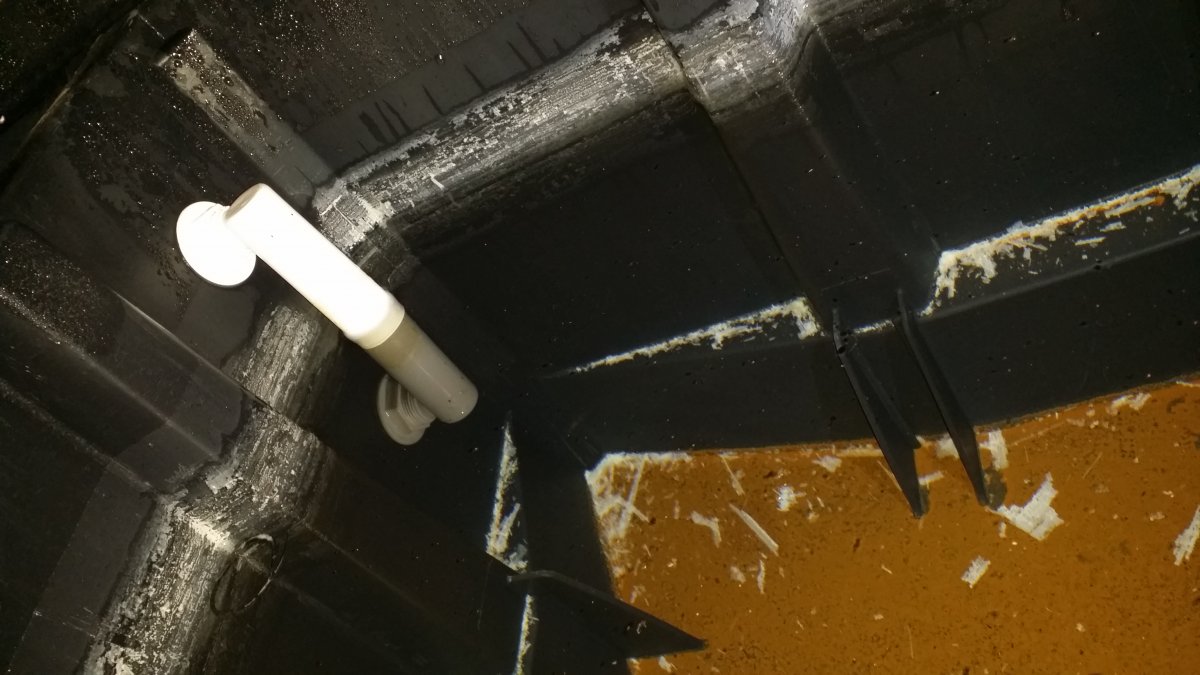

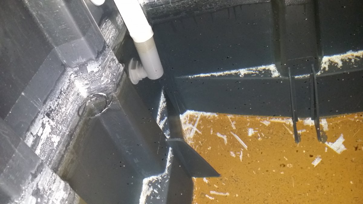

The cold water tank in the loft is covered but is full of debris - please see picture attached! I intend to clean the tank very soon before we fit the water softner.

is yours an old house with steel supply pipe? That looks rather like rust sediment to me
Using the cold supply in the bathroom is normal I'd have said for brushing teeth etc. I wouldnt be using hot to brush my teeth to be honest, and looking at the muck in the bottom of your tank, I'd want to clean that out and fit a lid before I bathed in it... Is it rust sediment? (or looks to me like sand!)

Thanks John. It is 1930's semi detached bog standard house and as far as I can see, we have copper pipes, but I will double check. It is sand at the bottom of the tank, possibly unattended for at least last 7 years or more.

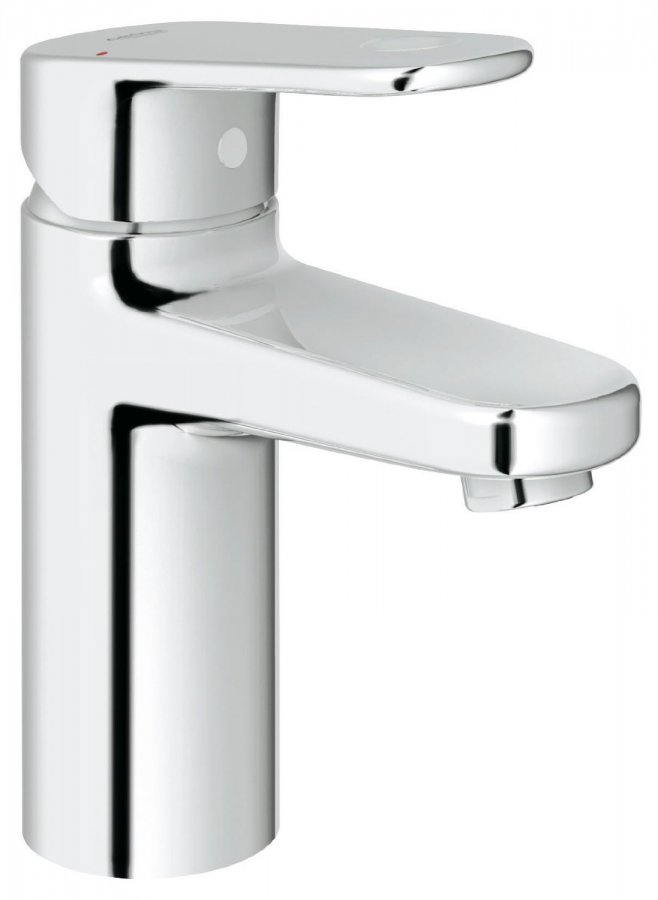

Hi Hugh, it is indeed sand in the tank, water from mixer (picture attached) is comfortable than cold from mains. I will soon get the tank cleaned. I had to urgently change the ball valve first after we moved into this house.
