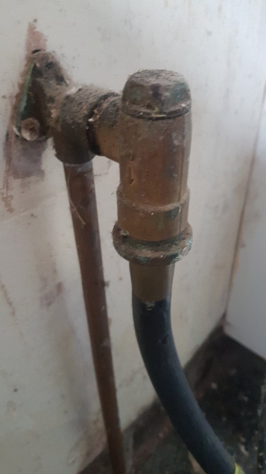

Never seen this gas fitting before? Safe for DIY?
31 Jan 2016
7
I am a DIYer. I've done lots of wet plumbing in house but never gas for obvious reasons. I just want to change over an old for new gas cooker... I was expecting to see some form of isolator valve when I pulled back cooker, but instead I see this.
1) What is it?
2) Is it an isolator or will I need to shut off the gas at the mains to swap over?
3) Is there a way for me to safely change cookers over without shelling out for a gas engineer?
I see a nut on the top, but dont want to turn it and risk knackering it when I don't know the piece of kit.
Al
turn gas off then you just push up the hose and turn the knurled ring with your hand
They are very common. Designed to allow a cooker to be connected without tools, using a bayonet connection. Plug and twist like the old light bulbs. Probably best to get a gas safe engineer to install it though, he will have the equipment to check for leaks.

You can disconnect the old cooker yourself using the bayonet fitting. However, I have seen more than one not reseal properly and leak. I would get someone in to disconnect and reconnect the new one at the same time.
