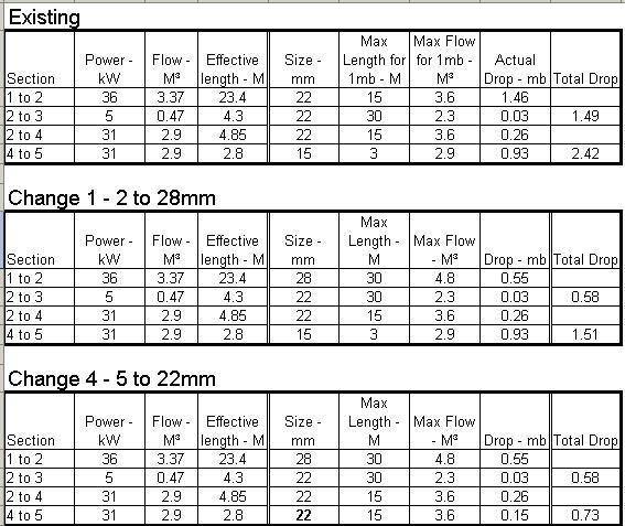

I used the OP's original figures (his calculations are way out) and got a drop of 1.49mb at the Range (5kW) and 2.42mb at the Boiler. So neither is within the 1mb limit.
Changing section 1 to 2 from 22mm to 28mm gives 0.58mb at the Range and 1.51mb at the Boiler. So the Range is within the 1mb limit, but not the Boiler.
Next, changing section 4-5 from 15mm to 22mm still gives 0.58mb at the Range, but the Boiler is now 0.73mB. So both are within the 1MB.
See the pic.

A-B load 3.76, corrected length 24m, pipe size 28mm drop 0.48.
B-C load 0.46, corrected length 4.3m, pipe size 15mm drop 0.0092.
B-D load 3.3, corrected length 8.15, pipe size 22mm, drop 0.48.
Total drop 0.97

Using the data originally supplied by the OP, I calculated as follows for the existing 22mm section 1-2:
Current effective length: 23.4m; Flow rate: 3.37m³
According to Table 1 the maximum length for a 3.6m³ flow is 15M. So a 3.37m³ flow would give a drop of 3.37/3.6 = 0.936mb down 15m of 22mm pipe. But the actual length is 23.4, so the drop will be 0.936 x 23.4/15 = 1.46mb.
Another way of looking at it is as follows:
According to Table 1 a 25m run of 22mm can carry 2.6m³ with a 1mb drop. But we have a 23.4m run, so you will be able to carry 2.6 x 25/23.4 = 2.78m³ with a 1mb drop. But the actual flow is 3.37m³, so the drop will be 3.37/2.78 = 1.21mb.
Which is the correct way, and if neither, where have I gone wrong?
Not sure what you doing DH.
Assume a size pipe. max load, corrected length, div by max length in the chart.
Adjust pipe size to get the permitted drop.
You need to increase the first length to 28mm and try the calcs again.
Dave PM me on that other place if you need more info.
DH , friction loss is not linear , your calcs assume it is , this is why you have two different losses for the same gas flow rate (maybe).
23.4 metres of 22mm delivering 3.37 m3 of gas would have a pressure loss of...
23.4/15 = 1.56 mb.
15 metres of 22mm tube will deliver 3.4 m3/hr of gas at a loss of 1mb at each end.
It seems your chart uses 3.6 m3/hr for 15m of 22mm , your calcs are also completly different to that of the chart you posted (domestic gas pipe sizing).
