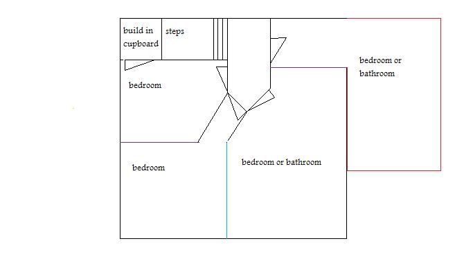

Im thinking of putting an extension on the rear of my house 4.10 meters wide by 3 meters out. Here is the present layout with the extension added.

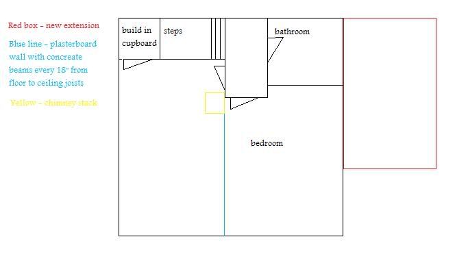

A few new plans
OK so ive got a few concerns, first off the blue line is a plasterboard wall but it has concrete beams the run from the rsj on the ground floor to the ceiling beams in the loft so i take it thats a supporting wall so if i take out some of the concrete beams i will have to build a frame with rsj's to take the weight. Also i will need to remove the chimney from the 2nd floor to the exit in the roof.
So just a few q's
Any problems with removing the chimney?
Is it possible to take out a few concrete beams and replace them with a rsj.
The house is a airey house just incase that changes anything, i will be getting a builder into do the work but i want to do my home work first to make sure he does it right.
create a corridor to the extension through your bathroom and pinch a bit of the existing back room for the bathroom, if that doesnt make sense what i am trying to say is to move the bathroom downwards on your top existing plan.

Think I would keep the bathroom in original position but make it bigger and then use the extended area next to the bedroom into an ensuite with walk-in wardrobe.

Where would the 3rd bedroom go?
my sugestion would allow for three bedrooms, a large front bedroom as is, a middle bedroom and then the back room, which will be the extension.
Thanks ive worked out what you mean now just been looking at doing it that way, i would end up with the left bedroom staying same, a small bedroom (2.5m x 3m) then the new extension been a new bedroom, the passage would pass through the old right bedroom, the bathroom would stay untouched and would lose the only window.

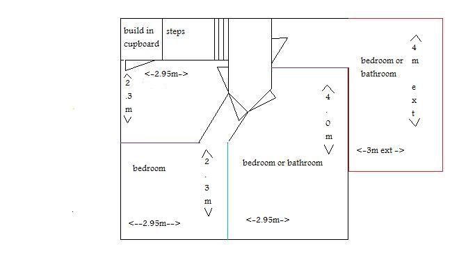

Whats too small for a bedroom?? 2.3m x 2.95? 2.5m x 2.95?
Also whats better a house with:-
1 bedroom 4.6m x 2.95m
1 bedroom 2.5m x 2.95m
1 bedroom 2.9m x 3.7m (est ext 4m x 3m)
1 bathroom 2.13m x 1.81m
Or
1 bedroom 2.95mx 2.3m
1 bathroom 2.95m reducing to 1.9m x 4m
so 1 one has 3 bigger bedroom and small bathroom or 3 ok bedrooms and bigger bathroom, my personal thoughts are bathrooms and kitchens sell houses but are the bedrooms at 2.95m x 2.3m too small as there are 2 of them thats size?????

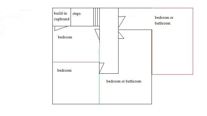

1john's idea
Another layout but with 2 smaller bedrooms
Another the passage is harder to do on this ones as the suporting wall will need work
Not quite what i meant but near enough, the corridor should be above the bathroom, would flow better up the stairs IMO
