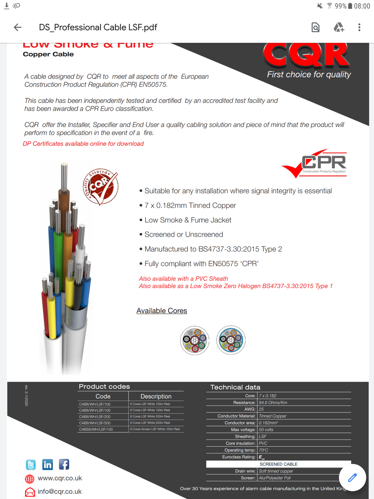

Our company only use CQR low smoke 8 core tinned copper cable.
Using 8 core allows for most manufacturer different keypad wiring configuration and also for damaged cables in further etc. Screenshot_20200730-080045.png
