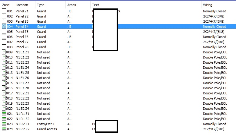

All zones currently used hence my thought of cancelling out the problematic zones which are 1 X PIR and 1 X door contacts and install a keypad/ ricochet on there and then I have ability to add everything I want, or have I misunderstood the concept?
okay an elite 24 has available 24 zones.
so how many of those 24 zones have you used up and how. ie what zones numbers are occupied with a hard wired device.
you need at least 8 free zones to add an 8XP-W to your system and use upto 8 wireless devices.

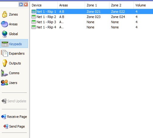

You are right. I thought there were only 8 in panel. There are unused ones as below. Keypads arent mentioned on any zone.
you can add an 8XP-W and possibly 32XP-W, but you have 4 zones assigned to the keypad so 12 zones free, depends if you need more than 8 zones or not I guess.
1 x 32XP-W is cheaper usually than 2 8XP-W, depends on how many zones you need I guess.

And why would the installer have assigned 4 zones to keypads?
