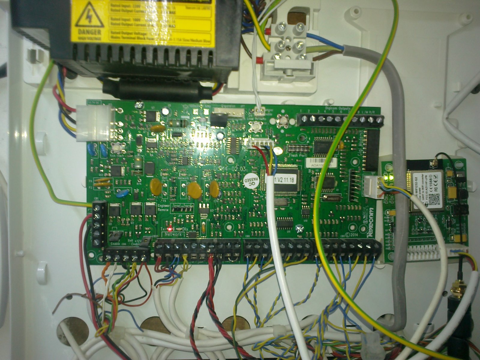

Just to make sure I haven't made a mistake in my description.
Pic below is my panel. Is the network port available for the ricochet? Where is it?
where you have two sets of red, black, blue yellow, it wires in there, says NETWORK above it.

you can add an 8XP-W and possibly 32XP-W, but you have 4 zones assigned to the keypad so 12 zones free, depends if you need more than 8 zones or not I guess.
1 x 32XP-W is cheaper usually than 2 8XP-W, depends on how many zones you need I guess.
SO if I have 12 zones available in the panel and install a 32xp then I will only be able to use 12 of the 32 zones?
