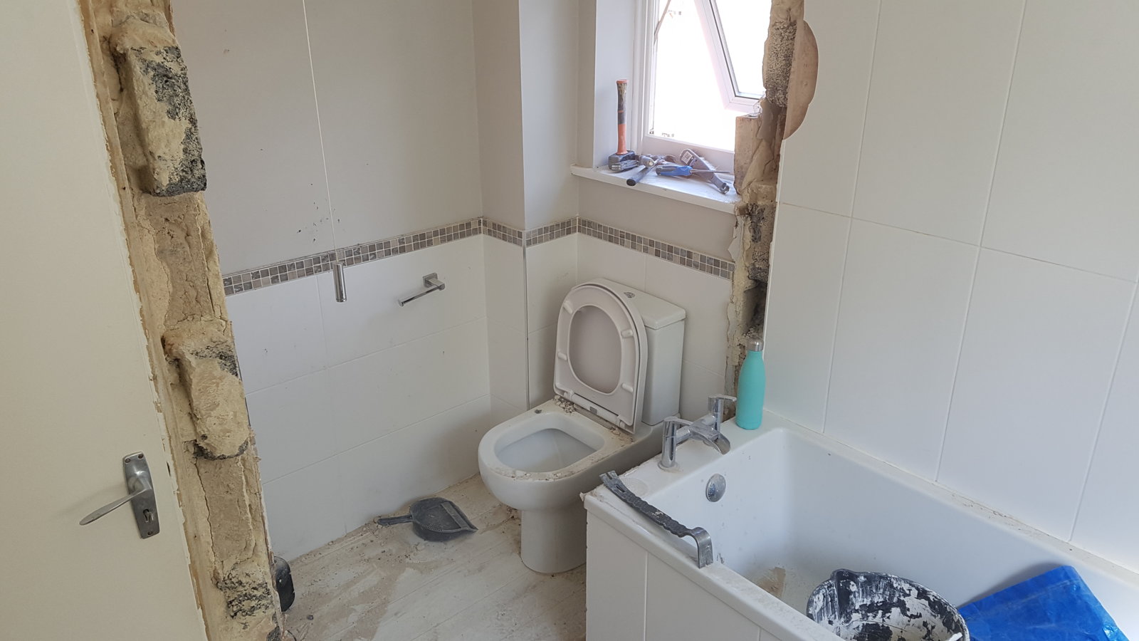

Step one was taking the wc wall down and also taking back a corner from a bedroom cupboard. Dusty as hell but lightweight blocks came out without too much resistance

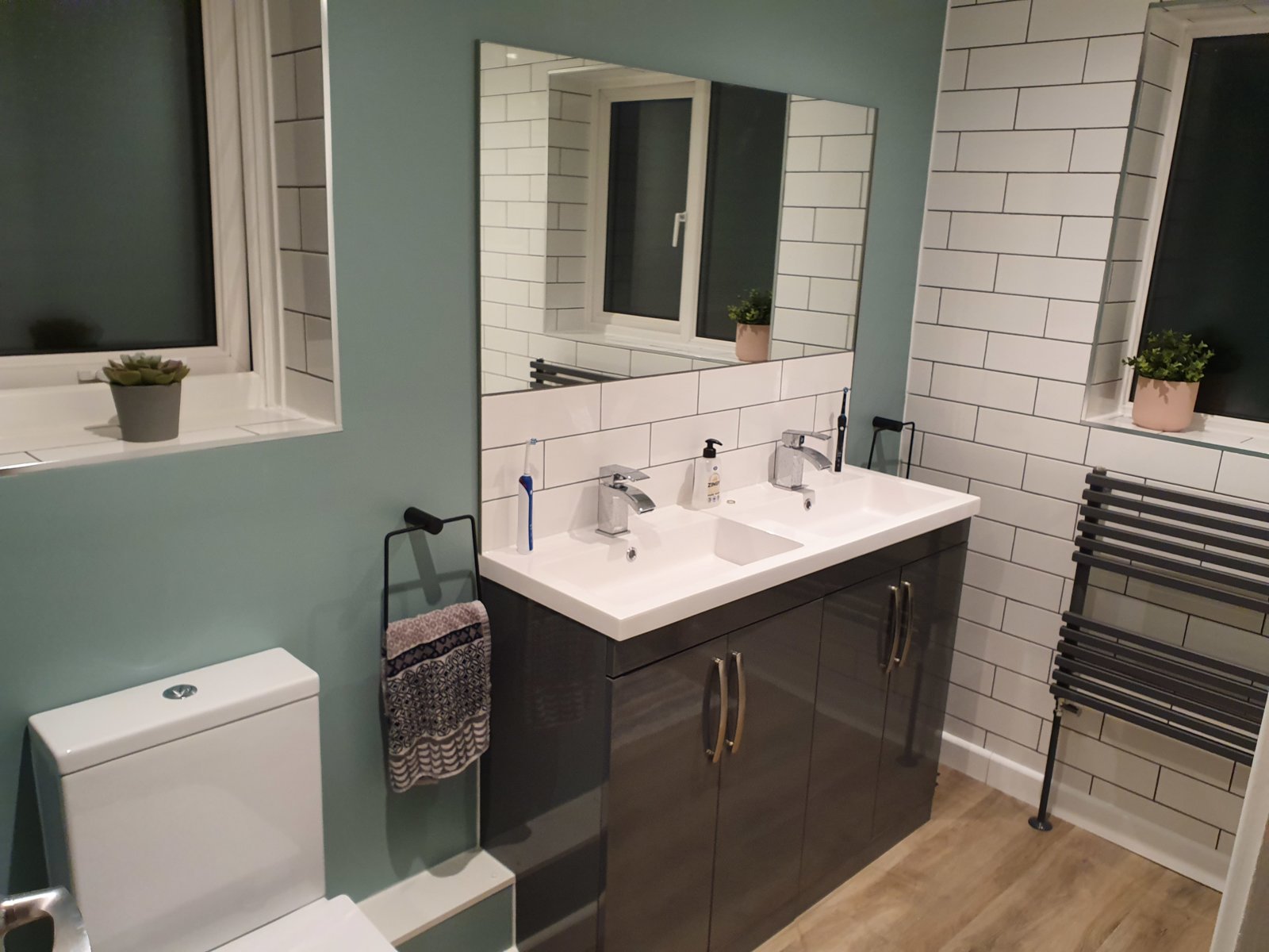

Waste boxing tidied up, click flooring laid, new double sink and toilet plumbed in. End in site.
Tiles above sink with made to measure mirror. Walls painted and finishing touches added. Got a sparky mate to sort the lights out now just need to give the ceiling a few coats of paint.

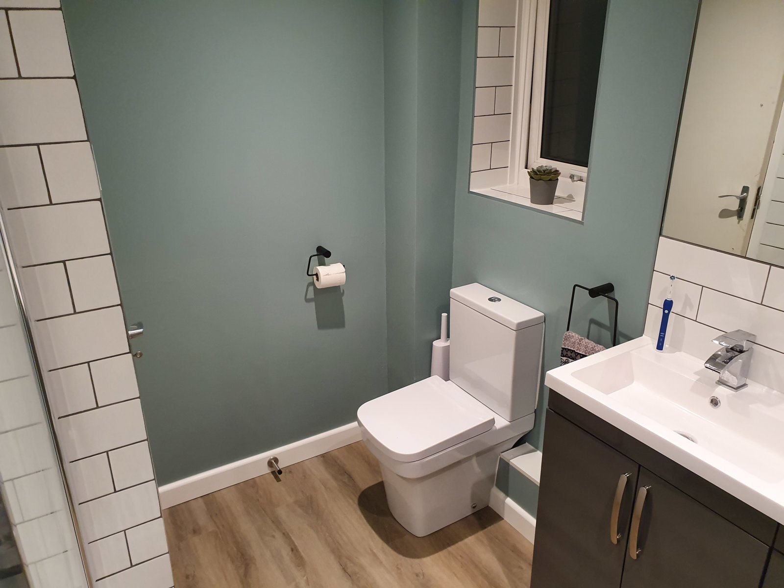

Not the easiest to capture in photos due to the shape and size but here it is...
