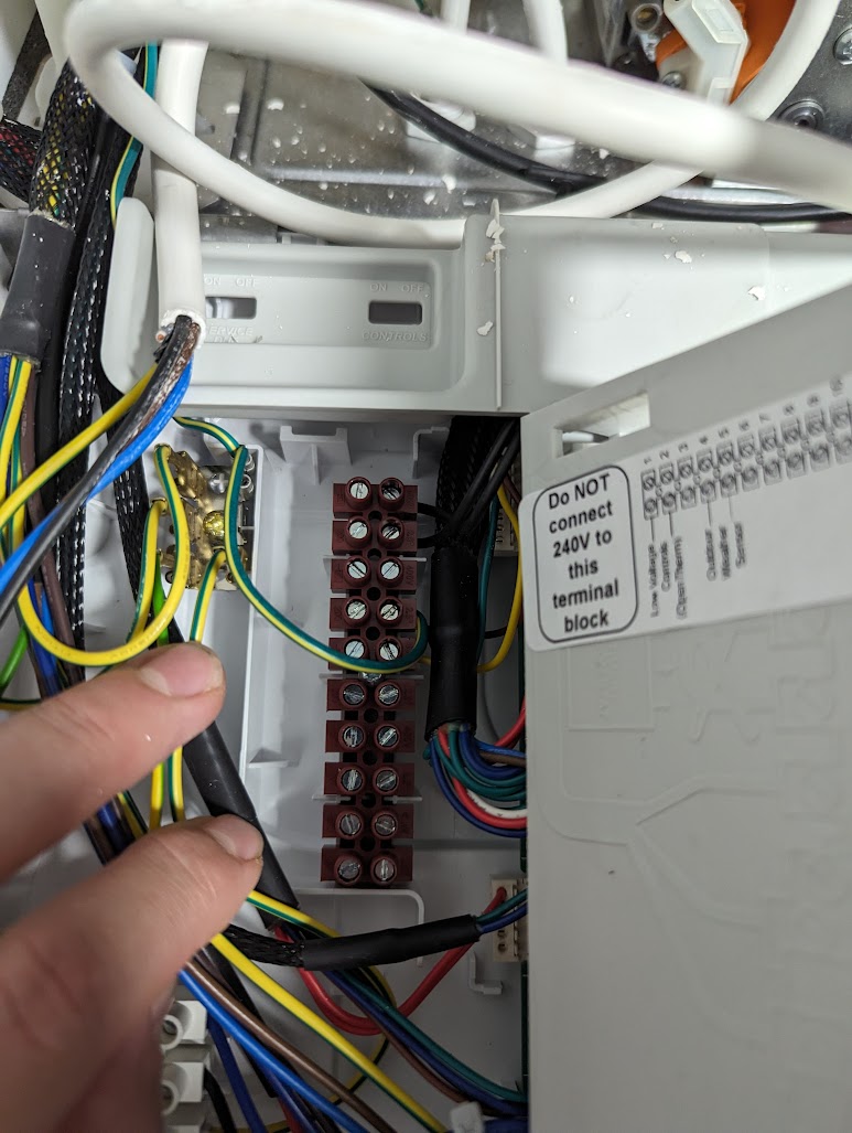

Empty connectors on boiler terminals:

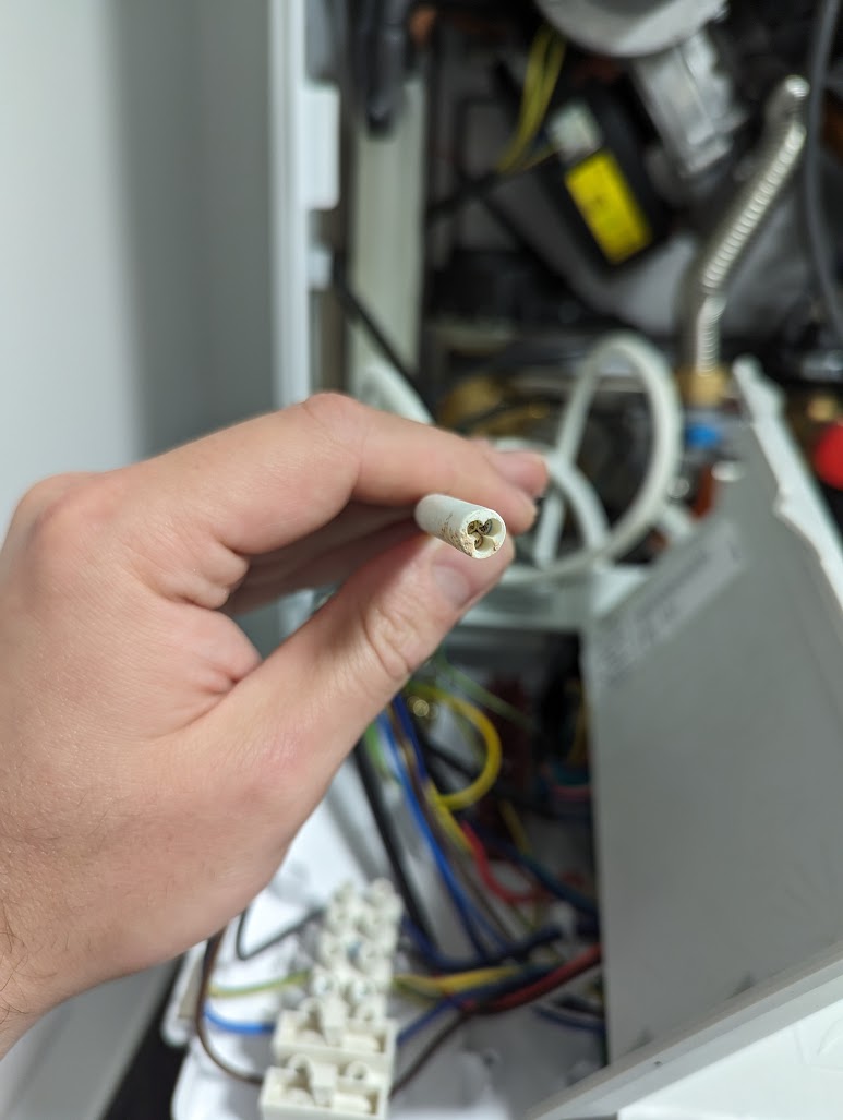

Loose 3-core flex I found inside the boiler - this appears to go back to the fused spur on the wall, where there is another loose twin and earth - currently making my own circuit diagram for all of this just to know whats going on but it must go to the weather sensor as its the only possibility - the other cables in there are to the thermostat which works and a twin and earth fed from the consumer unit for power
Its there to enable a box to be ticked.
The get out for boiler plus compliance is outdoor sensor. No-one has told the sparks about it though.
Generally outdoor sensors cause more problems than there worth.
Every boiler I have ever fitted W. C to we have had to go back and disconnect it.
Does stupid things like it's to warm outside you can't have your heating on for example.

It's there to comply with Boiler Plus regulations and should have been connected. That being said, it would likely have minimal effect with the boiler you have as its minimum output almost certainly greatly exceeds the heating requirement of your home. It's an absolute travesty that such boilers are allowed to be fitted to new builds - they will never run efficiently. Fitting Wiser to it isn't going to help and may make it worse.
