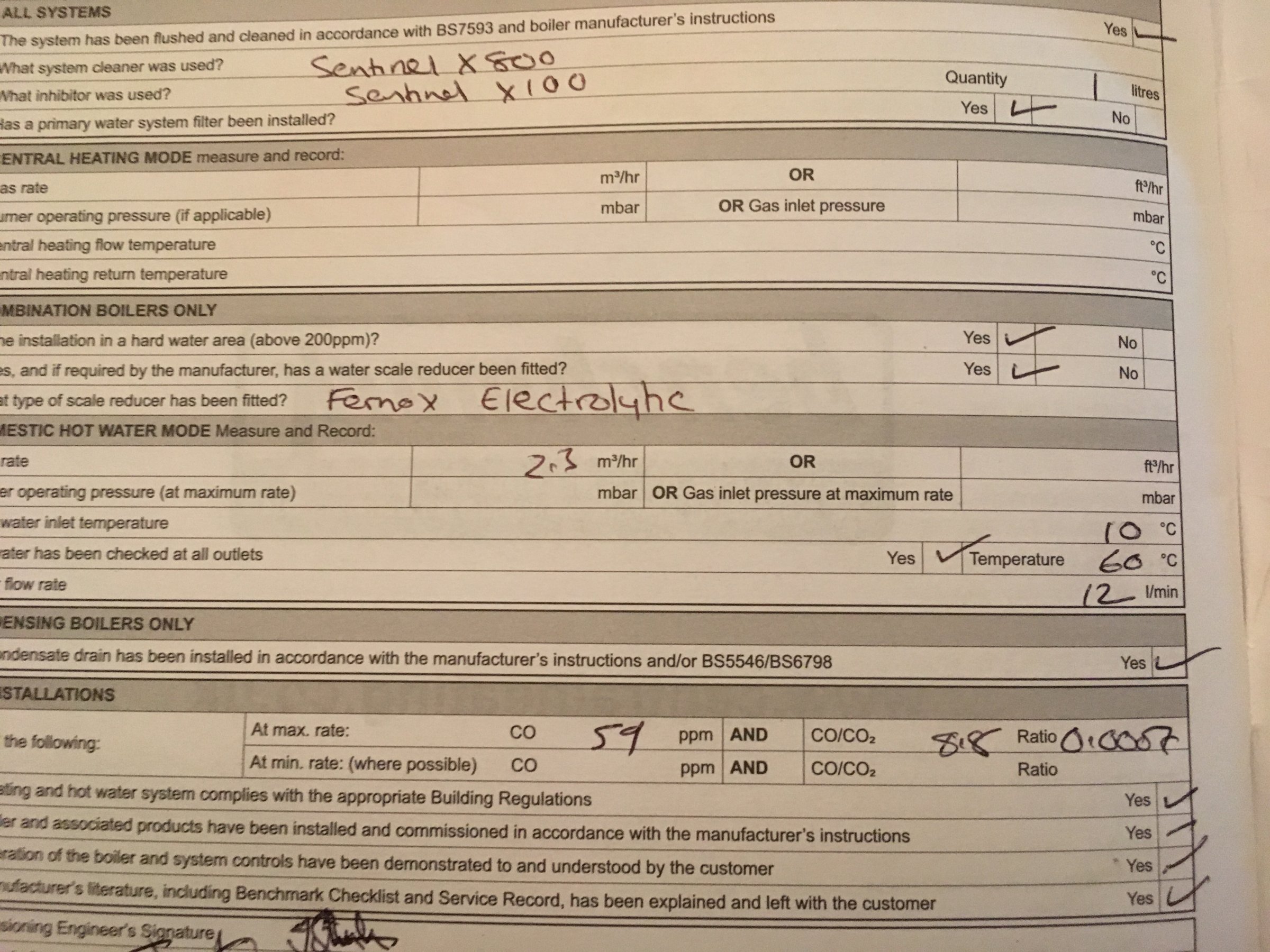

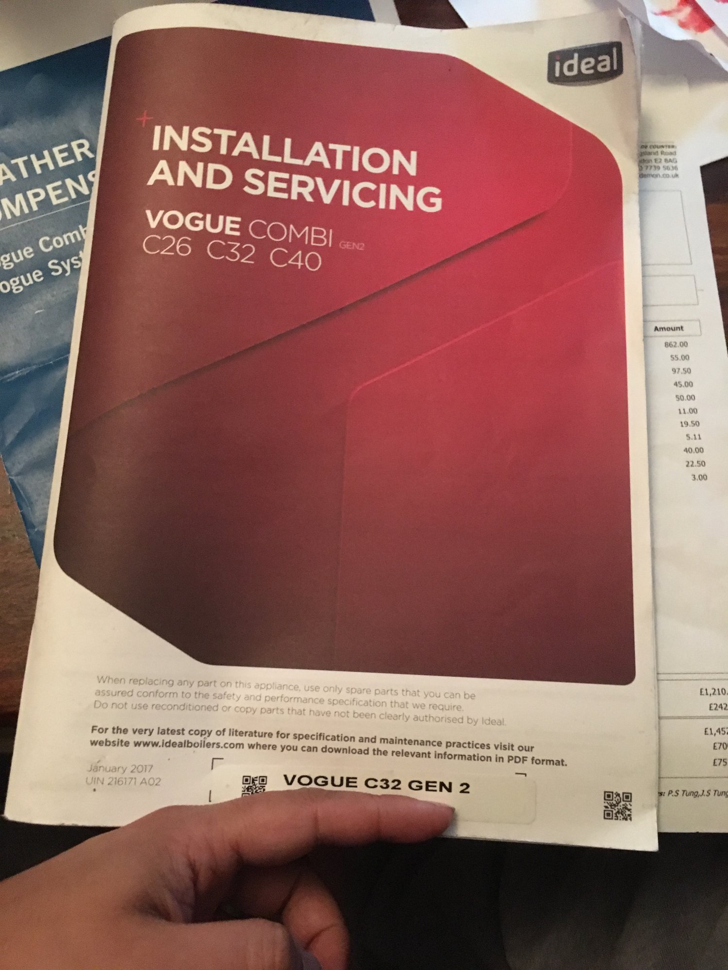

I don't have the manuals for it yet. Maybe @shambolic could email me copies? But the tests the guy carries out for the benchmark book need an analyser and measuring water flow rates.
Is it ok I screenshot ur comments and send it to him also iv done a little video..a lot of features to understand on the boiler:(
"Service mode" will enable max and min rate..

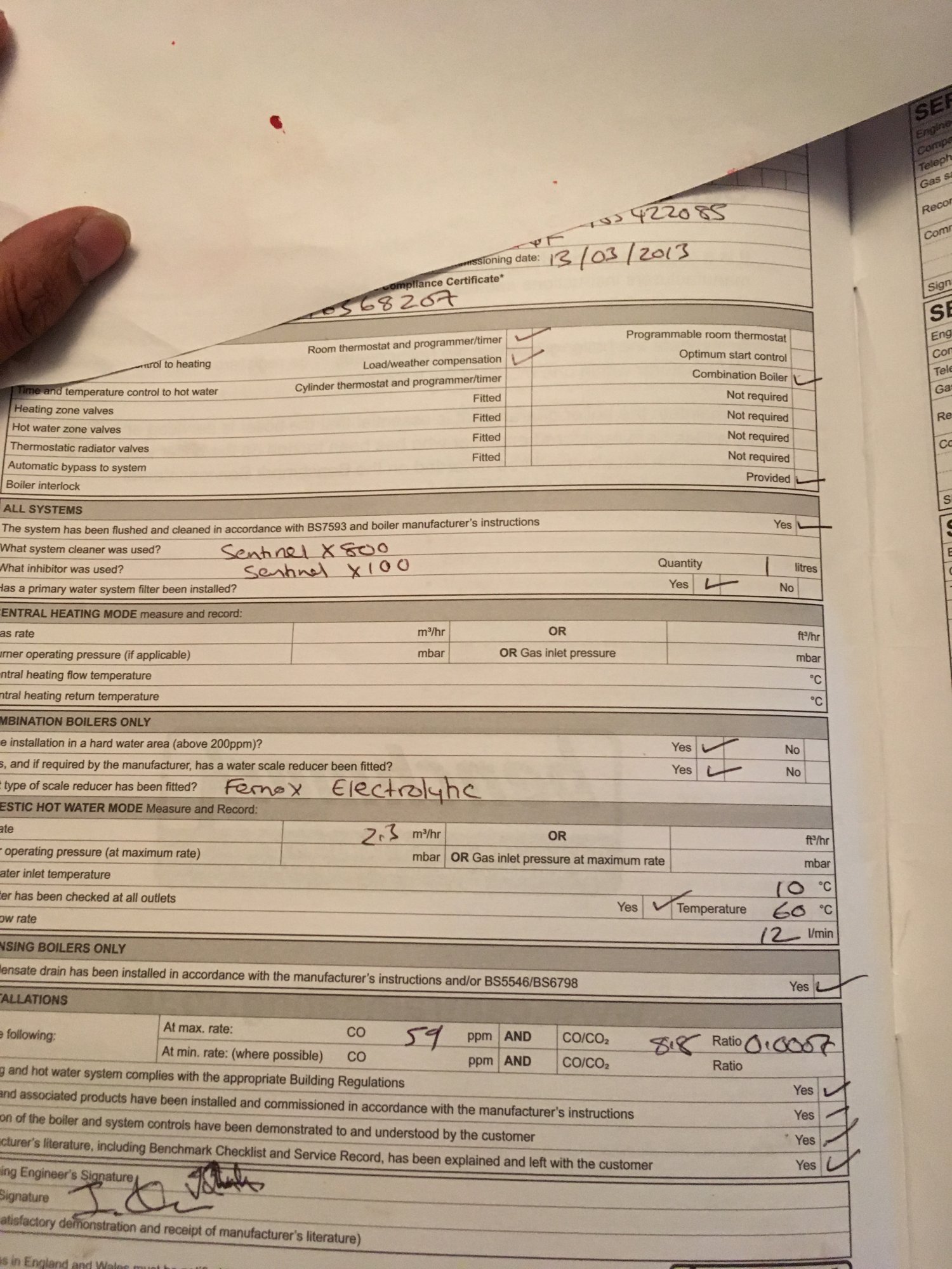

Why are you showing a benchmark dated 2013????
You haven't a completed benchmark for this boiler have you????
I can smell BS a mile off , I was gifted with a sixth sense...:)
It's obvious he made a mistake on the year bit...instead of 13/03/2017
Im sure it can happen to any plumber
Just saw this!!! Normally well over 100-200 ppm on a vogue on max rate.
Where's the low? Figures probably plucked out of thin air.
No sham , the figures are from a benchmark dated 2013 FFS..:ROFLMAO::ROFLMAO::ROFLMAO:
The ratio figure actually stacks up with the CO2/CO..
