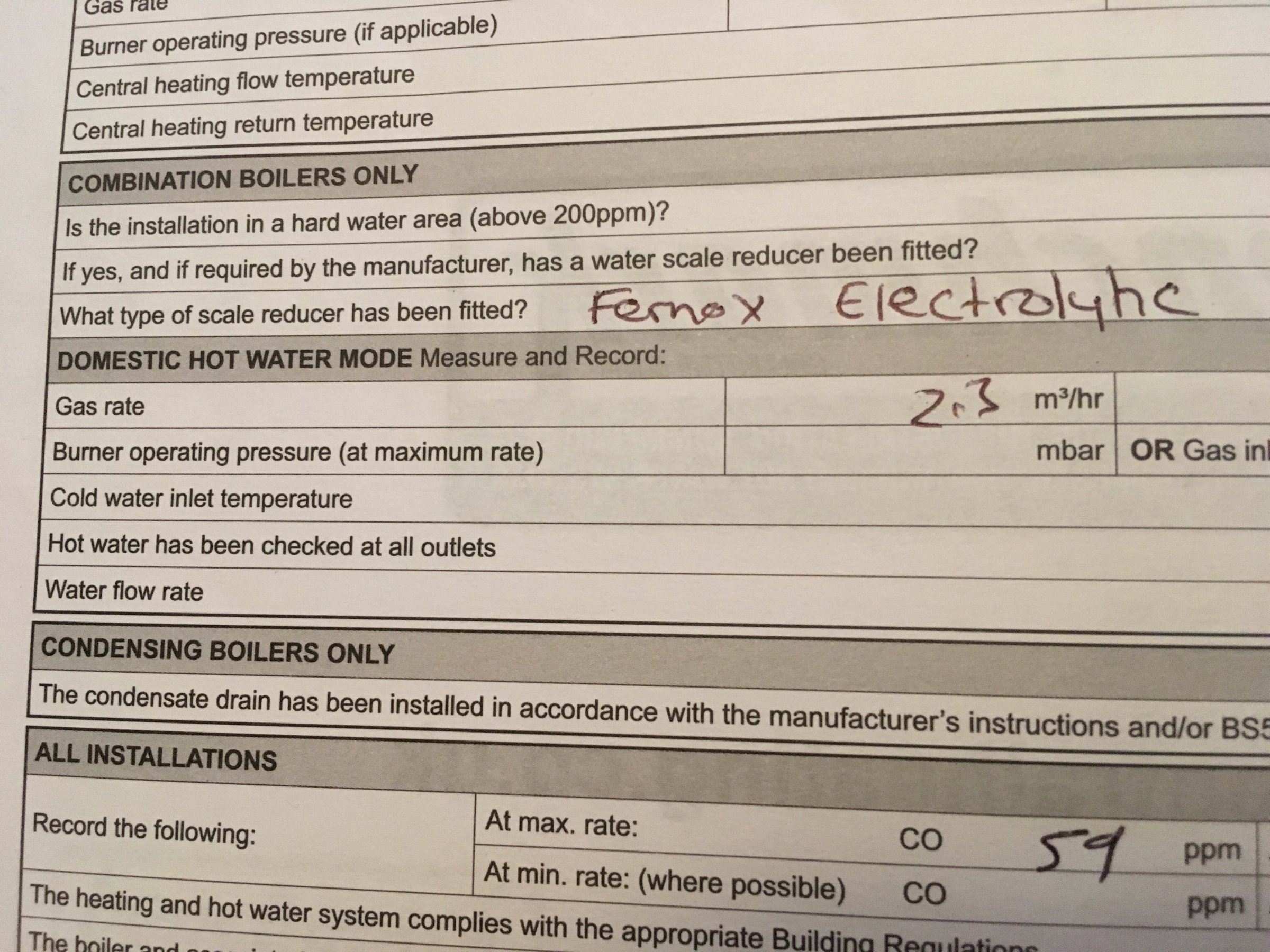

Ok whatever that meansHot water rated @ 2.3 m3/h for a vogue 32c???...
No Low rate combustion analysis recorded on benchmark???shall I go on???![]()
Thanks ... appreciate for noticing that.Benchmark dated 2013 ?
Again I skim read but assumed U just had this installed ?Thanks ... appreciate for noticing that.
This boiler was on released from the manufacturer this month.Again I skim read but assumed U just had this installed ?
HmmmmThis boiler was on released from the manufacturer this month.
Guys im getting worried now...It means he didn't have it on full rate. Could be undersized gas pipe or slow cold main, but the numbers don't add up.
