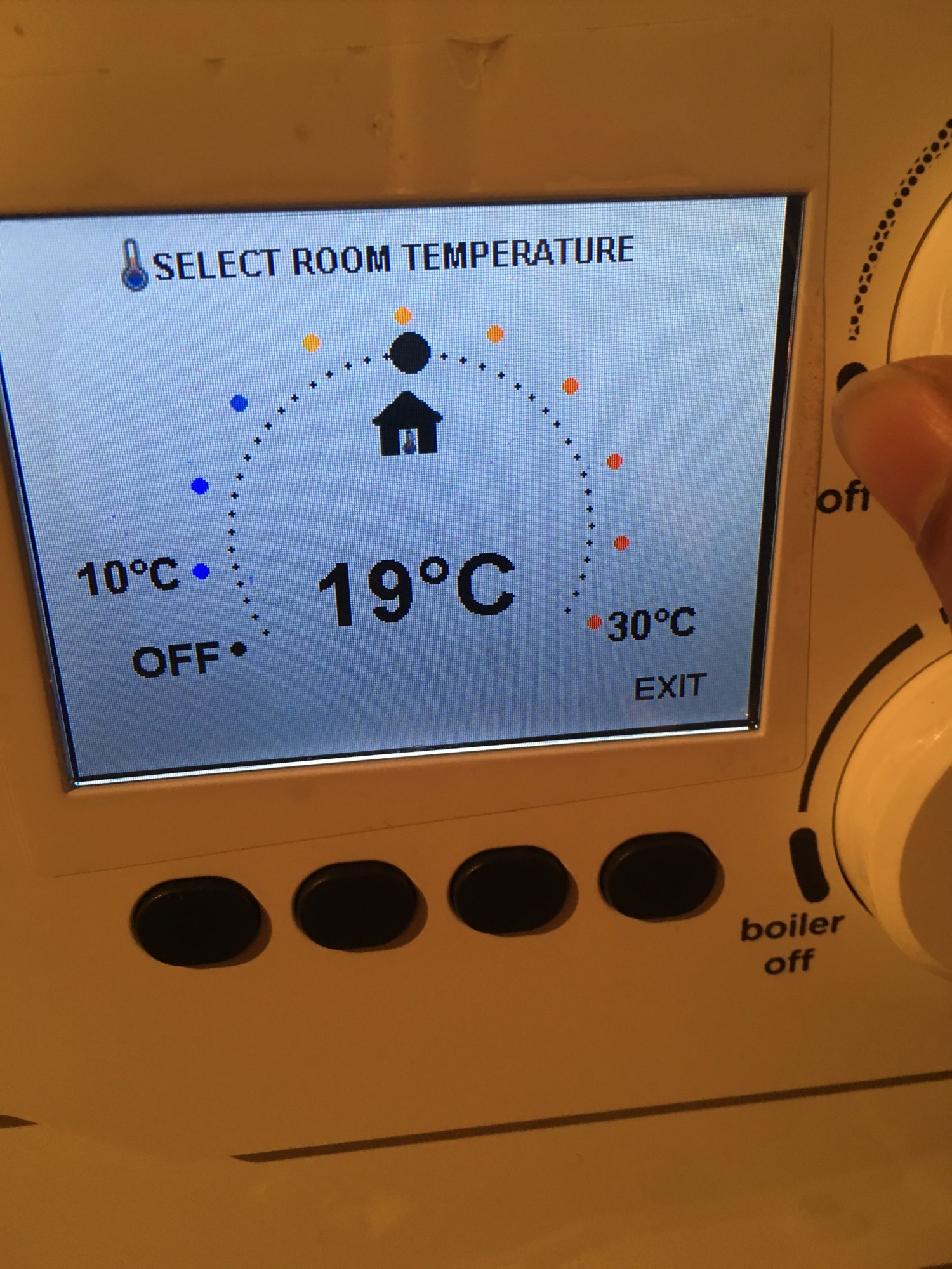

Does that mean 24h heating
Can someone explain in layman terms...
What happens to the wireless electronic boiler thermostat?

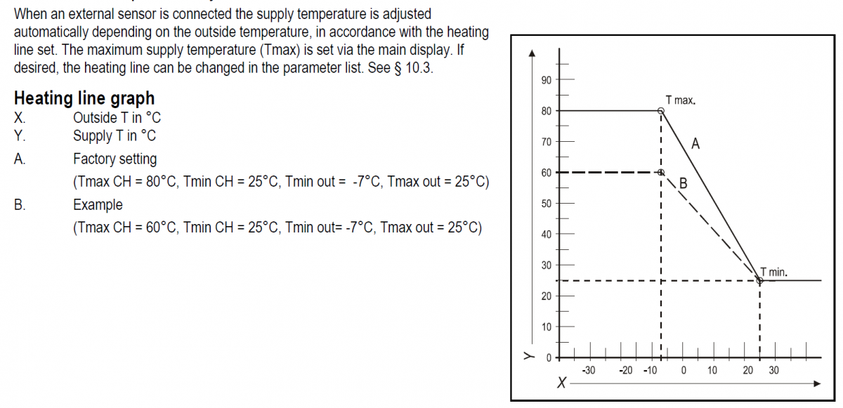

Taken from a competitor's book:
Not 24 hour heating necessarily - it depends on the settings. If my heating was to be on now, the boiler would be running at around 38 degrees. So the boiler runs more efficiently but for longer periods. The idea is you are more closely matching the heat lost from the building to the heat input from the boiler. How hot the boiler runs is more important that how long it runs for.

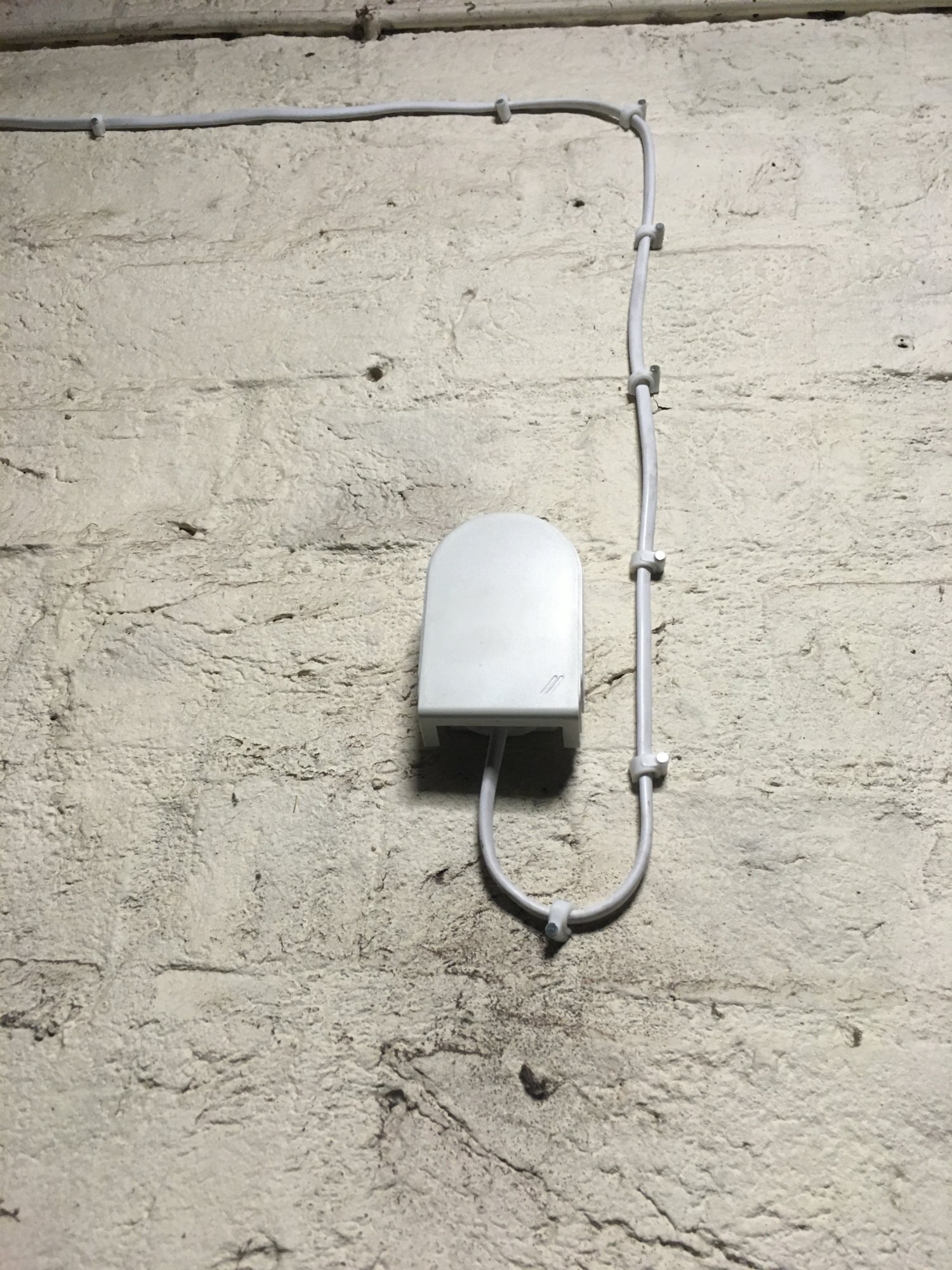

YES! He needs to run a cable to the outside. The outside temperature sensor must be on a north facing wall. 5 mins to install? mmmm

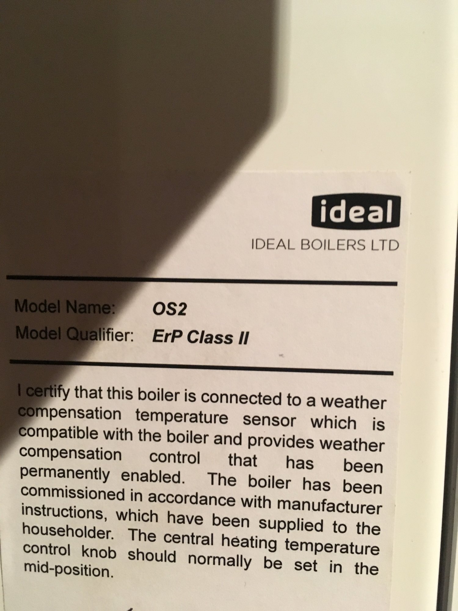

All done...took him 10 mins, 5 mins to clip the wire. Yes north facing outer wall; the boiler is also on the north facing wall(inside)
I assume he drilled a hole in the wall. The outside sensor has to be away from the flue outlet to avoid influence.
So 10 minutes to fit sensor (drill plug screw) , run cable , wire sensor , connect cable inside....
Yea right..:)
How long to set up?...oh , and how long to get tools on/off van??
