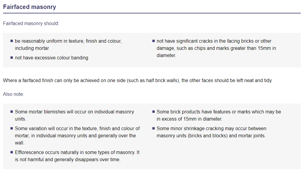

You'll need to check your Buildmark warranty to see if its covered. There are standards for appearance ..

They have not eroded. You state that the mortar is hard, so what falls out are already loose.
The open joints you mention may well be scaffold putlog holes.
I’m sorry but the brick work is rough as toast from the pictures you have sent in.
