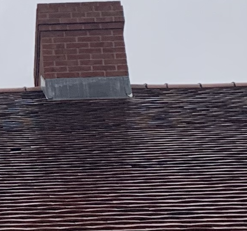

    I have been in my new build since July 2018. I have had a woeful number of snagging issues. One of which was loose roof tiles. The builders have sent someone out twice to sort them out.
    I returned home tonight to find the following in my back garden. Thank god it was the back as if it had been the front, it would have landed on my car.
    [​IMG]
    I have taken a look at the roof again and can see various not level parts. It has not been windy today. This is starting to really bother me.
    [​IMG]
    Is this normal for a new property?
    Can anyone advise me on what I need to be asking the builder to do as clearly this isn't working. It was last checked about two months ago. Can't believe I am having more issues again. The piece that has embedded into my lawn isn't even straight. It looks as though odd bits have just been shoved in to fit gaps in the roof.

    :eek:No it isn't normal for roof tiles to fall off a new house, and it is a good job the tile in the picture embedded itself in the ground instead of somebody's head :!:
    Put all the snagging items in writing to the builder and keep copies. I would send the builder a copy of the above photo emphasising the dangers of this sort of thing. If the builder is NHBC registered you can get them involved later on if necessary. If the builder used a roofing sub contractor they should be able to get them to rectify things on the roof.

    Tiles are not falling off. There are some tiles that have failed or been damaged and pieces have come down.
    Judging by the tile breakage positions and the chimney, I would guess they were cracked by ladder or foot traffic when the chimney flashing was fitted.
    Just get the contractor to take a look it will be easy enough to check for any other damages.
    These are clay plain tiles and can be fragile and will not be a perfect uniform shape
    Ref the pictures, take a few from afar, front and rear

    Thank you everyone who posted. Have just got on to them now and asked that they come and do a full inspection of the roof. It is absolutely pouring down here but no sign of any leakage in the roof so looks as though I am ok.

    As in plural, the tiles are not falling off...singular! a fragment of tile has has fallen off for the reasons already explained.
    A quick once over and repair should suffice.

    Just to confirm, pic of the tile is not zoomed. Yes grass is long as it keeps dying. Builders told me to let it grow long, but it is still going brown and dying!
    I dug a few holes and there is no top soil, just thick clay.
    Picture of roof is zoomed to help see where the bit embedded in the lawn came from!
