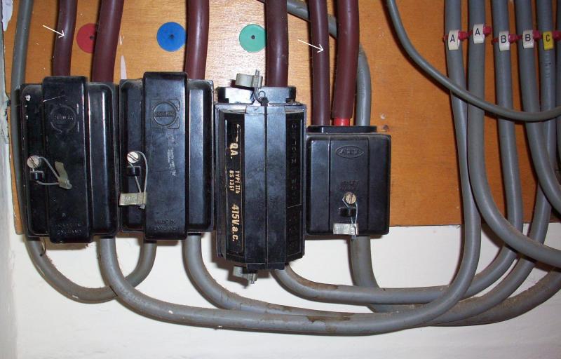

Albeit a bit different from what is presumably being discussed here, since mine is an overhead supply in singles, do the cables marked with arrows here constitute what you call a 'top side loop'? They supply an adjacent property, which was once part of my house, which I presume is the reason it was done like this (to save an additional new long run to the pole when the other bit of the property became a separate dwelling).
Kind Regards, John
Can't tell from the pic John, a top side is where the loop is controlled by the fuse so will be on the same side as the meter.
There is a huge issue with these as if that fuse blows and there is no one in, the other customer is without supply until access can be gained
Can't tell from the pic John, a top side is where the loop is controlled by the fuse so will be on the same side as the meter. There is a huge issue with these as if that fuse blows and there is no one in, the other customer is without supply until access can be gained
Ah, I see! No, that's not the situation here, because my fuses are 'upside down' to what generally happens with an underground supply. In other words, as you should be able to see, the 'top' of my fuses is where the DNO supply arrives - so the supply to the adjacent property comes off before my cutout fuse. As you can see, my meter (just off top right of piccie) is supplied from the 'bottom' of the fuses.
So, although in literal terms I have a 'top side loop', it's probably a 'bottom side loop' in your language :-)
Kind Regards, John.
