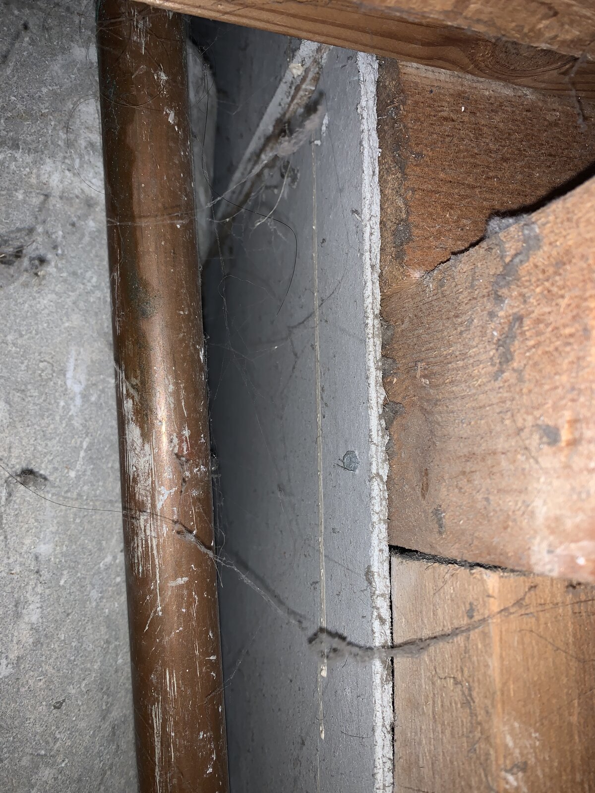

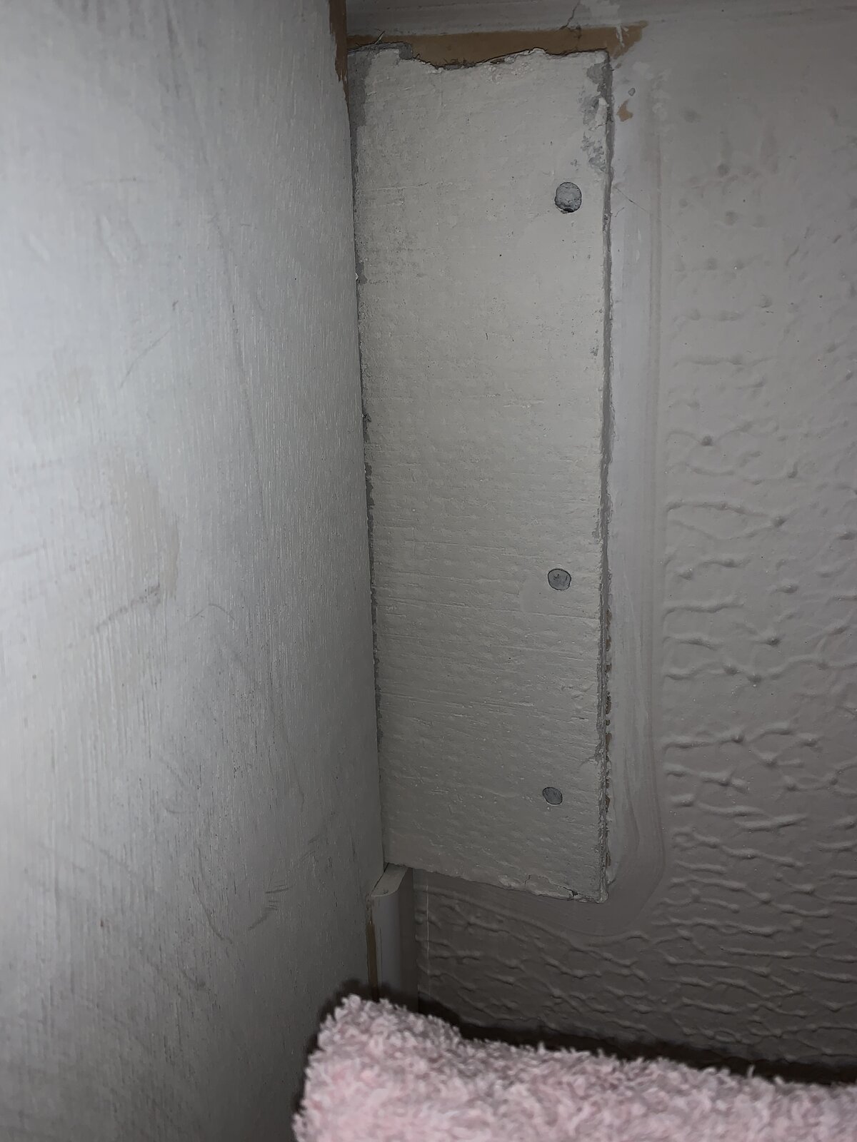

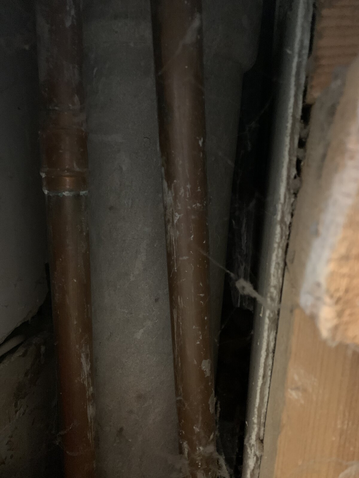

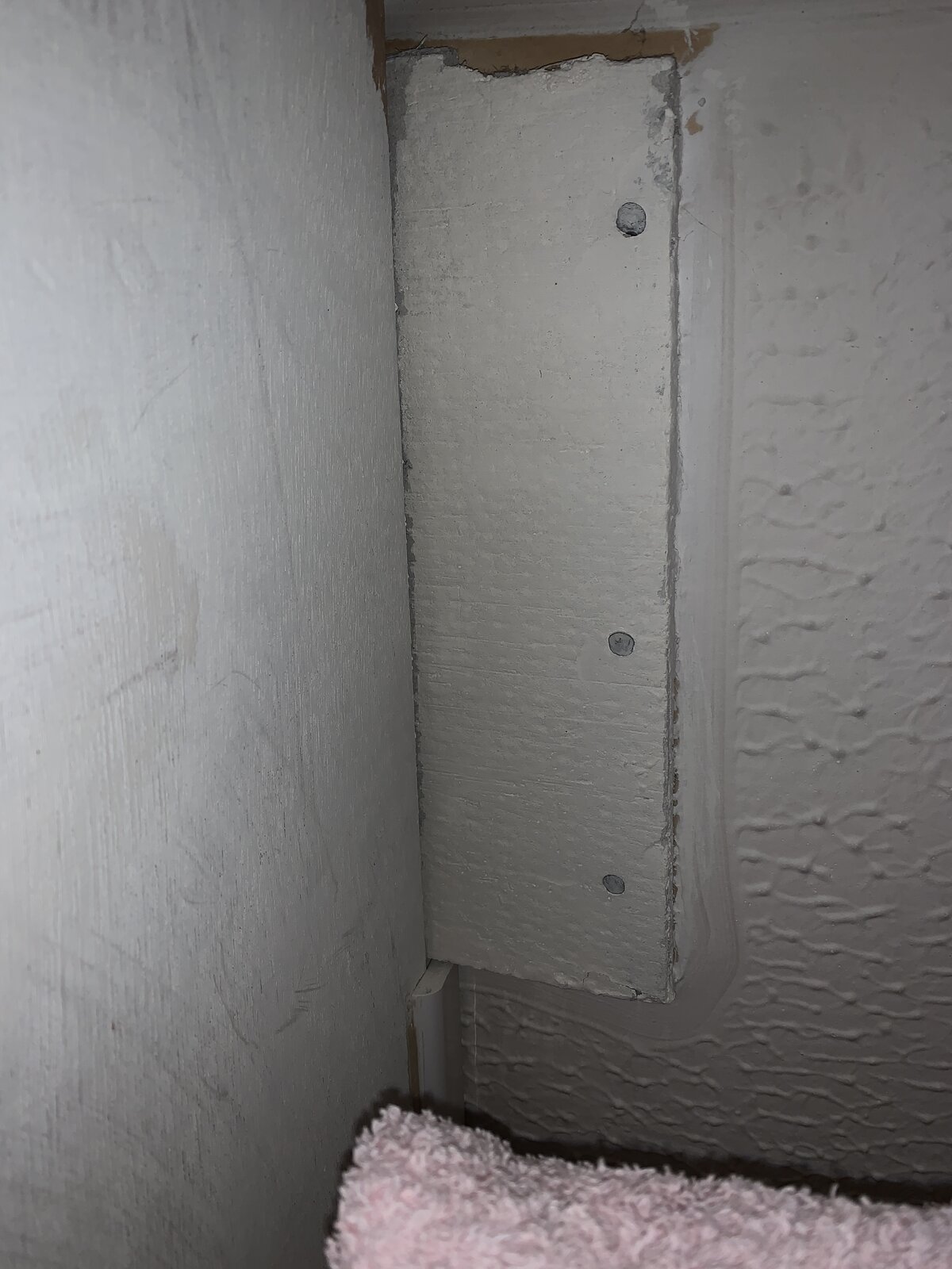

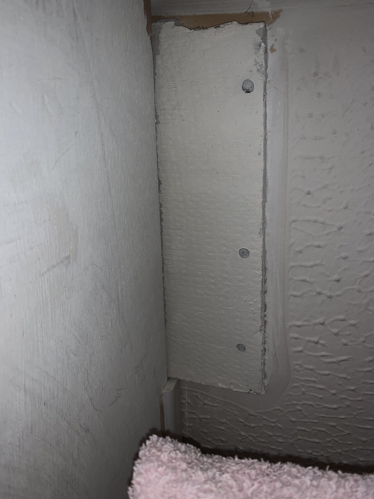

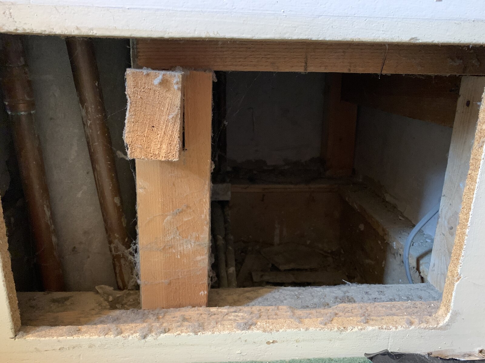

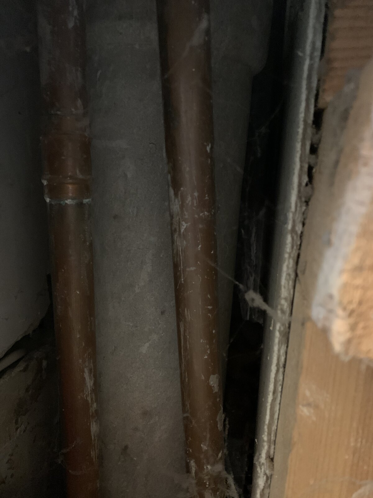

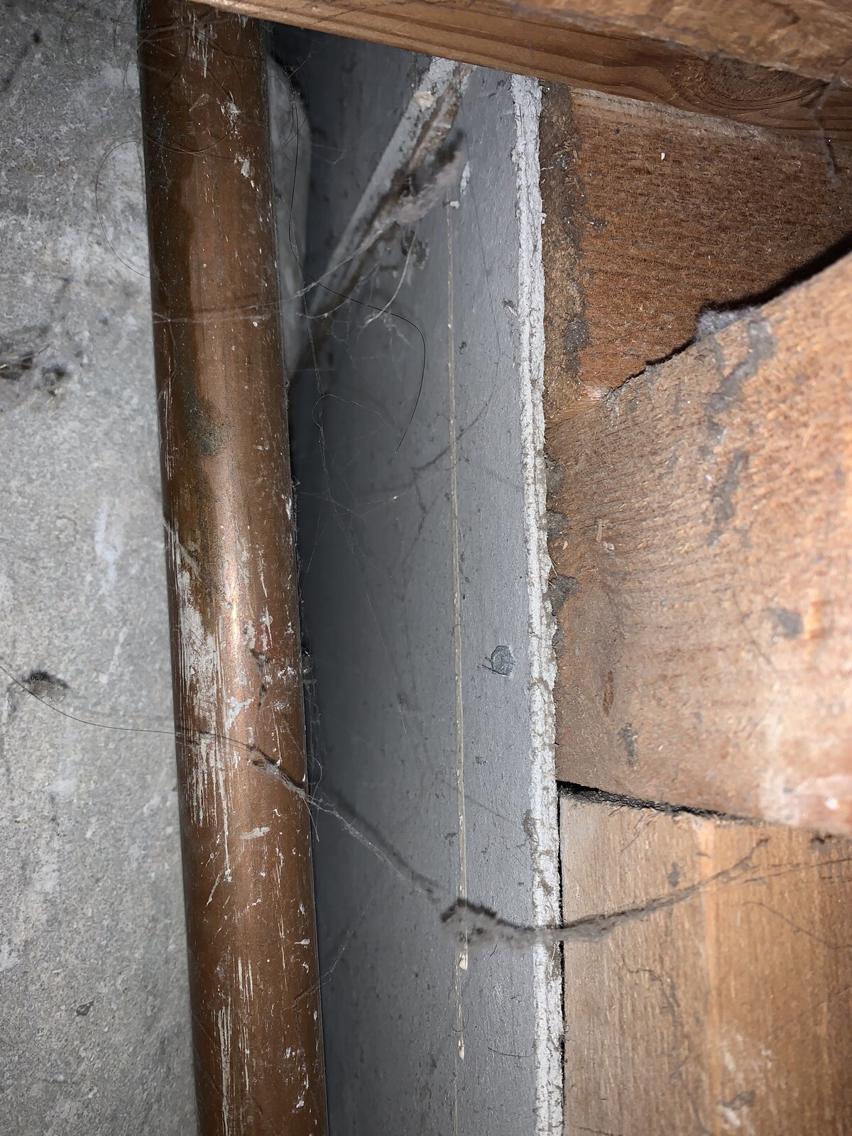

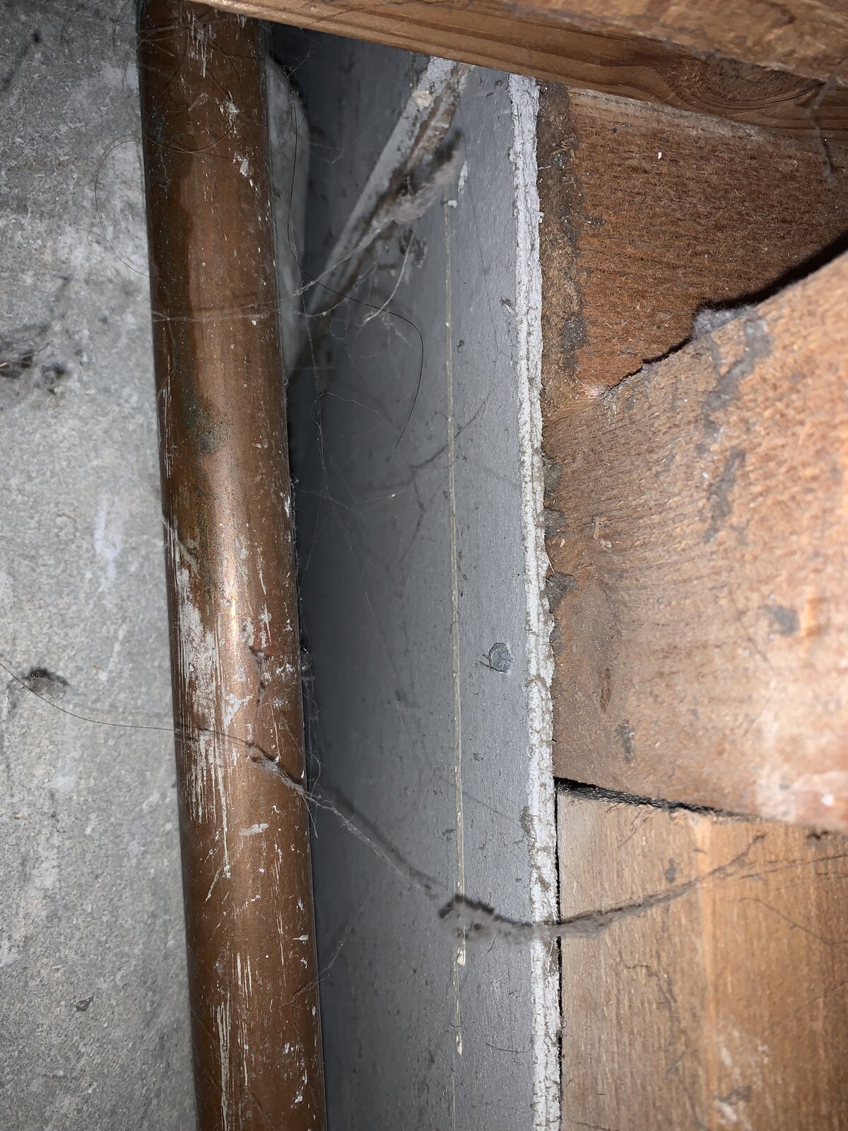

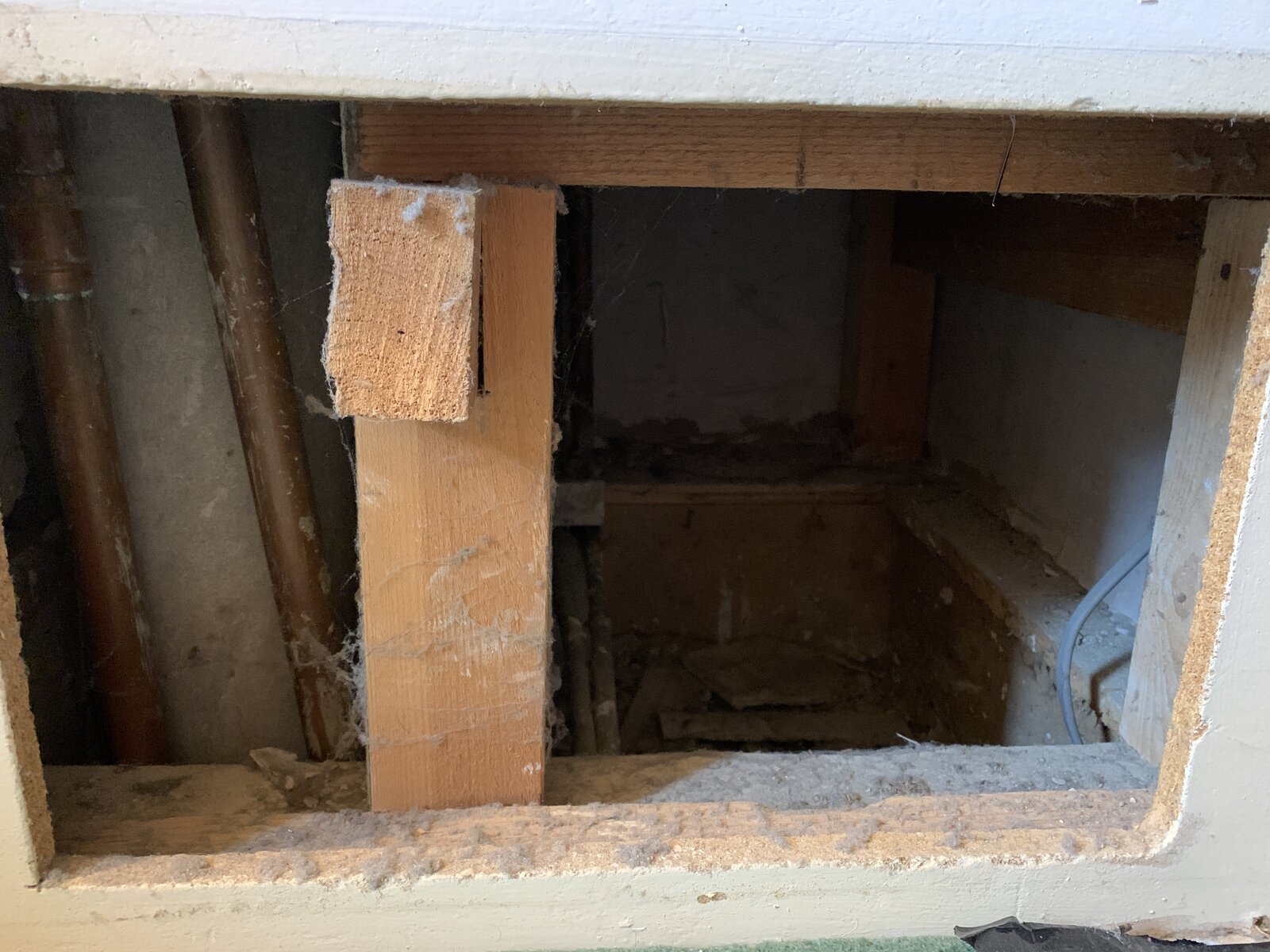

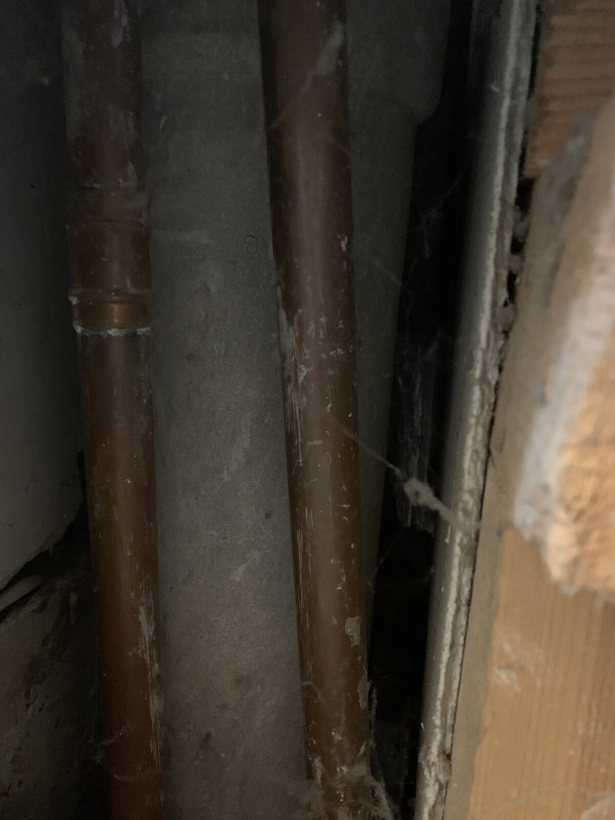

We have a heating company about to replace warm air heating system with a combi boiler and radiators. They have said they they will completely remove the old flu which runs from the warm air boiler downstairs, through the floor to upstairs, up the inside of the airing cupboard on the landing and on up in to loft. We have removed a panel underneath the airing cupboard and we can see what we think might be asbestos. I have attached some pictures and would be really grateful if you could tell me if you think this is asbestos sheets. The heating engineers do not seem bothered but we wondered if it is safe to disturb this or whether we need specialists to look at it. We are worried that they will just pull the old boiler out and send asbestos fibres all over the house.
Pic A is the space underneath the airing cupboard with the heating flu running up the left had side. Pics B and C are what I think might be asbestos protecting the wooden boxing that hides the flu inside the airing cupboard. Pic D is the ceiling of the airing cupboard. The top left side of the has a board where the flu passes through to the loft. This has been painted but again might be asbestos?

It does look like the flue might be asbestos, but no definitive way to tell just by looking at it Im afraid, you would have to get it tested

I think the flu is asbestos cement and can be removed.
I am worried about he panels at the edge of the flu that are screwed on to the wood
It was common practice when installing WAU in those days to line the cupboards with asbestos sheeting, but again only testing a sample is definative Im afraid

From the photos, the boards look very suspicious.
They also look like insulating board, which is very nasty stuff, health - wise.
A full set - up from a licensed contractor, plus follow - up testing to confirm fit for reoccupancy.
Hence the apparently high quote.
(All of the above are opinions based on the photos ; I would only stand behind the above if I laid eyes on it in person).
Get a specialist in to test, and give their opinion based on what they actually see the situation to be.
It all depends on how confident you are with it. If you can use PPE properly (mask/gloves/suit) and are happy to take a sample properly then you can order a sample kit and have it tested yourself for not a great expense.
Any company must be licensed to remove asbestos and ensure it is disposed of at a properly licensed site, you need to ask for that before allowing them to proceed with it's removal. You can DIY remove asbestos but there are specific rules and regs you need to follow.
