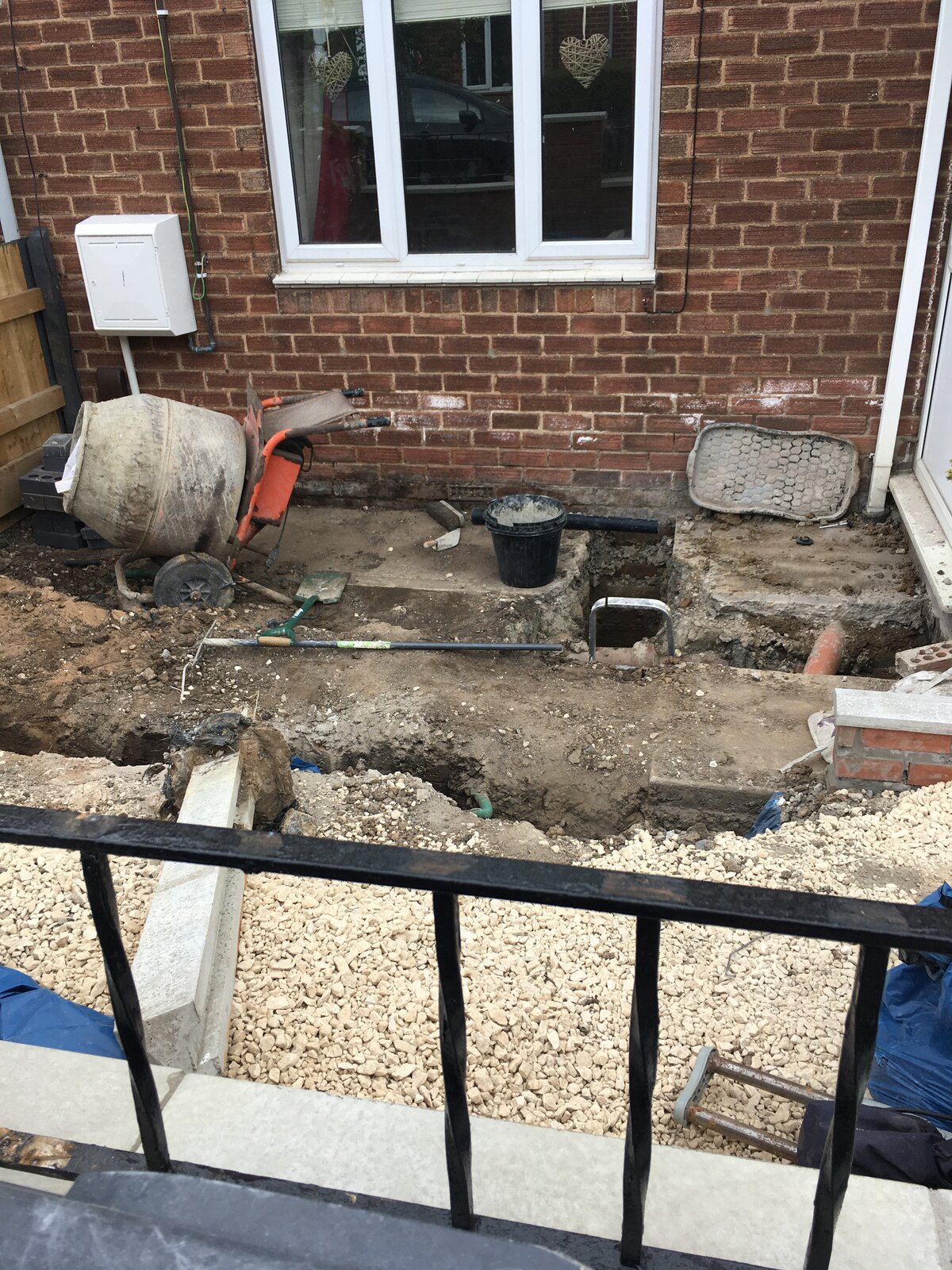

Hi ,
I’ve just dig
My
Foundations to
The new porch but the original porch had no Electricity in it.
What would The best way to get electrics to the porch
Please. The socket that’s in the living room is the last socket
On the ring main can I take a feed from that upto a mother rcd to the porch then run a socket , internal
Light and the small external light from That( it’s not a 1000w light)

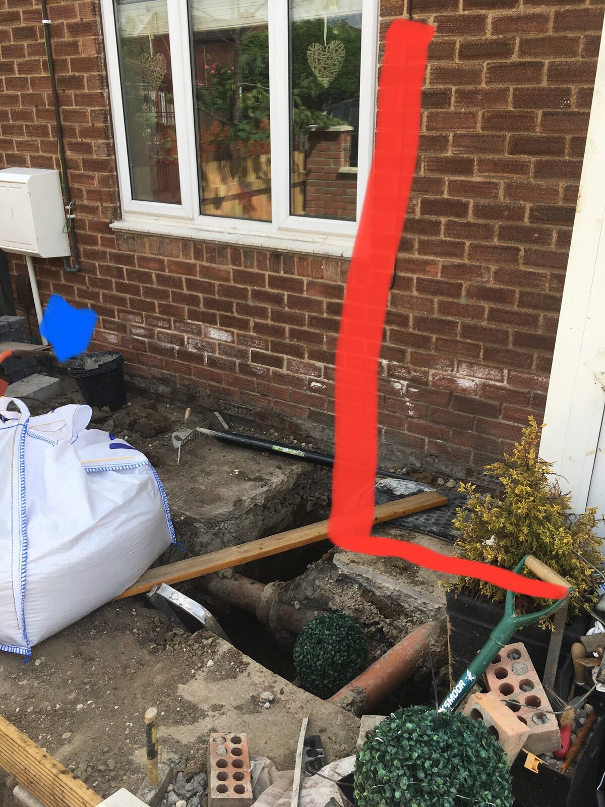

Hi thanks for your reply and questions.
The socket in the living room I think is on a 16A trip
I was hoping to come off the livong
Room socket with a piece of 2.5 2 core plus earth through the wall going through conduit through the wall and cavity and into a junction box like attached the the armoured cable upto the rcd / mcb .
The light we have is a 2 metre aluminium
Lamppost with a single 60w bulb
The blue on the pic is where my internal
Socket is located,
The red line is where the brick porch is going to come up to
Many thanks

Re the armoured cable I was thinking of burying it under my foundations then up through the cavity of the new walls
