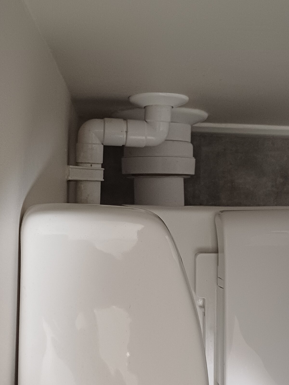

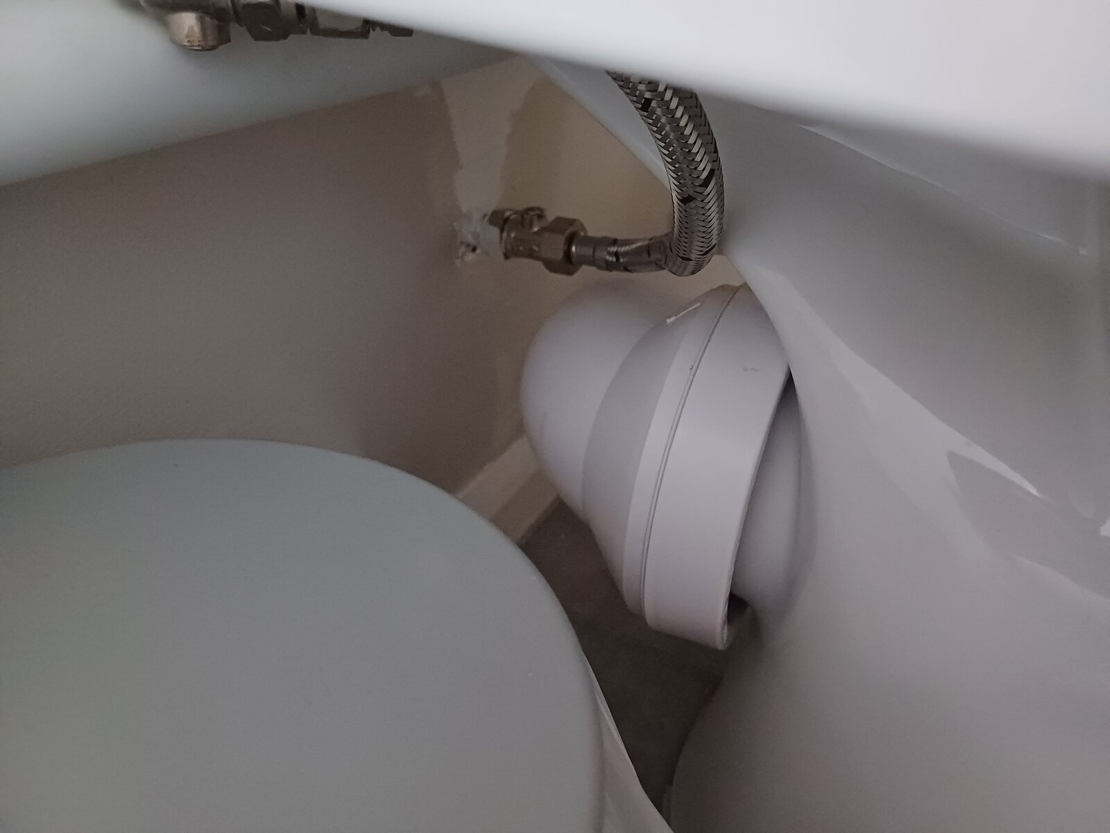

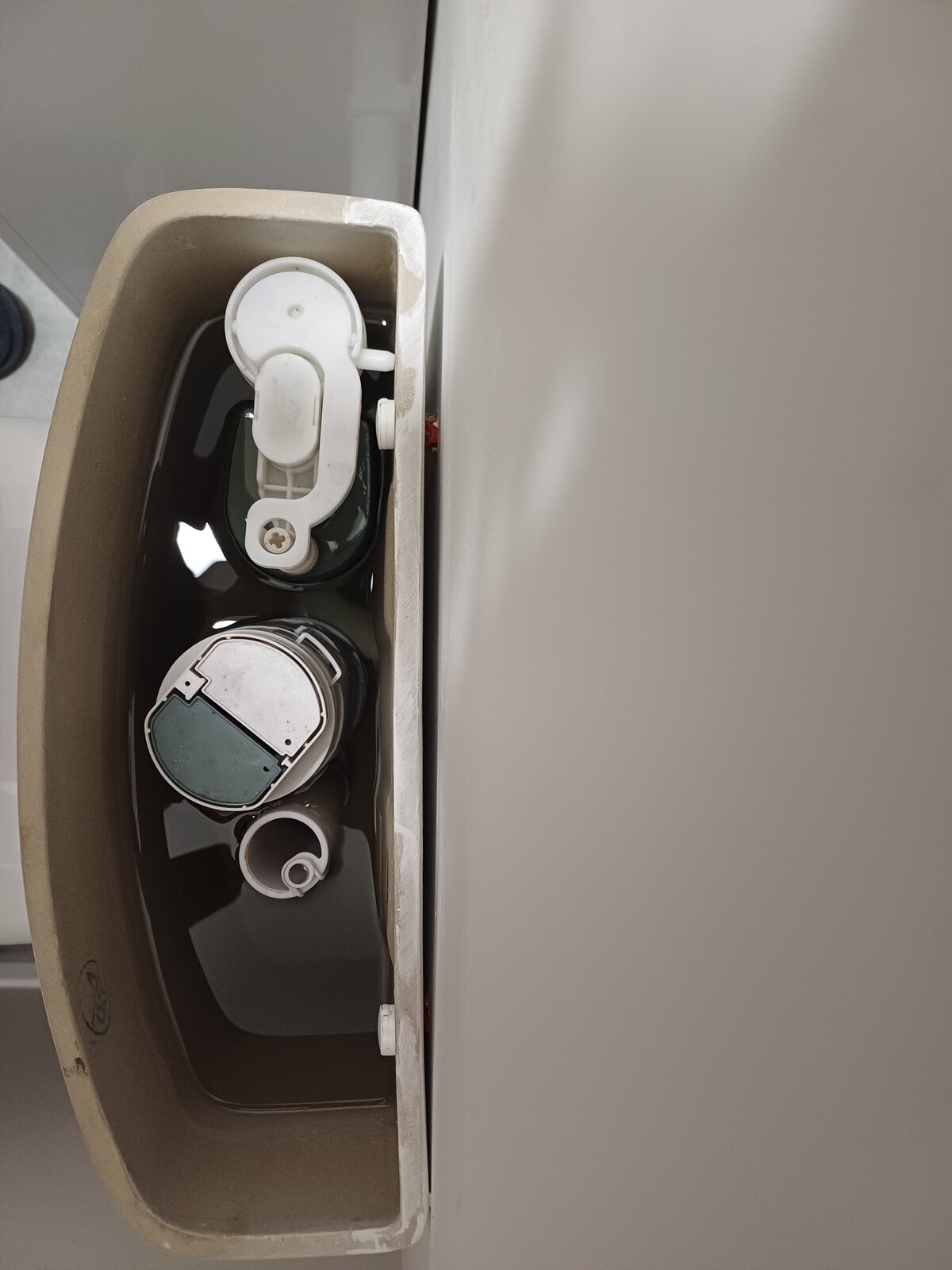

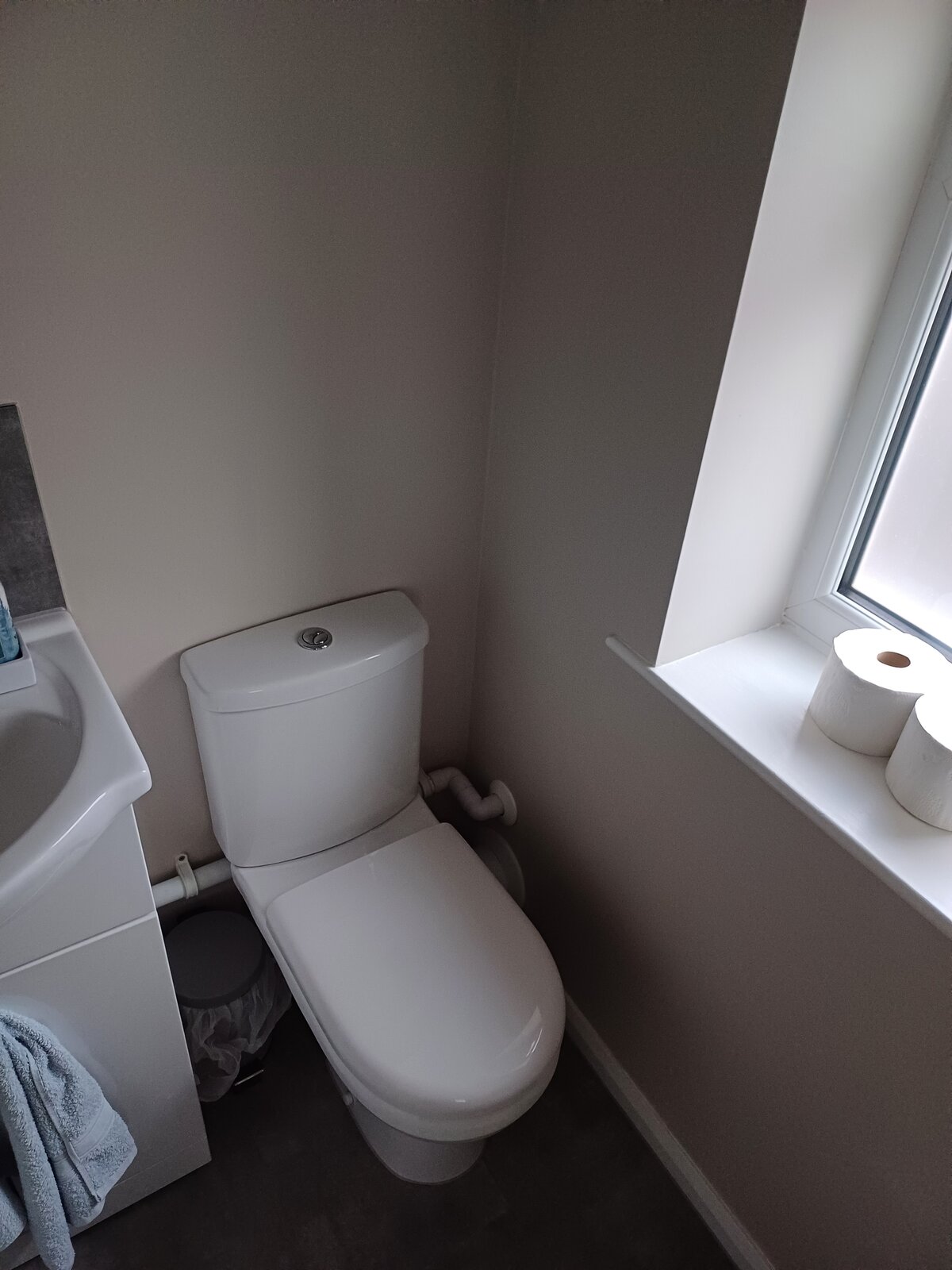

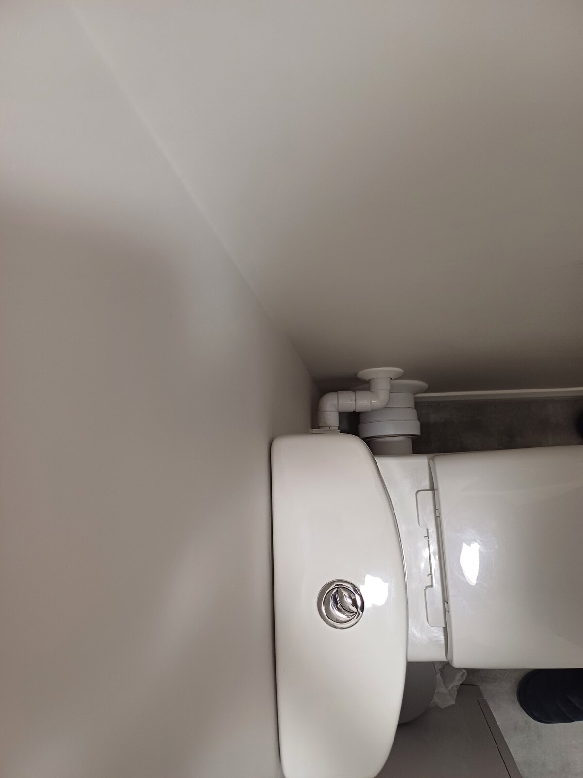

Hello,
I had a new ensuite installed in a bedroom approaching two years ago. Just a toilet and sink. I paid a plumber to do the whole job. Toilet and sink wastes go through the outside cavity wall and into the soil pipe serving the adjoining bathroom (old cast iron soil pipe was replaced at the time with slip on plastic one). The house is a bungalow.
The toilet is connected to the waste using a 'question mark' type connector which achieves the right angle needed, and then does another right turn when it leaves the external wall into the waste pipe. Flexi type pipe is used through the wall. (See photos). Basically, the plumber ended up in a tight spot because of the way the toilet goes back to the wall and where the soil pipe is outside.
I reported to the plumber who did the work that the toilet wasn't flushing all that well within days of the job being finished. It clears 99.9% but always has this issue with a back wash of very small bits of ****. Several flushes usually clear it. Sort of. Weirdly, the bits can randomly appear after several days when you flush as though they are trapped around the waste connector. The flush isn't really abnormal but doesn't appear to be all that well designed and maybe the question mark connector reduces the efficiency of flow. There is no problem at all with the outside drains and, as I say, main load is flushed away.
Anyway, there was a back and forth with the plumber on WhatsApp and over the phone that went on for a long time. And I mean like it ended up being 18 months. He basically said his plumbing was fine, the fault was with the toilet, which was my fault because I chose it (even though all materials and labour were supplied by him and I simply chose one of the two he presented to me from his supplier). I disputed this.
Trouble is, it isn't clear whether it is the toilet or something else. Maybe the question mark connector? Maybe the flexi pipe? We could just replace the toilet with like for like (not many options available to fit the space), but since it doesn't appear to be damaged, this could be several hours work to achieve the same outcome and then I'd have an extra toilet I don't need.
After a tediously long time, we agreed that we would cover off all bases: replace the toilet, replace the connector with a proper right angle one, and replace flexi pipe. I agreed to pay for the materials for the sake of getting him to agree to do the replacement. The plan was to use a cabinet type toilet so we could bring the pan more off the back wall, create room for right angle connector and make it to the existing hole through the wall - all without losing too much space in what is a small room.
I sourced the new stuff, measured as required. Went back to him to agree fitting date and only got silence then, despite attempts to call and message. Complete waste of my time. A couple of months later, I changed the two 5 star reviews I'd given at the start to 2 star ones and explained why in my reviews. He suddenly got in contact and was complaining about my reviews... But didn't agree to fix his work, just went back to saying the same things from way back at the beginning. I wonder whether there is something about the job that he knows cannot be fixed?
I have since got a quote from another plumber to do the fix. He would want £250 and I will spent £300 on the new toilet, etc. I have also today noticed that the sink waste seems to be going uphill into the soil pipe outside so looks like that wasn't done properly as well. No doubt stagnant water sitting permanently in the pipe.
Questions:
- would you agree with my proposed way of replacing the toilet and connecting parts as the best means to addressing the toilet problem?
- is it worth making adjustments to the soil pipe, adding a boss maybe, so the sink waste pipe falls properly?
- bearing in mind that I gave ample opportunities to the original plumber to correct his work and must now pay out a further £550, plus whatever is needed to get a proper pipe run to work through the wall (he may have done this all wrong) and sink waste pipe... soil pipe amendments... maybe closer to £850... should I take this to a small claims court to reclaim my costs?
Thoughts welcomed and appreciated.

replace flexi pipe.
Do you mean replace it with a new one, or replace it with something else? It’s not clear to me why the flexi is there at all.
I’d say that the “bits” you are seeing are due to the nature of the flexi.
It’s not a long run and should be possible to do reliably. Maybe it needs a bit more drop - which would probably mean modifying the hole through the wall.
No need to replace the loo IMO.

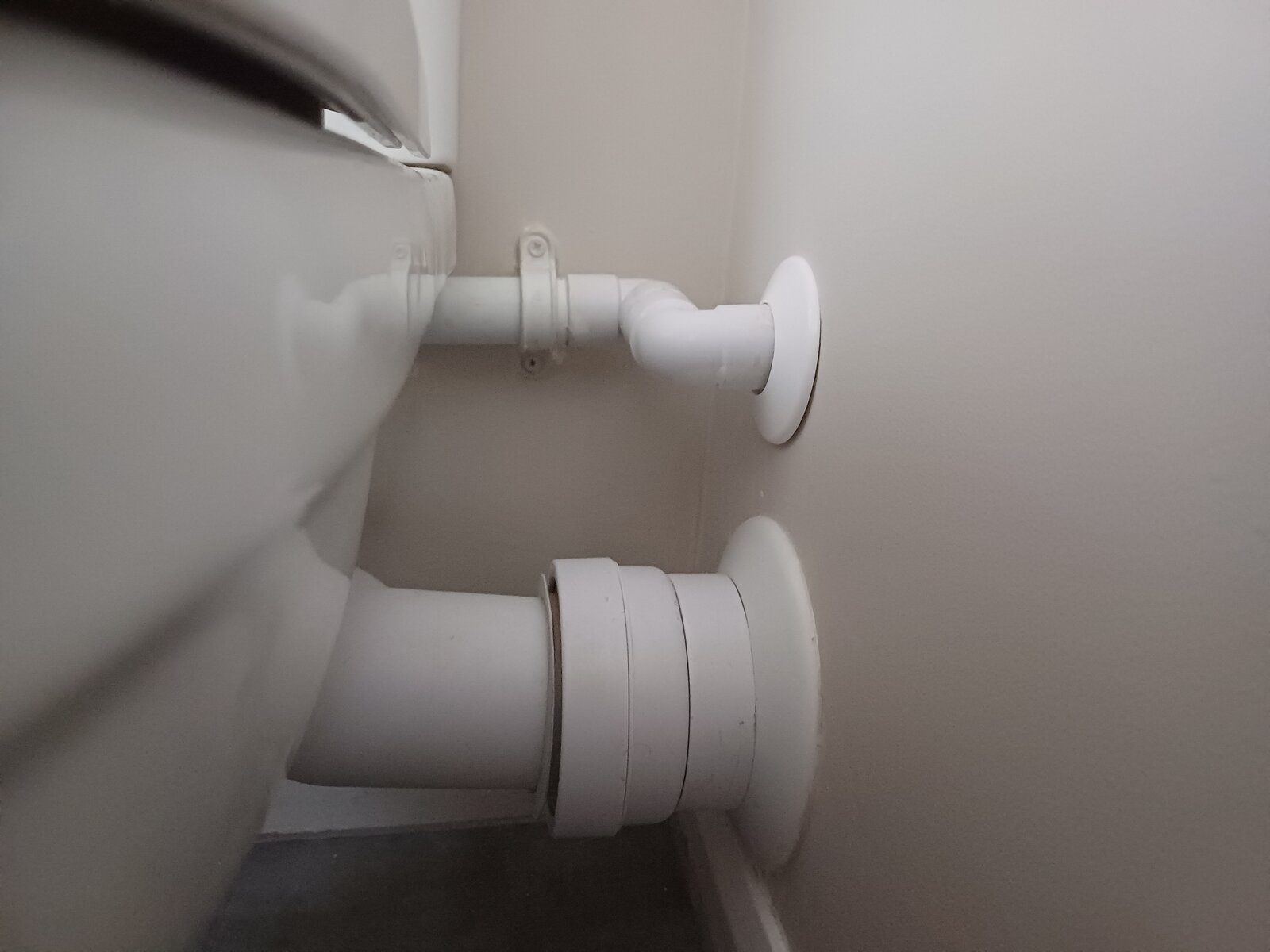

I was thinking to replace the flexi pipe with solid. The second plumber who has looked at it told me that flexi pipe isn't supposed to be used through a wall. I assume the original plumber used it because he was struggling to make the toilet waste pipe connector line up with where the outside waste pipe is through the thick cavity wall, and it gave him some flexibility? A solid pipe would want to be very straight.
The second plumber reckons that the flexi stuff isn't the issue given where it is, although he could be wrong.
My assumption is that the main culprits are the question mark connector, which makes flush flow less efficient; the flexi pipe which traps bits in the grooves; and possibly the flush design which seems to dump a lot of water from the a big hole at the back of the pan and much less around the smaller jets at the front. As the flush water doesn't move through efficiently enough, trapped bits in the flexi are liberated and then pulled back as some of the flush water falls back into the loo at the end of the flush.
Keeping the toilet will mean keeping the question mark connector owing to the way the toilet goes to the back wall. So this will mean assuming the flexi pipe is the main culprit.
Might be worth mentioning that I recently tried pouring an entire bucket of water (probably 20L) of water into the loo to test if the flush was the problem. The pan was completely clear when I did this. I poured it heavily and then also aimed more towards the front. Weirdly, more bits than ever came back in to the water at the bottom of the pan. This did suggest the toilet flush isn't the problem, as you say. I wondered if there are bits trapped around where the toilet goes into the waste connector. But maybe it is the flexi stuff. Combined with water not flowing through fast enough.
The whole soil pipe setup looks a bit like it's been done with what the Plumber had to hand, rather than what was best. The Flexi should never have been used through the wall, it should be rigid 110mm pipe up to the Pan Connector. Secondly, the Boss Pipe governs the height at which the waste can connect, given the socket immediately underneath it. Had a straight section of pipe been used, a Strap Boss could have been fitted slightly lower down, to suit height of waste pipe rather than forcing the waste to fit as it appears to be in the photo.
In a situation where room is at a premium, there is the option to twist the junction 45°, then used a 45° bend within the wall, to gain a little wriggle room and bring the soil pipe in slightly further back. Worst case scenario would be to bring the soil through the wall and make a connection to the existing drain underground, if a suitable connection cannot be made to the soil pipe.
I suspect waste is collecting in the ridges of the flexi pan connector, and this is what is making a reappearance on occasions. Nothing wrong with your pan, it's the soil pipe which is the issue, it's fundamentally wrong and a very poor installation, needs redoing with adequate fall on the pipe.
Be prepared though for this to be a bigger job than you may think, I suspect alterations will need to be made to the external pipework to accommodate the required fall from the pan to the stack.

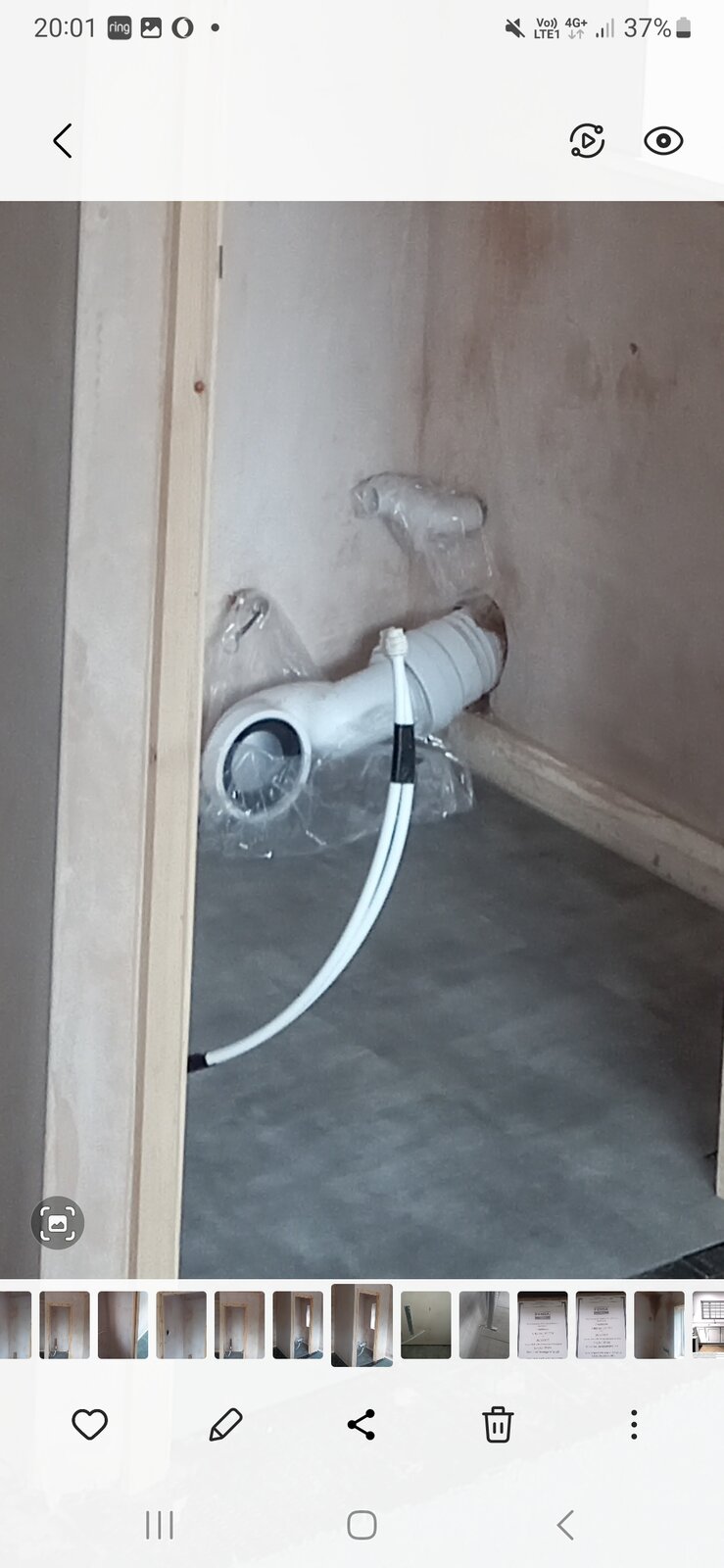

I've just noticed this, which probably explains his use of flexi pipe through the wall. The end of the connector is at a slight angle as it approaches the wall...
This might be addressed by turning the toilet slightly so that the right hand side will be a little bit more off the back wall. This would straighten up the connector as it approaches the wall and could then facilitate replacing the flexi with solid through the wall?
Interestingly, if you see the third photo, it looks like he has the toilet off the wall at the left hand side which might add to the problem.
What kind of solid pipe would I use to replace the flexi? Is there some kind of seal it connects to into the soil pipe?

Try flushing it with a bucket. Flexi shouldn’t be through the wall and is a bodge imo. Should be rigid soil pipe. Bits could be from the flexi.

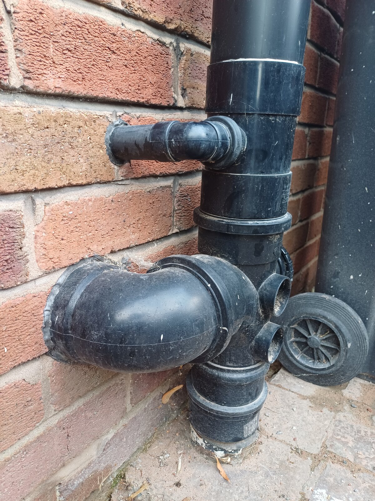

It isn't possible to go through the ground - too much concrete and this is connecting into the pre-existing and buried bathroom drain (next door room) through the soil pipe. Only option from the ensuite is to have this bend into the soil pipe on the outside.
Can I just check - would you say the question mark connector is ok? Is the issue between that and the black pipes on the outside (I.e. flexi connector between the two)?
If the question mark is ok and loo is ok, this helps focus where the action is needed. Flexi pipe, wall hole, connection into the drain outside.
Also, what do you think about recovering costs from original plumber?

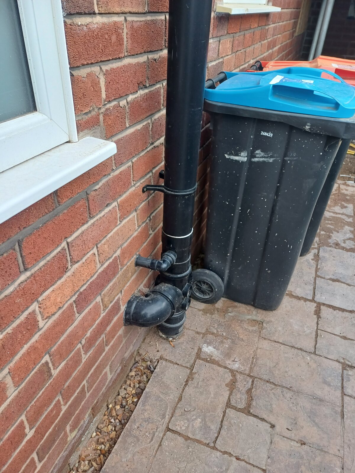

Question Mark Pan Connector should be ok, but it relies on a sensible fall to allow gravity to do it's job and let the waste get away when the WC is flushed. Doesn't need to be much fall, but currently doesn't look like there's any fall on the section through the wall!
The issue may well be the height of the existing socket on the soil pipe where it comes out the ground, it's too low for the junction to go directly into, and the short stub of pipe fitted to raise it is making the junction too high. This is what makes me think some alterations may be needed underground to get the pipework at the right height to go through the wall and put a fall on the soil pipe. (By this I mean externally, so the junction can be sat slightly lower to achieve the slight fall required through the wall. Sorry if I didn't make this clear on my earlier post.)
The alternative of course, is to raise the pan slightly. Either way, the required adjustments and replacing of the soil pipe through the wall should permit the WC to be fitted correctly at right angles to the wall, it should all be fitted with sufficient care to ensure there is no stress on any of the joints.

In terms of the socket outside, I don't know if you can tell, but there seems to be a couple of inches where you still see the old cast iron vent pipe at the bottom. So perhaps the socket can be pushed down towards the ground in combination with the hole through the wall being adjusted to get more of a slope and lining up better with the pan connector inside for a solid pipe to be used?
The ensuite didn't exist before this job so the only pipe he had to work with was the old cast iron vent pipe outside to the adjoining bathroom. He created the hole through the wall, cut off the old iron pipe, put the new plastic one on with sockets.
In terms of the flexi - I know McAlpine sell their products as being able to deal with different awkward situations and angles. The plumber will say he has used branded products as intended. Are you saying the fkexi stuff is flawed (crap goes in grooves), or does it just need a really good fall to work well? And when we say flexi shouldn't be in the wall, is this a regulation or design thing?
If I go with raising the toilet, which will probably still need the hole in the wall adjusting to accommodate changed angles and a solid pipe, how would you recommend doing this in a way that doesn't look bodgy and unsightly?
What I am thinking is:
- remove black sockets and vent pipe outside, rearrange somehow so that the black waste pipe into the wall ends up lower. Even an inch lower (or more?) and there appears scope to do this (visibile on photos). Then adjust this connector so it contacts the wall at more of an angle.
- adjust the hole through the wall so it is more sloped downwards from inside to outside, to correspond with the lower and now angled black connector outside.
- run solid pipe through the wall, running downwards, and in a position laterally that is required (hole also adjusted for this).
- question mark connector then connected to this solid pipe inside. Either at same height as existing at internal wall or slightly lower if possible.
