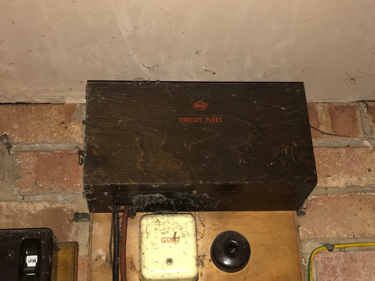

New fuse box?
My parents had a re-wire mid 1990s, must have been the earlier part as I don't remember it.
Split load MEMERA 2000, all sockets were RCD protected (3 circuits kitchen/up/down) and everything else was not.
Must have been a regional thing
I'd have one of these in my house (I'm totally keeping that when it comes out next week :love:)
471-16-01 A socket-outlet rated at 32A or less which may reasonably be expected to supply portable equipment for use outdoors shall be provided with supplementary protection to reduce the risk associated with direct contact by means of a residual current device having the characteristics specified in Regulation 412-06-02(ii).
A lot of people I knew wanted to cover their arses and RCD-protect all the sockets when the 16th came out, then there was no slipping through the net, as it were.
A true-life case we heard about when I was doing my 16th update was a 3rd floor flat whose sockets could be argued not to be reasonably expected to supply equipment outdoors, therefore no RCD protection was required for the sockets. However the owner would run an extension lead out of a window to clean his car.
I made 2 points.
To change that CU, we would have RCD protected the shower and any downstairs socket circuits. I don't recall protecting the upstairs socket circuits.
It was possible to wire up that extension without a board change. FYI some extensions have more than one story.
Yes, but they don't float in the air :confused:
