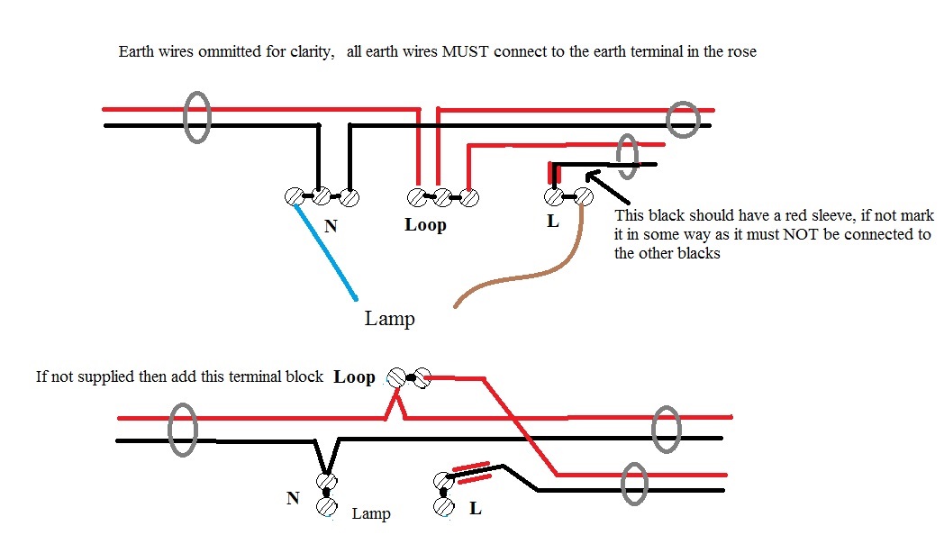

Neutral is not a name for any old Black or Blue wire.
Neutral is the wire which completes the circuit from the light back to the supply.
You are obviously connecting the switched live coming back from the switch to the actual neutral wire.
The switch would not have a neutral connected to it. Are your cables conductors coloured red and black ?
If so the black one from the switch ,is the switched live ,and it goes into the light fittings live terminal . that is THE ONLY conductor that you put into that terminal, and the only other one in there is the internal cable of the light fitting.
The red conductor of the same cable does not go to the light fitting ,but is fitted into a totally separate terminal block with the permanent live ( you may have to buy that terminal block)

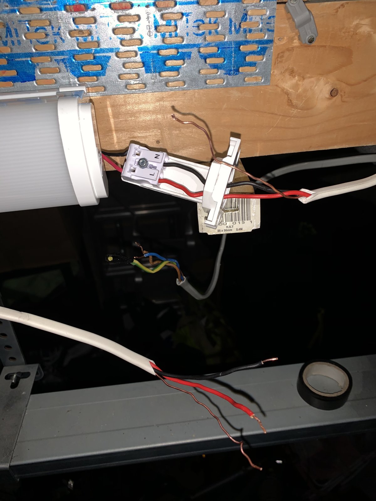

Right, I thought I was following your instructions but I’m clearly not getting something right. The MCB was popping and not allowing me to put on.
I’ve attached a picture.
The connected cables are the main supply.
The cable from the left is coming from the switch.
And the grey cable at the back is what I’ve discovered to be powering the conservatory light/fan. (I’ll connect this up once I’ve solved the light issue). This garage light was clearly used to for the conservatory light power when it was built.
Firstly all the loose conductors need to be insulated ,preferably in six individual connector blocks. If you don't have any then temporarily use insulation tape. Then see if light comes on without tripping breaker.
Secondly ,we can't see if the cables are as you say they are. But if you are correct ,the light should come on ,and stay on ,if you insulate all the other conductors. We can then tell you how to connect the rest.
Do you have a multimeter ??
