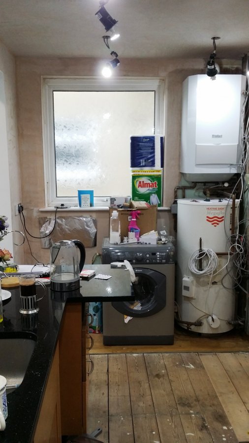

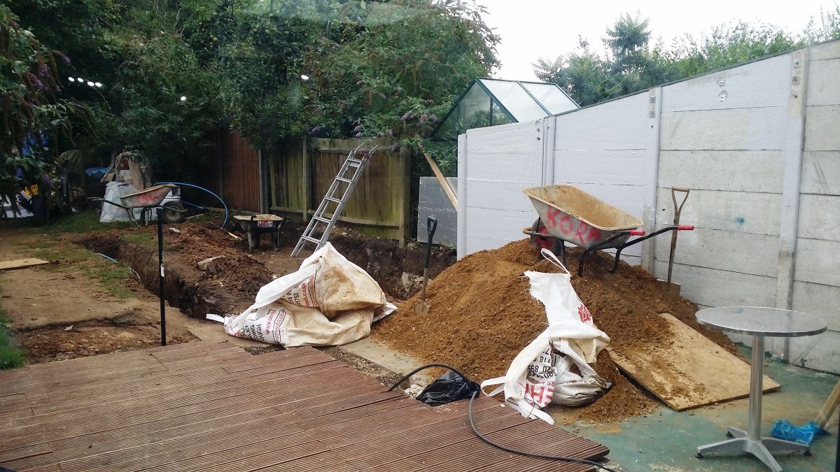

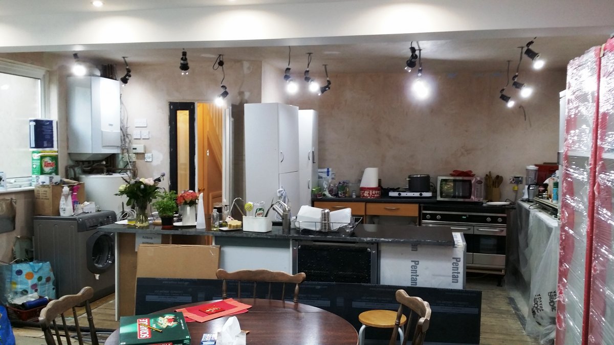

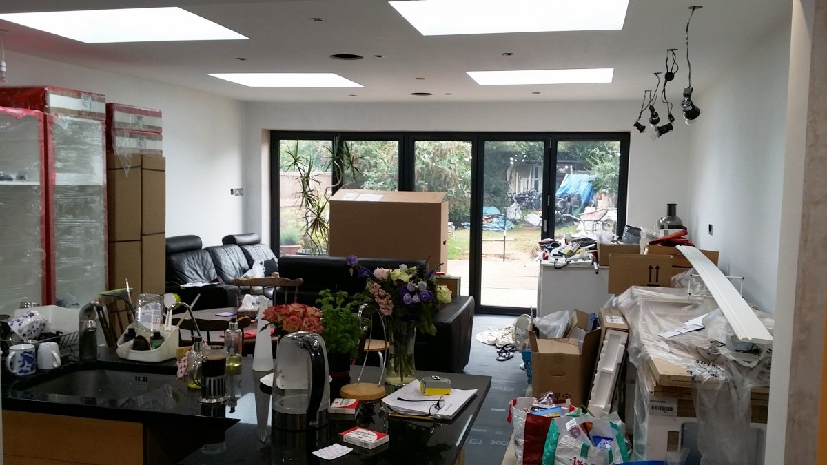

here are some boring pics, work in progress.
old garage demolished, new foundations underway
6mtr extension built
Reception blocked and being readied for new kitchen
old utility room opened up to become part of new kitchen
