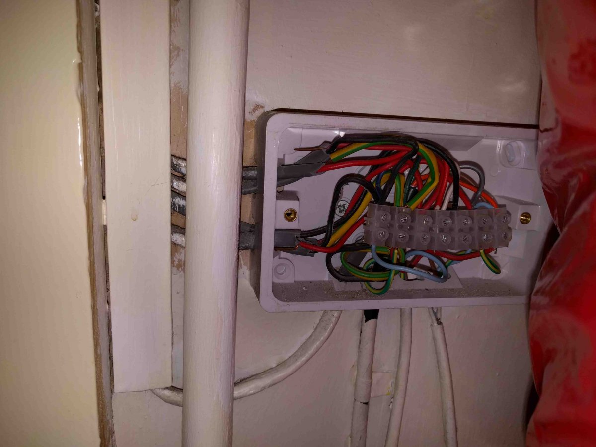

You will probably find that the brown wire from the pump connects to a terminal in the junction box, with a second wire, in a separate cable, going to the boiler. The second cable will probably carry the wire from the valve orange to the boiler. Open the junction box, take a pic of the wiring and post it.

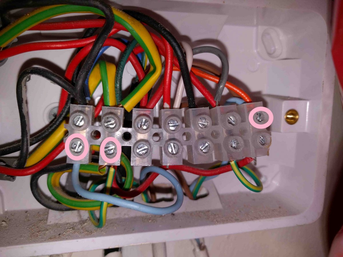

Here is a pc of the rats nest that is the junction box, figured I need one if I'm going to try powering it outside this...
I've circled the points the three wires are attached, the live is the brown one at the right end, with the orange from the valve and the neutral from the water heater themostat for some reason, the red wire it connects to goes to the only cable from the attic that goes in at the the bottom of the box on the second picture...

OK, Ran the pump from mains and it's exactly the same, it tries to start for 2-3 minutes and then starts running fine, no sign of it overheating (able to check as it's now running without the boiler).
This is really stange...could be the start capacitor, but how do 2 go identically after 2 weeks each, also manually spinning the motor should start it if that was the case but I couldn't get it to go for more than a split second
I think those smart pumps are not just a simple induction motor like the old ones. That means driven by triacs.
Consequently I don't know what to suggest apart from you have now tested them as far as you can and I would conclude that it is a pump fault and perhaps coincidence or a faulty batch if they both came from the same place.
