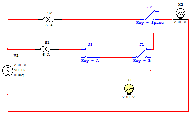

The switches are the wrong way around this is the diagram we are talking about. X1 is the two way lamp and is shown here being lit from the wrong overload. I love Multisim I can actually see the lights working. As already stated the borrowing of a live means cables become live which one expect to be dead. If both switches are operated then it swaps overload so using the standard method of switching on the lights and operating an overload until they go out will not isolate the lights as if both switches are operated then it swaps overload.
Switch J2 and lamp X2 are just to show how the supply gets to the switch.
Here shown powered from the other overload.

No - the situation I was talking about was where there are 2 MCBs, one for the upstairs lights and one for the down. In your diagram poor Andy gets a DIY cardioversion no matter how the neutrals are arranged.
Surly no one uses that system in the UK Eric! As when both switches are up, the circuit protection is shorted together and its effectiveness reduced.
