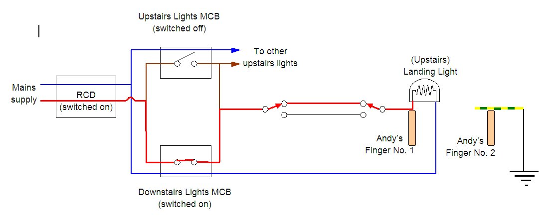

How would the other become live ? What conditions would have to exist ?
As I said, what is colloquially called 'borrowed neutral' can, in practice, be a 'borrowed line' (either will result in trips if the two circuits are on different RCDs). These situations usually exist when there is 2-way light switching and either neutral or line for one of the lamps is taken from the other circuit, usually because of the convenient proximity of a suitable cable.
Kind Regards, John
And if you have 2 lighting mcbs on the same rcd, why is there a shock risk ?
If there is a 'borrowed line' and you switch off just one of the MCBs (e.g. to do work on the corresponding circuit), some parts of the circuit will still be getting 230V via the other MCB.
Kind Regards, John
Yes ok. If you went disconnecting the neutrals you could get a shock.
I thought the guidance was that you should isolate both conductors before working on the circuit? (Flip the rcd)
Not only that. Even without disconnecting anything, there could be a live conductor at one of the switches on the 'switched off' circuit - which would be a hazard (L-E shock) whether or not the neutral were disconnected.
As above, isolating the neutral to the circuit in question wouldn't necessarily help. If both circuits were on the same RCD (as they would have to be) and you 'flipped the RCD' that would obviously make things safe - since the L feed to both circuits would thereby have been disconnected. In passing, as far as the regs are concerned, isolation of neutral is not necessary in TN installations.
Kind Regards, John
i don't agree with that.
The neutral supply to the isolated circuit has to be disconnected.

And I would much rather derive the problem from first principles, so I can learn how the circuit works. ;-)
I don't seem to be able to delete this, but I'm going to replace it soon with a more pertinent diagram!
EDIT: SEE CORRECTED VERSION ON PAGE 5
