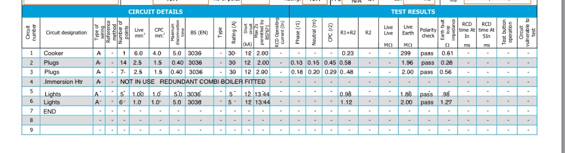

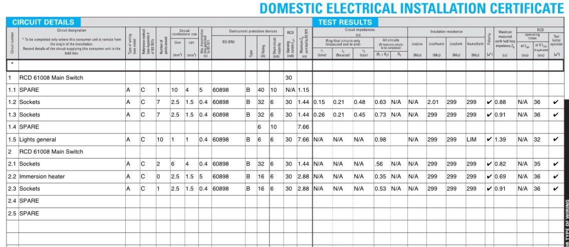

I've recently brought a new house. Before we moved in we had an electrical inspection carried out and paid for by the sellers as it was advised by the home information report. Following the inspection it was advised that the consumer unit should be changed along with new meter tails and earthing and bonding. Again the seller paid for these.
Looking through the electrical condition report and domestic electrical installation certificate there seems to be really varying circuits. I'd have expected the same circuits both pre and post new consumer unit as no other modifications were paid for. It was different companies which carried out the work. Can anyone help me understand what they might have done? For example it's gone from two lighting circuits to one? I've attached extracts from both reports.

Lights combined into one circuit.
2.1 sockets was previously the cooker, fairly likely it could be put back to use for a cooker / hob / oven if required.
2.3 socket was probably a spur directly from the old fusebox, and has been put on it's own circuit, likely this is at or very near to the consumer unit.
Circuits
1.1 looks like a shower circuit, having 10mm cable seems this could possibly be quite new, as you tend to find the older installation on 6mm
2.1 Is a 6mm cooker circuit where socket has been installed to accommodate a plug in appliance, this could be converted back to hard-wired cooker circuit. Not sure where they get the 4.00mm CPC from?
1.5 Will more than likely have two conductors in the MCB, one that was upstairs lighting circuit and the other downstairs lighting circuit, borrowed/shared neutrals will not all the two circuits to be split across two RCDs, but there is no reason they could not still be two lighting circuit on two individual MCB on the same RCD, so you can still have two lighting circuits providing they are not split across the two RCDs.
Indeed but, even better, get rid of the borrowed/shared neutral/live (assuming it is present, which seems very likely) and then re-split the lighting circuits and put one on each RCD. Some people would probably feel that splitting lighting across two RCDs is necessary to comply with regs.

I would say the "314.1 ~ (iii) take account of danger that may arise from the failure of a single circuit such as a lighting circuit ~ " is not satisfied where the lights are not split and are on the same circuits as sockets. Either some emergency lights or a RCBO are really needed to ensure should there be a problem with something plugged in you will not be plunged into darkness.
The standard method is to have sockets and lights for any one room coming off a different RCD.
There are many ways around the problem RCBO, New triple and earth cable, RF light switches, to name a few, but all cost and the electrician needs to have done an electrical installation condition report to have worked out the costs and agreed with the owner what will be done after assessing the risk. Since the work was done by the sellers you have no idea about what was agreed between them and the electrician. He may have suggested for example returning and fitting RF light switches and redistribution of the circuits once complete.
We are only looking at paperwork so no idea about the board as to if you can fit RCBO's as well or not. But the RCD can be swapped for an isolator and four RCBO's fitted in most modern boards. But if it were my house I would only worry if either it starts tripping or if you have rooms with no natural light. And if lighting is a problem then emergency lights work even when the DNO power is lost so likely a better option. I have one at the top of my stairs as in the centre of the house and very little light from outside.

Now I can see what you mean. I was not thinking of two lighting circuits on separate RCBO's, but one lighting circuit on it's own RCBO so that any problem with other circuits will not take out the lights. As it stands both ring finals and the lights are on the same RCD which means if an appliance is damaged causing a RCD to disconnect the supply you will be plunged into darkness. So to my mind using RCBO's instead of that RCD would remove that problem.
It seems to me little or no thought was used when splitting into two RCD circuits it was just a case of ease of install. The original clearly states immersion heater removed yet on second one it seems to have returned.

On the first sheet, the cpc resistance seems high for the first ring final, oddly labelled as "Plugs".

They appear to have combined, not split, the two original lighting circuits, and, as has been said, the most obvious reason would seem to be that there was an interconnection ('borrowed neutral' etc.) which precluded putting them on different RCDs. Mind you, they presumably could have left it as two circuits, each with their own MCB on the same RCD (which would have been no less compliant with 314.1 than was combining them into a single circuit), but for some reason they didn't do that. Maybe it was done by an 'electrician' who didn't realise/understand that (s)he could do that?
