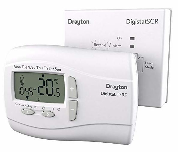

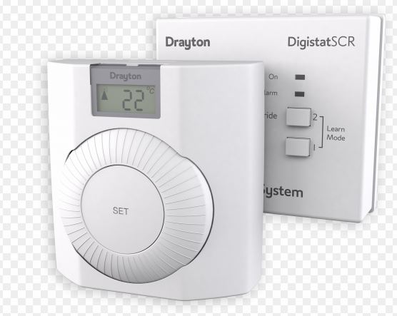

British Gas thermostats are usually rebadged Drayton products. So, I believe that you probably have a Drayton Digistat 3002 and an SCR.
If so, you are quite correct, in that this will only provide temperature control, not time control. You don't give any details of the heating system it is connected to, but if it includes a Combi boiler this thermostat would normally only be used where there is already a heating timeswitch built into the boiler. If there isn't any time control included with the boiler, then you should really have a programmable thermostat to provide both time and temperature control.
The SCR is just a receiver and can be paired with other Drayton RF products, so you could pair it with a programmable thermostat if required.

Or alternatively, it would be possible to wire in a separate timeswitch to the SCR and leave the thermostat as it is.
