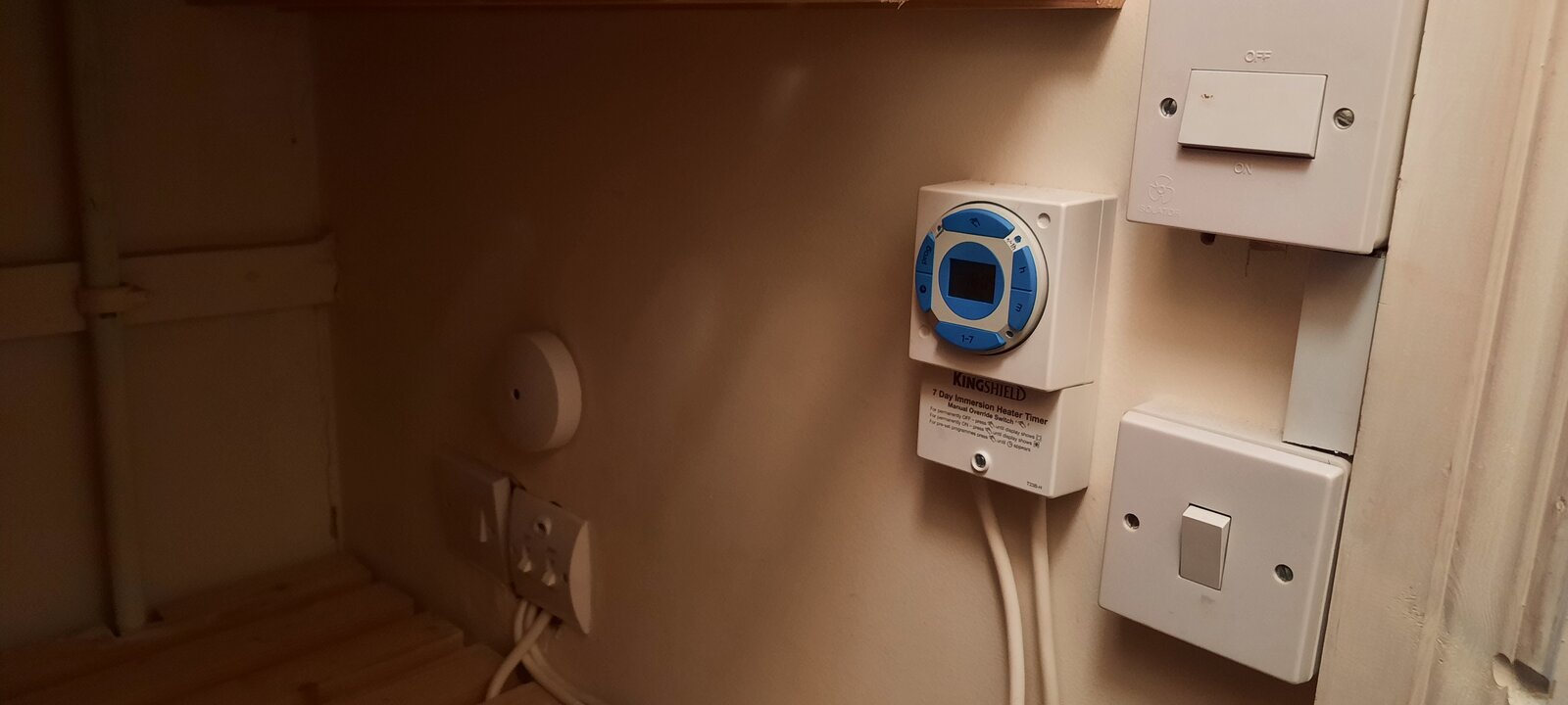

I have a sink/bath switch, with a digital 7 day timer off it.

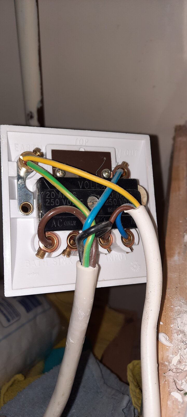

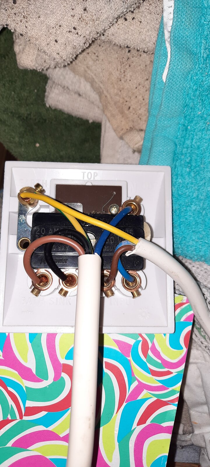

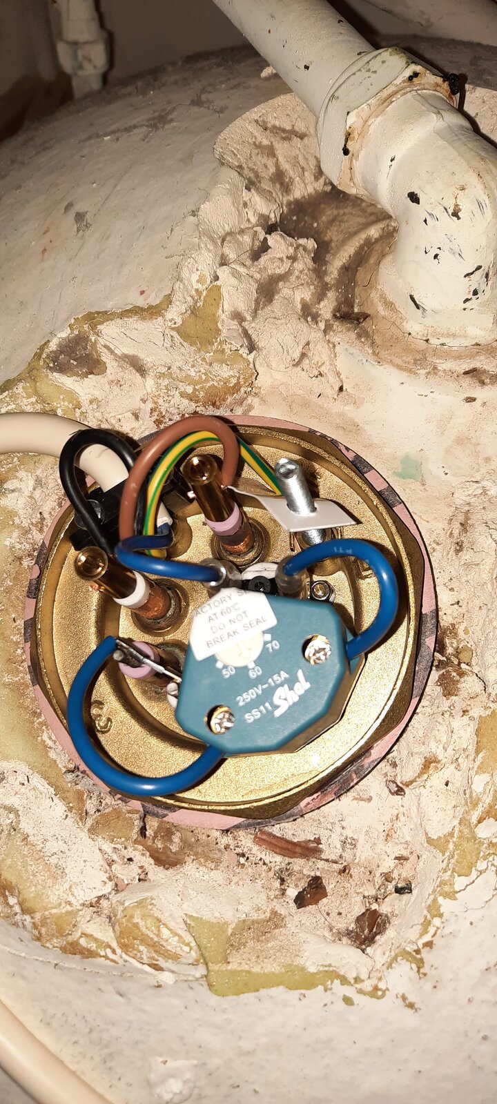

Show us a pic of the wiring at the immersion heater / element/ stat.

A healthy immersion element (appropriately isolated/disconected for test) will show about 20 ohms resistance.
Thermostat (cold), overheat not tripped - 0 ohms
After that reconnect and test live for 240V L to N, if confident to do so safely.

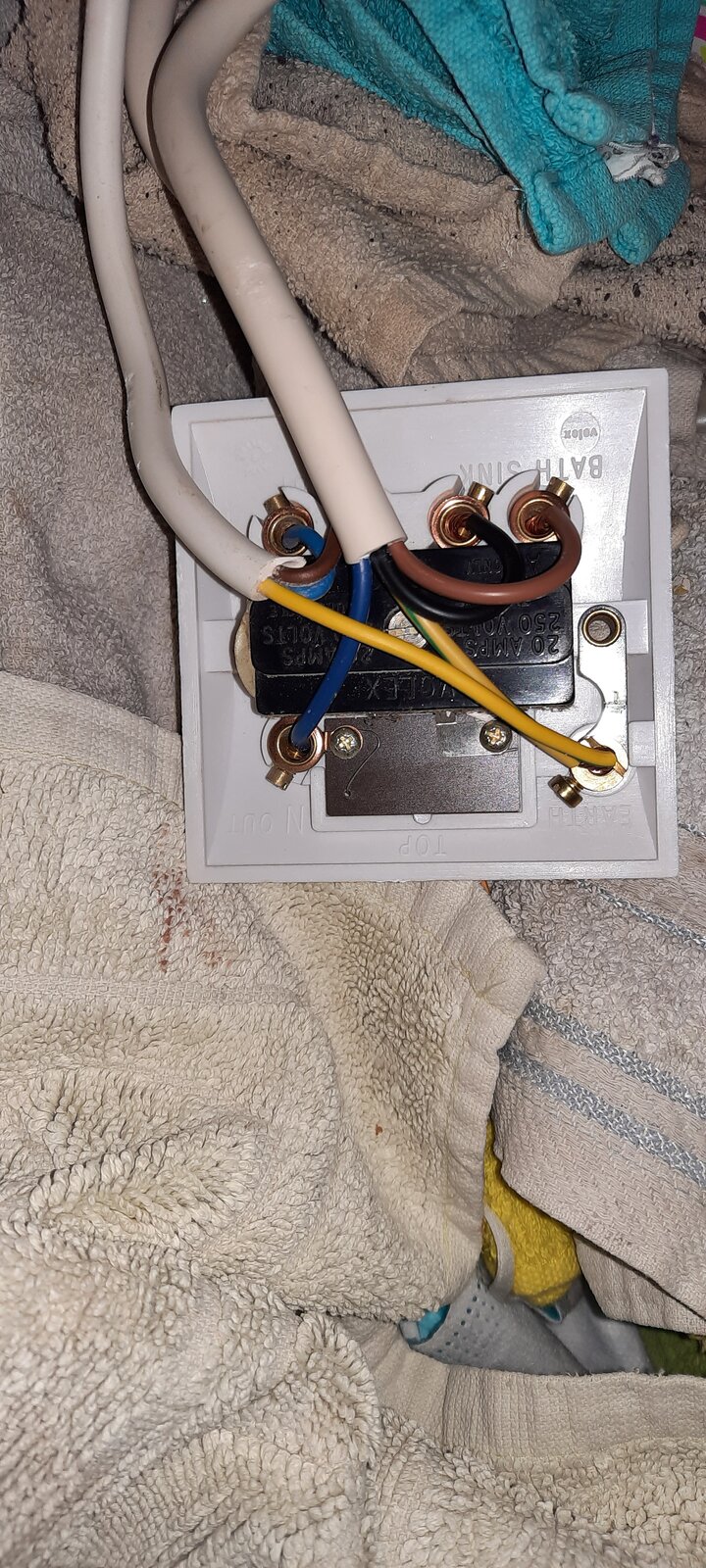

Better shot
Original wiring
If i touch the earth in the switch with the black probe and then the red against black or brown going to the immersion I get 221 reading. If I repeat in the immersion I get the same... when the power is on obviously .
At the immersion heater, measure the voltages below..
Black wire to blue wire in the right hand terminal of the thermostat.
Black wire to blue wire in the left hand terminal of the thermostat.
Black wire to earth terminal.
Tell us the voltages.
0 all the time.
if I put the red wire on earth in the immersion the the left blue terminal reads 221
If you measure earth to right hand terminal of stat ,what voltage ?
You replied earlier that black wire to earth was 0 voltage. Are you sure about that ?
