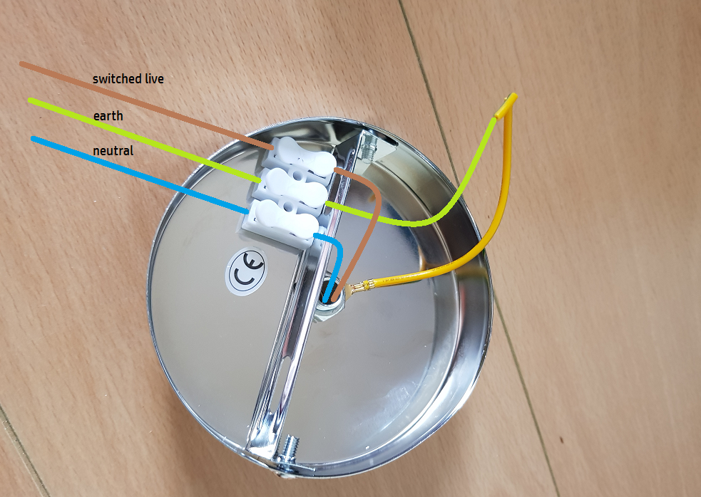

Hi, just after a bit of help please. Brought a new light and it has the connector block for live,neutral and switch I believe but it has the earth connected to a bolt ontop of light and no terminal for the earth's to go in. My question is what is the best way to connect the earth wires to the earth wire on light will I need another terminal block for it or do i just twist them together but then they will be just hanging in the light fitting which I'm not keen on. Can anyone advise what to do please

All earth wires connect together and to the wire in the new light.
Is the new light fittings terminal block actually affixed to the base plate ,or just loose ?
For some reason ,I can't view your pic of existing rose. Although EFL seems to be able to ,as colours of wires are identified in his post.
Ok thankyou with regards to the terminal block any specific I need to use?
An insulated terminal strip ( like the one that came with your new light ,which has three,but you only need a single ). Other options, like wago connectors for example ,are also suitable.
