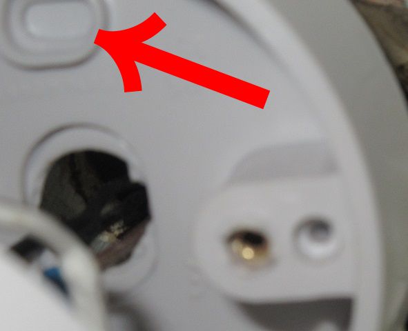

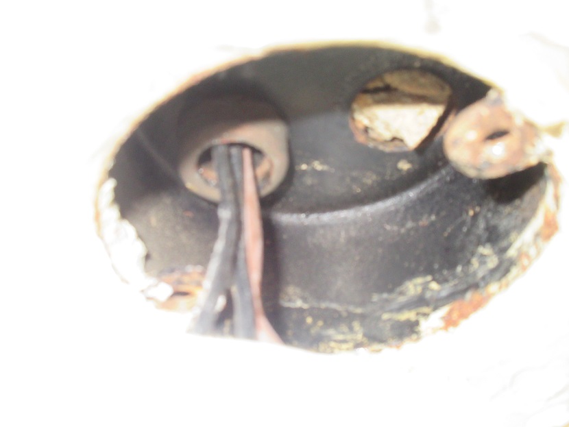

Having a problem trying to fit this new pull cord to what is existing in the ceiling. The threads are at least two sizes different, approximately m6 equivalent. The trouble is that anything thicker than an electrical screw will not fit through the actual pull cord.
Very likely 2BA, as mentioned. This is an imperial size, but they can still be bought.
You could fit the old screws of course.
These will fit through the base of the pull cord, assuming it's a decent brand that has holes that will line up with the 'besa box' embedded in the ceiling.

You do not need 2ba screws that long.
You are simply fitting the white round back box to the besa box embedded in the ceiling.
You then fit the switch front plate to the white round back box, with the screws that came with the switch (these are usually m3.5 or m4.0).
If you can't fix that back box to the box in the ceiling then you have bought a rubbish switch.
These are the knockouts used to fix the white plastic box to the conduit box in the ceiling.
They are the same ones you would use for screws directly into a ceiling without conduit.

Hopefully that wiring isn't the ancient rubber insulated type it appears to be.

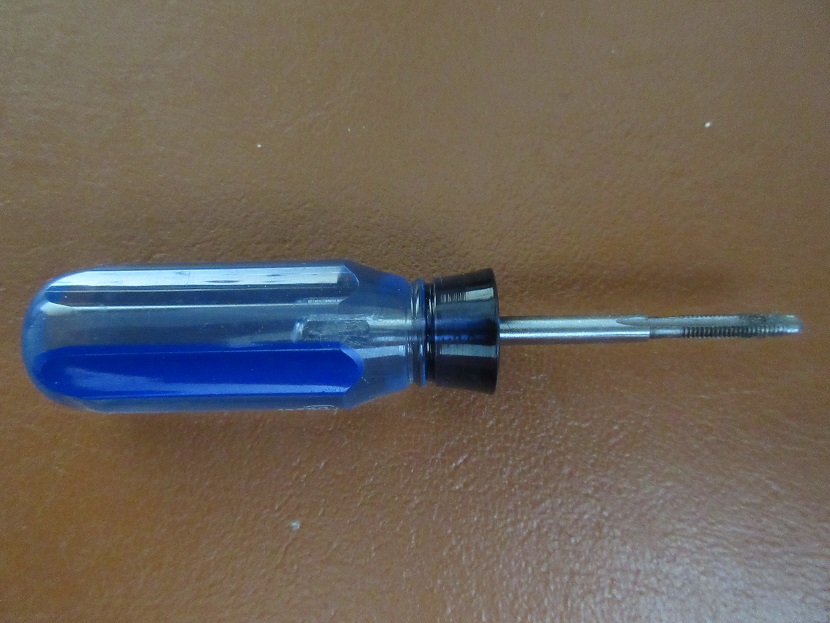

You can tap them out if you have a 5mm tap and the 5mm machine screws are easier to get, sometimes easier to get M5 x 75mm toggles to get a long screw, sometimes you need to carefully drill out the pullcord base holes a little to take the 5mm screws
I have one of these for electrical back boxes, but not a 5mm..
