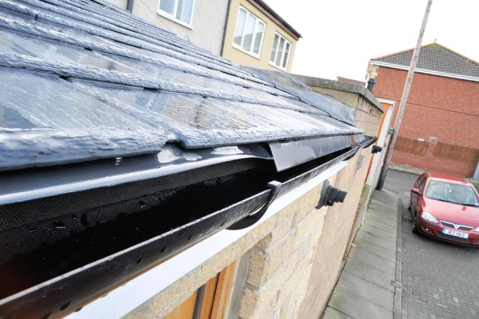

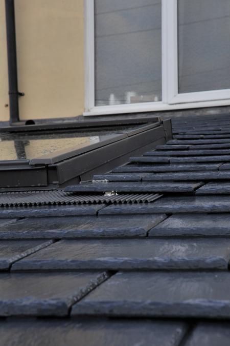

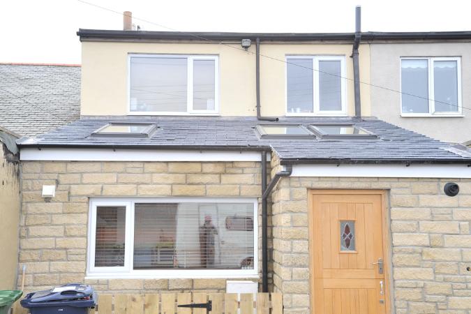

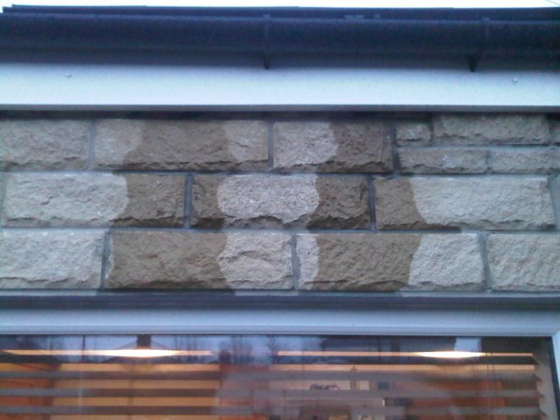

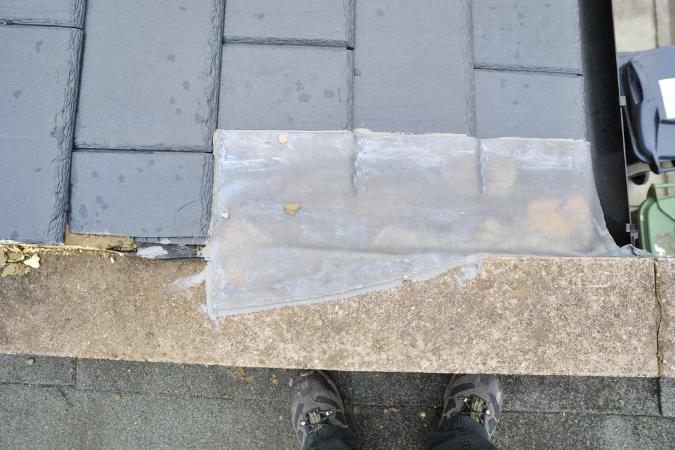

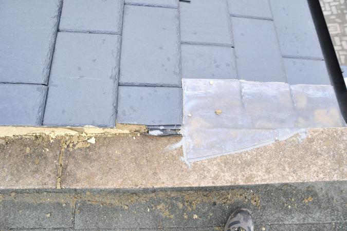

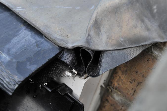

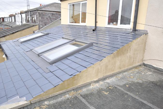

Here's our new roof, it's not good, unfortunately we have already paid for it. Other than it not looking great, there is water appearing from behind the soffits and soaking the outside wall. Can anyone shed some light as to why this would happen? The soaking happens even in light drizzle on a windless day. The builder has been back and stuffed some plastic damp course membrane from the eaves further into the gutters, but it's made no difference. The finishing around the velux windows looks like a dog's dinner but I don't know if it has been done technically correctly. During the freezing weather there was a build up of ice which dammed the gutters and caused the roof to leak into the new extension, it's not happened again since so fingers crossed. The roof is a 15 degree pitch and the slates are marley melbourne. Any suggestions much appreciated, I need as much ammo as possible. Thanks
Right where do we start!
Check that tiles have enough headlap on every course for that pitch of roof, should be minimum 65mm headlap on those tiles, looks like tiles have been overspaced horizontally.

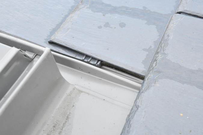

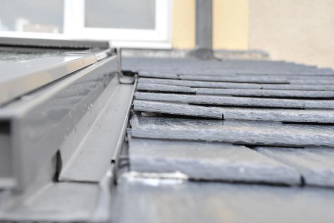

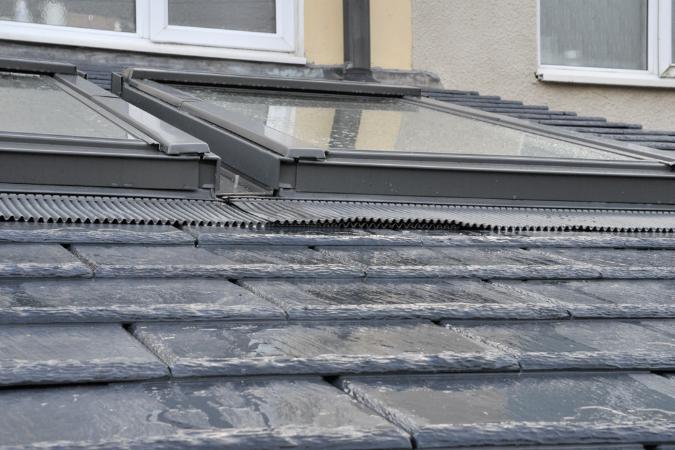

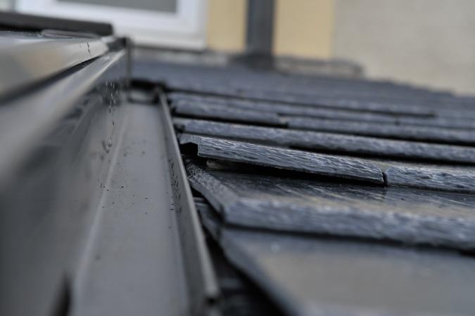

The tiles that are cut into the velux, some have been left short and they are kicking up, the nibs that overlap the flashing kit should have been removed by grinding them down with a disc cutter.

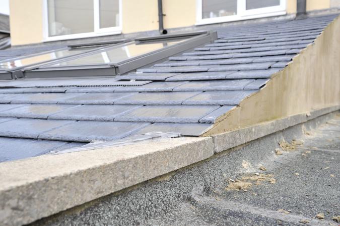

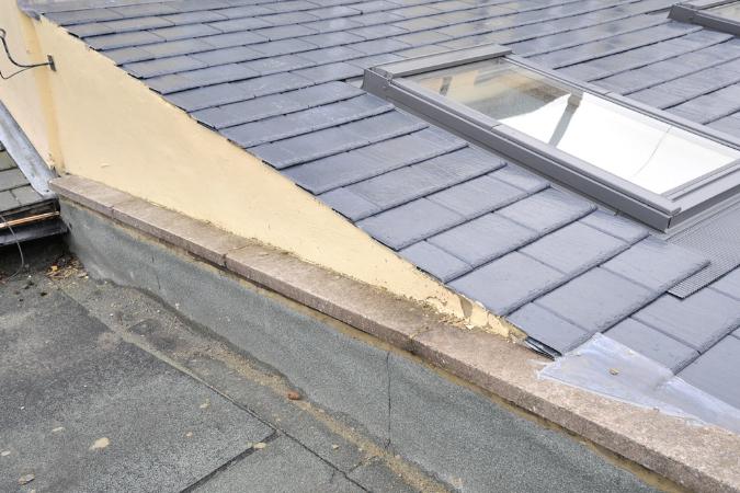

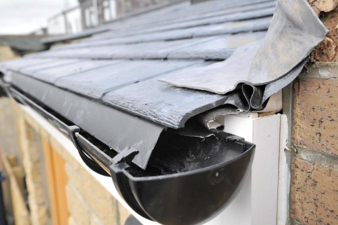

The lead flashing that joins the abutment wall needs a secret grp gutter especially at this pitch, it hasnt got one and the lead flashing is cut too short and it seems to be directing the water straight into the soffit.Ideally there should be another cut tile under this lead.

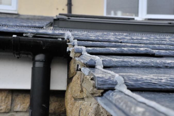

The verge with the mastic beading is outrageous, probably not a cause of leaking but it looks awful.
The eaves guard/dpc at the gutters??? whats that all about, should have the rigid support trays all the way along not unsupported dpc, especially important on a roof of this pitch.
My advice, get back what you can off this builder and employ a decent ROOFER to strip it all off and redo it, the lead flashing along the top looks ok and all the material should be there so shouldnt cost too much, about £400.00 as a guesstimate.

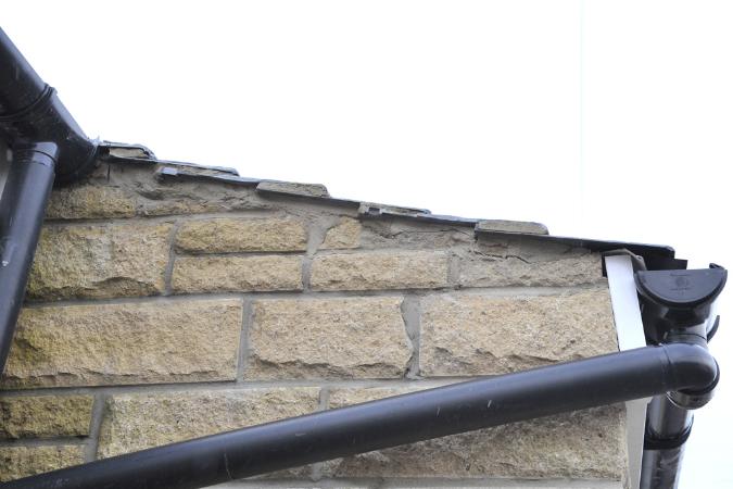

Take a side picture of this please.
YES !!!! , side picture please !!!
It looks as if he's got a bit excited about running the verge and left a "deposit" all over the tiles !
God that verge is rough!!!Why did they not just run a length of continuous dry verge up.is that insulated with kingspan or similar by any chance

Thanks for the replies, very much appreciated, here's a few more pics to cringe at. Am I right in thinking that if the wall is getting wet from behind the soffit the the only thing keeping water out of the house is the felt membrane?

Good Lord, thats shocking! Needs taking up and relaying, those leadsaddles on the parapets are doing nothing and will need addressing, more like £1000 than £400, who knows what else you might find wrong once its taken off?
One (another) glaring error is that there are no slate+halves used, he's used half slates instead which may go walkies in the wind (verge should be clipped as well)

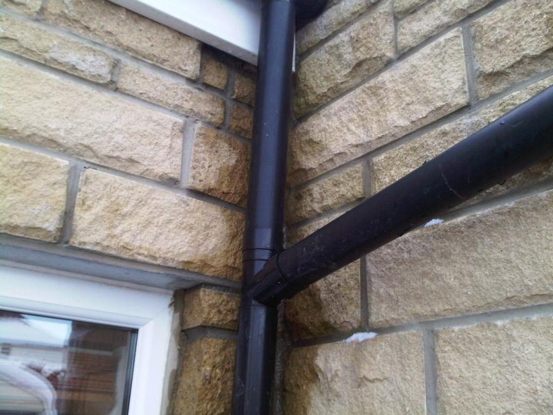

I'd redirect that downpipe end as well, bad idea to take the water from the main roof to go to the top of the roof-lights.
OMG. What a mess. Just started leaking behind the soffit in a new place, never done it here before, very very light drizzle.
