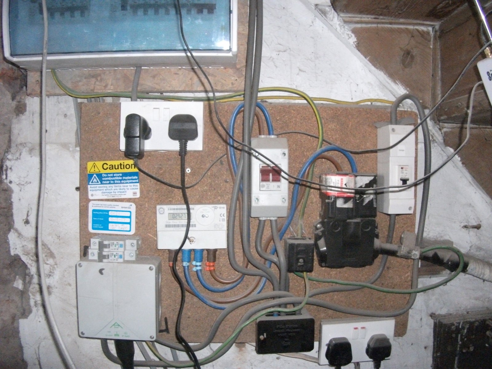

Regarding your original question- presumably you want the supply to the outbuilding not coming from the house CU (for all sorts of good reasons). So what you need is some Henley blocks between your meter output and your house CU and then a circuit breaker (in an enclosure of course) to protect the cable to the outbuilding.
First job for you is get on to your electricity supplier and ask them to fit an isolator after the meter. Some do it for free, some charge £50. Once that is done, your electrician can do whatever connecting is required without having to interfere with the service fuse (which is dangerous).
Sort of like this (bit messy but I didn't do it :) )
As for the rest- what b-a-s said, it is all notifiable work, you may not have done yourself any favours with your ducting (SWA is the weapon of choice for buried cable, whoever does the volt drop calcs may have to derate it cos it now won't get any cooling effect from direct contact with the soil). While you are doing the job, put in the chunkiest cable you can afford (within reason) - if you are planning on heating yon flat with electricity that'll suck up a fair bit of current. Add a 10kw electric shower as well and you're up to 50 amps before adding any capacity for power tools in the garage.
