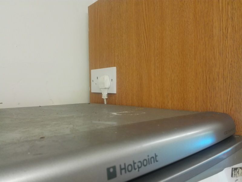

Here's mine (he said, realising that the top of the fridgefreezer is filthy):
I can't reach to clean it, not allowed up steps or ladders anymore...:(
Can't reach it to unplug it either then! :rolleyes:
Although, a nice tidy solution. I take it you just cut a hole in the cabinet big enough to take the guts of the socket and then woodscrewed the faceplate back? :LOL:
