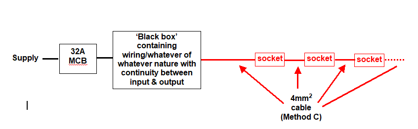

An unfused (Method C) 4mm² spur supplying multiple sockets IS compliant with BS7671 (which is all the legislation requires) - and that remains true no matter what the 'informative guidance' in Appendix 15 might say.

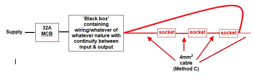

A cross connection can certainly make things worse. For example if the existing load is distributed in a roughtly equal manner then adding an interconnect from a place close to the middle to a place close to one end will shift the load towards said end.
Well, yes, but, as EFLI has realised, I was thinking/talking about (and perhaps should have made this clearer) 'sensible' cross-linkings of a ring, and I can't see (but see below **) why on earth anyone would contemplate doing as you have suggested.
If the cross-links were between 'similar' points on both sides of the ring (which is what one would expect, in practice) then, as I suggested, they can but 'do good'.
[ ** on reflection, I suppose there is one situation in which a designer might conceivably contemplate doing what you have suggested, and in which it would 'improve' the situation - namely if he/she knew that a lot of the load was usually concentrated on one side of the ring. In that situation, adding a cross connection between the middle of the ring and near the origin of the 'more heavily loaded' endof the ring would reduce (or eliminate) the risk of any cable becoming 'overloaded'.
However, as I hope you realise, I was really just trying to make the point that it is not necessarily the case that "figure-of-8" circuits are alays a 'bad thing'. Don't forget that anything to do with 'designing' (attempting to design) a sockets circuit which has multiple sockets relies on guesswork and assumptions on the part of the designer.

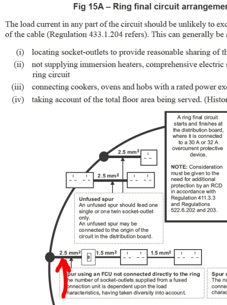

Appendix 15A does not show both legs of a ring following the same route out and back.
Does anyone think that is therefore non-compliant?

IIRC it states something like; "A non-fused spur feeds only one single or one twin or multiple socket outlet or one permanently connected equipment." (quoted from an email relating to one EICR).

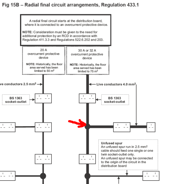

I'll have a look when I get to it. But I've not seen an image similar to the following.
What difference would it make if the circuit were a ring - assuming all the usual caveats of a ring apply?
A big difference, your image actually shows a single outlet, beit a socket or fuse, and 2.5mm² cable. Unless the regs actually state '4mm² unfused spur with multiple outlets' it will always be listed as non compliant by inspectors, the following image at no point shows what you advocate, regardless of whether it's safe..

As I (and others0 have said, nothing in the regulations 'excludes' it. The thing which many people seem to think 'excludes it' is informative guidance in the (not 'normative') in Appendix 15 ...
As for "nothing which allows it", 433.1.1 very much does 'allow' a Method C 4mm² cable protected by a 32A MCB to supply multiple sockets - and you do not need too look/worry any further than that. The fact that there are two bits of 2.5mm cable (usually of unequal lengths) in parallel between that 4mm² cable and the 32A OPD dopes not alter anything.

Do you disagree that the part of the circuit shown in red here is compliant with BS 7671 (433.1.1), regardless of what is in the 'black box'?
It doesn't need to - it is in a part of the book which does not relate to 'requirements' of BS 7671.

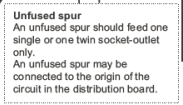

A good example.
However, that wording points to a 2.5mm² unfused spur.
If the wording actually said "A non-fused 2.5mm² spur feeds only one single or..." would you then think it did not apply to a 4mm² spur.
Would you please explain how or why two single sockets on a 2.5mm² unfused spur is electrically "potentially dangerous" ; i.e. has been given a C2 on an EICR. Please only use electrical reasons; not "some idiot in the future might change them to doubles and connect a hadron collider". You might also give reasons why the unfused 4mm² spur with several sockets is also "potentially dangerous" having been given a C2.
