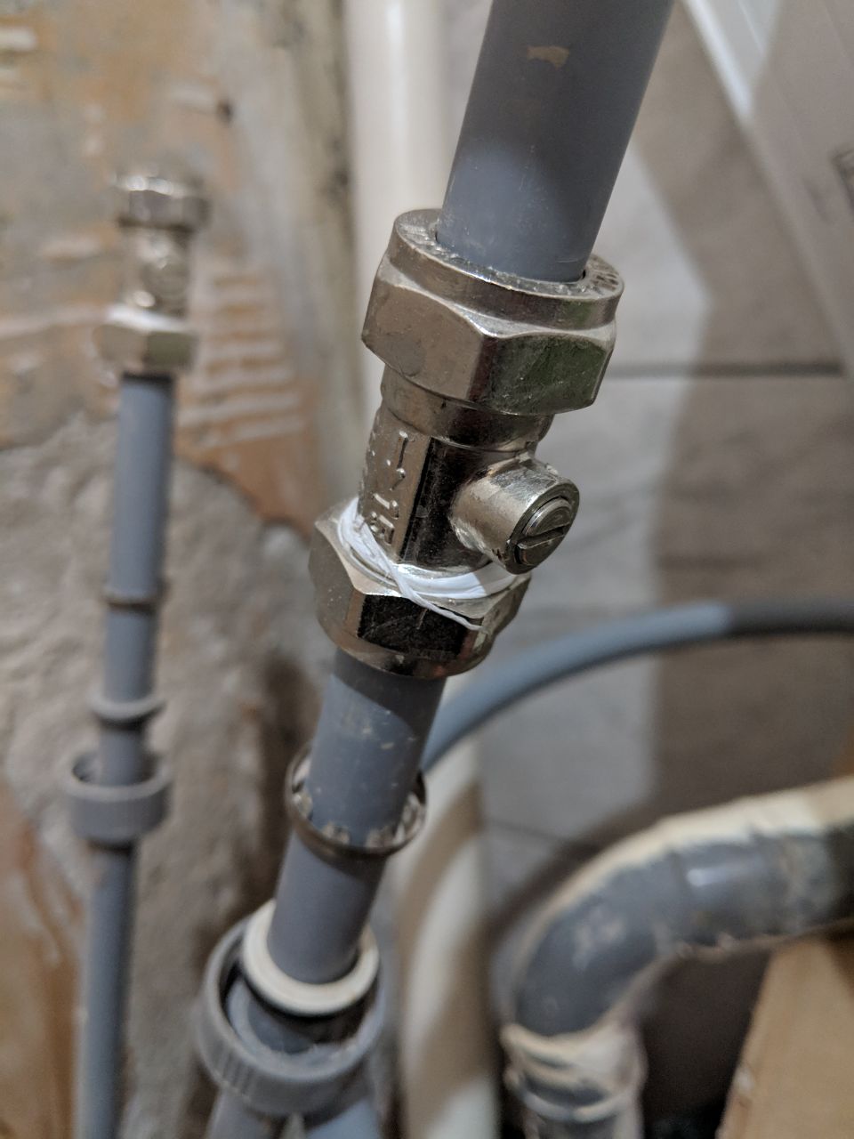

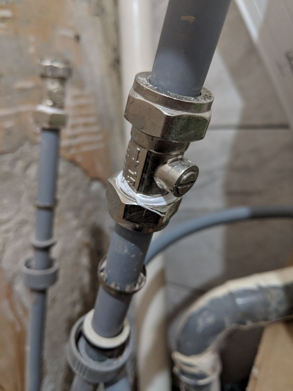

One quick question, the hot water is via a gravity fed stored hot water tank. System boiler in the loft. Bathroom on first floor, Stored hot water tank on same floor, cold tank one floor up in loft.
Should they of fit full bore isolation valves. The hot water in the bathroom was never that great. The valves they have fitted look standard restrictive?
Should I be asking for a swap? I am assuming the arrow should be correct direction as well?

ThanksView attachment 153708
Yes is important to have the arrow in the right direction .
Hard to say regarding flow of hot water in the bathroom without having seen for myself Basics would be to ensure you purchased low pressure taps etc is important .
