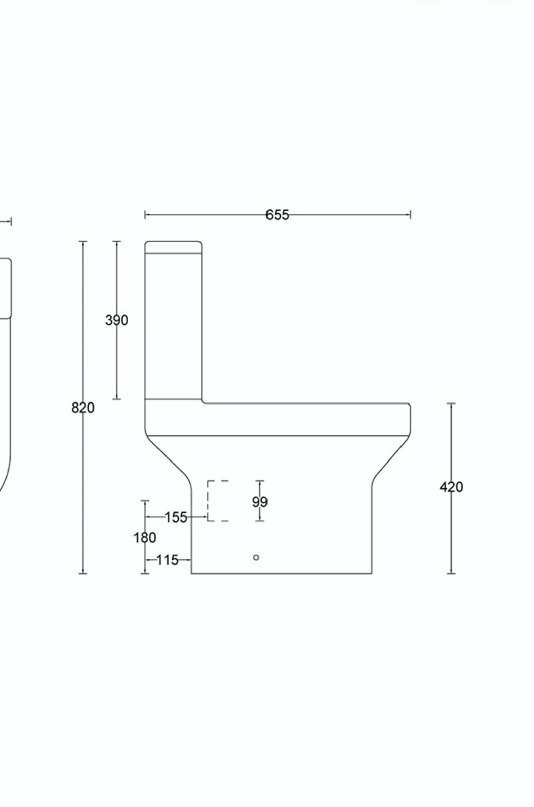

Thanks I do appreciate it and have no experience at all with these, it’s very difficult to visualise it and try and work out the measurements etc.
If you wouldn’t mind taking a look at the measurements f the new toilet attached. You’ll see the gap for the pan connector is 115mm so very little play between the wall and toilet, and then connection is 155mm away. Will the one you have linked reach?
"Build up of sediment in the flex" may have something to do with horizontal use ?
