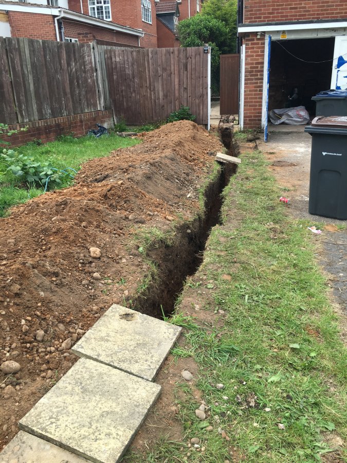

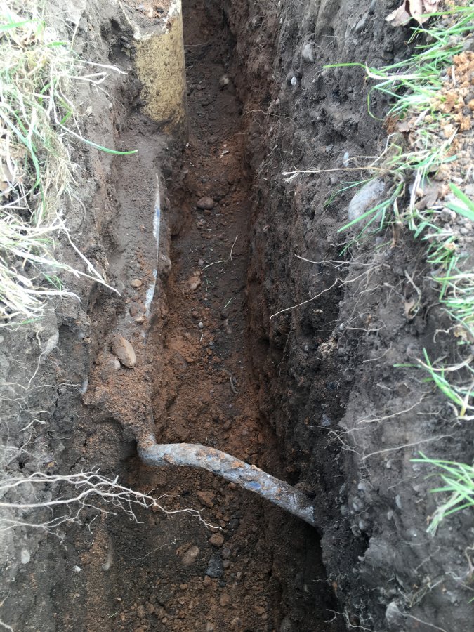

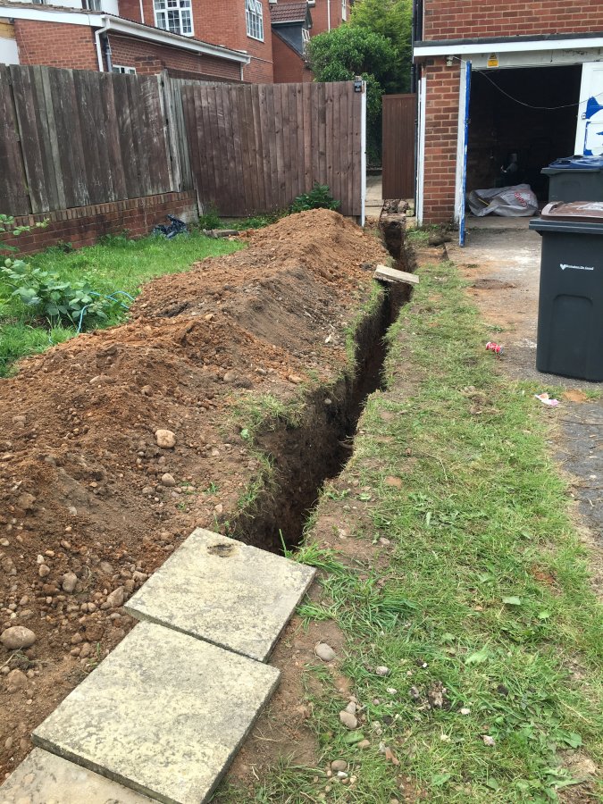

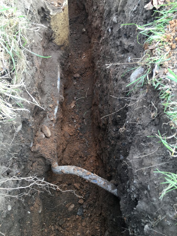

Ok I dug up hole(or some Romanians did it for 100 pound;) now just need to feed pipe. Here are some pics so far.
Some questions however.
-what stop tap should I get, plastic or metal? Link me (eg screw fix)
-what drainer should I get.
-struggling to find duct to feed pipe into house, anyone send a link (using 32mm pipe)
Sorry forgot to attach photos . Here you go.

So what are we looking at here?
You could always get them to make the connection with 25 mm and after they are gone replace the rest with 32 mm!
