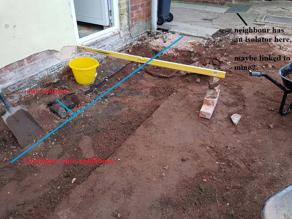

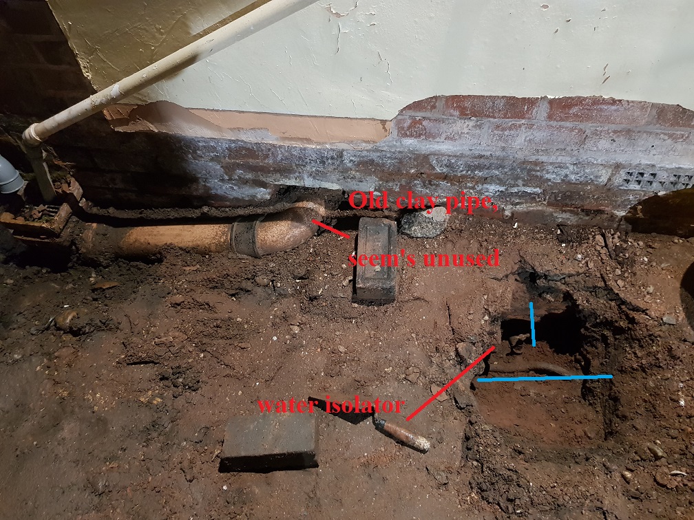

So we have our old extension knocked down, iv been digging around for the lead water mains supply and come across a problem. the old extension was built over the old outside tap isolator, when i had the concrete breaker in there i nearly went straight through it.
So we knew we were on a shared supply of 3 houses, i initially thought the run went down the side of the houses, and i have uncovered that the run is across the back of my house. it looks like i am in the middle. i planned on just cutting the lead out, fitting a plasson lead lock onto the lead and attach some MDPE into the new extension, all done outside the extension boundary for future access.
i cant see how we can get away from not building over it, either way, our neighbours need water, simple as. so all i can think is, leave the tap in place, turn it off and cap it off with a compression fitting, and fit some sort of access chamber for future.
Tap into the lead outside the perimiter of the extension with a new isolator and some mdpe..? ideally i would like to cut the tap out, join the pipe back together soldered so it needs no further access but not sure if people still do this?
A new mains connection is £1000, and this would still not solve the problem of a isolator inside our extension because of the neighbours pipework is there.

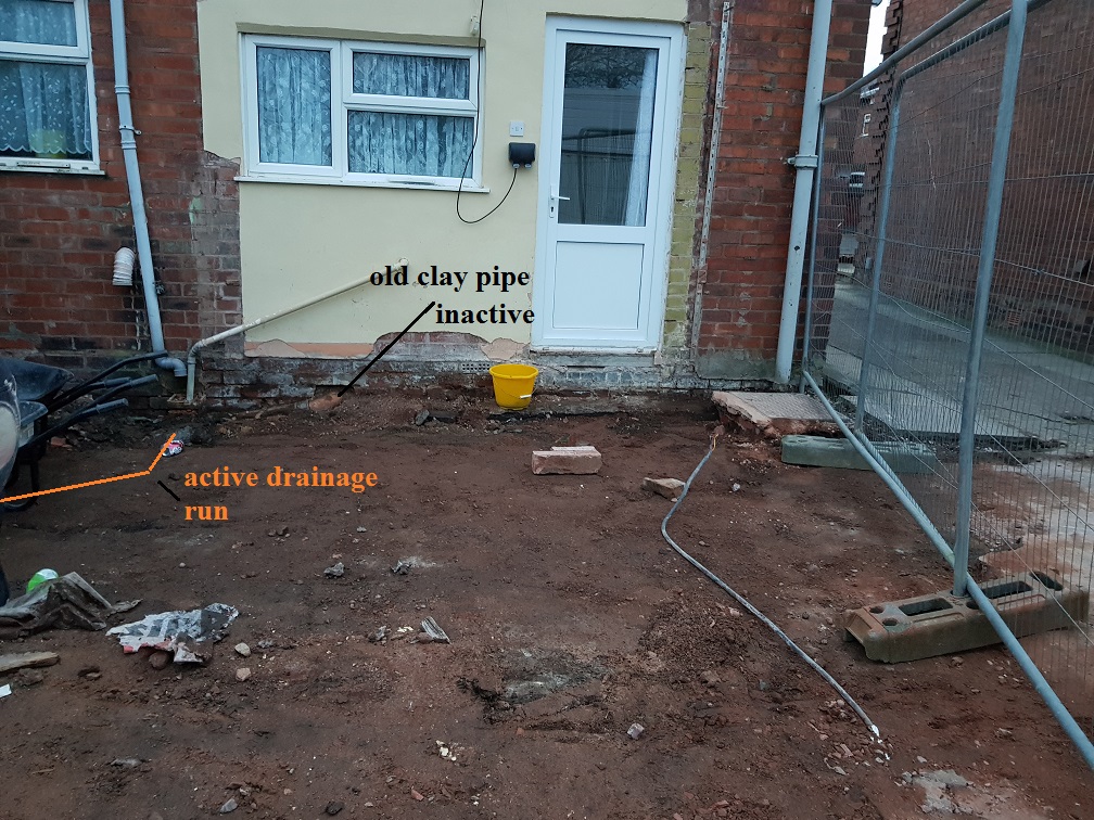

in the pictures you will also see the storm drain pipe run, i think we are fine with this as we are at the top of the run and the architect has suggested we just cap it off. there's an old clay pipe coming out the house from the kitchen, i cant get anything to come out of it. i checked it again today with the bad weather and nothing. i think it's from an old tin bath or something that used to be downstairs. they used to be located not far from that. not too concerned about this right now.

You wouldn’t normally have an isolator there but I guess it’s a good idea.
I’d be tempted to replace all the lead under your extension with a single piece of MDPE, then to tee off to yourself (with or without a stoptap) outside of the extension.
The "old clay pipe" looks to me like it has a Hep-sleeve or similar. Is that black thing a rubber collar?
Maybe it's something else that's not seen in my area.
All that efflorescence suggests a long-term leak, or possibly from a washing machine, which leaves white marks from the soap content.

The black collar is plastic im pretty sure. I will check it again tomorrow. The p ttap exit also has a black ring on it. May suggest the p-trap is newer and the clay pipe is original. There was bits of old broken clay pipe all in that area. I think its been replaced at some point.
As for cutting out the lead, its definitly a good idea, but this would mean j would need to cut it back to the boundary on the left, that we are joined to. I dont want to go digging up their garden, but i could do the connection on the boundary so future access is possible from their side. Does that sound right?
As for the white stuff, im not sure. We have been here 4 years with no issues, unless the waste was leaking into the cavity and iv never seen it. Funny though because the day we took the extension dow and broke the floor up, i remember i was suprised how wet it was near that air brick. And thats right by the domestic waste. I will check it out thats for pointing it out.
Isolators in gardens are common in this area. My moms has one and shes in the next council area. I remember suspecting there was one under there when we moved in.
Yes, that sounds right to me.
The best thing to cut the Lead with is a normal cutter for plastic pipe, give it a good scrub first with a Brillo pad or similar and then cut and join it.
There are loads of fittings to go MDPE to Lead but my favourite are the Plasson Plass4’s like this:
