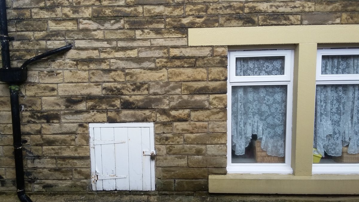

Below is a photo, the window will be about 300mm above the white wooden coal shute door that's visible. So if I've understood people's advice correctly I should take individual stones out and build up to the window frame (meaning I should probably get that first). Then using something like these http://www.wickes.co.uk/Wickes-Galvanised-Safe-Edge-Frame-Cramp-50x100mm/p/240024 attach the frame to the inside edge of the wall. What about the sealant will something like this do? Also does anyone know where might stock the thick lintels used in the windows to the right and what's the term for the one at the base of the window as I always thought the sill was just the wooden overhang section which is part of the wooden frame?

I have put in/altered 8 windows in my rock and rubble cottage in Wensleydale. No need for wooden frame, hide cut edges of blocks by rendering the external window reveals. As my walls are 24" thick, I splayed all the internal reveals, lets in a lot more light. Line all the internal reveals with something like aqua panel, otherwise you will have mould growing in them. I used recovered limestone lintels. The one in the photograph look a bit too perfect, are they painted concrete? Because, if not, they could be of marginal strength, due to faults within the stone.

That type of stonework is easier to prop than random rubble.
http://www.acanthuscaststone.co.uk/products/headscills.html
Somewhere like this for the lintel and cill.

Thanks Stuart, the walls are an external wall of stone, a cavity then a wall of brick. Regarding the windows I am using timber double glazing so are those not the right sort of frame clamps? When you talk about the stone jambs am I right in thinking you mean something like this http://www.buxtonarchitecturalstone.co.uk/2010/03/architectural-masonry/ is there a way to do it without those as I'm trying to make it look as close to the existing windows as possible. If not I'm sure I can make that look right if I take my time. For the lintels I might use some of these http://www.buxtonarchitecturalstone.co.uk/2010/03/architectural-masonry/

Thanks Frank, do you have a photo or a link to something similar so I can see what you mean?
Steve,
The jambs are also known as the reveals. They are just the masonry next to the window opening. What I meant was to put the frame in place in the opening created and build it in.
An alternative way is what you said about cutting through the stonework, but building the frame in is a neater job.
Rendering up the reveals won't match the rest of your windows, but it's up to you.
The frame cramps should be fine.

OK thanks Stuart then that's what I'll do. Would you still use some kind of silicone sealant between the window frame and the masonry or just stone and mortar right up to the frame?
Steve
The stone would be built right up to the frame. On cavity walls built years ago a piece of 6 inch vertical DPC would be tacked to the side of the frame and the inner brickwork built to return to the facework.
