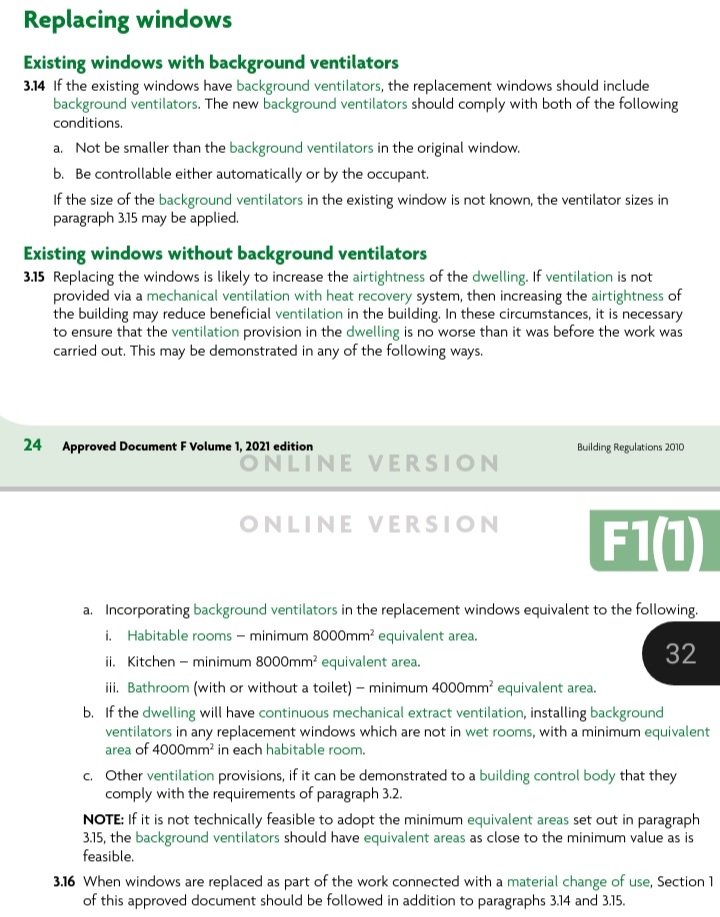

It's not quite as simple as that is it? Or do you have knowledge or access to legislation that we don't? As I understand it even if you're existing windows don't have vents, you'll need to be able to demonstrate to BC why your new windows don't need vents.

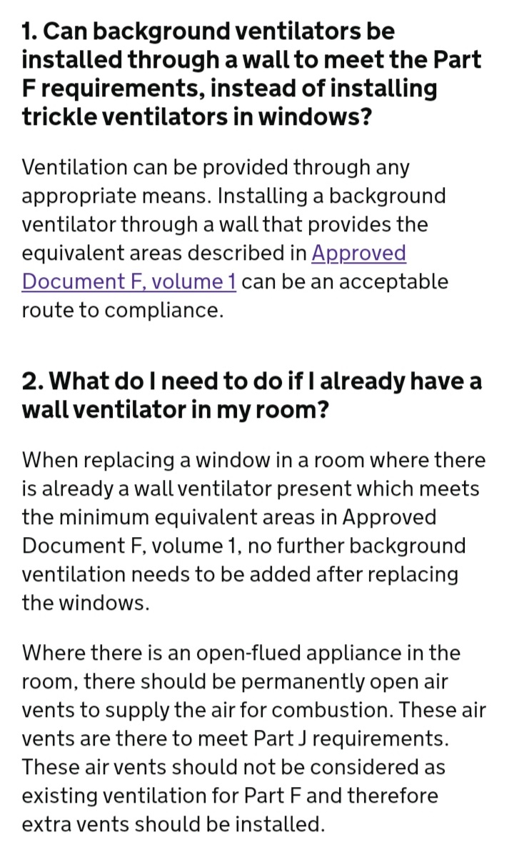

What approved document F says along with some frequently asked questions...
As I tried to say earlier, there may not be a need for trickle vents to be fitted to replacement windows, if the airtightness of the property is not improved - i.e. if there is a suitable amount of ventilation provided by any other acceptable (and demonstrable to building control) means...
See the post below yours
Yes I'm aware of all that, hence vents are required unless the OP can demonstrate to BC why not. I suspect they'll have none of the alternatives hence my post.
