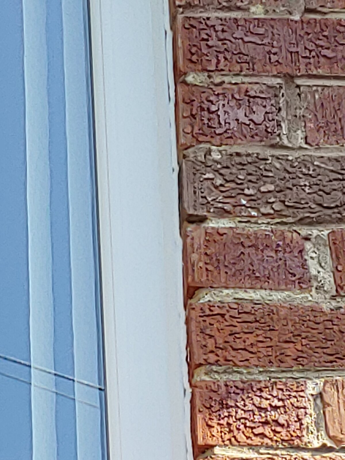

We are still having issues wIth the window fitter.
He says there is nothing with his finishing off ,trims, sealant etc...
The door handle is very stiff to move even with the door open.

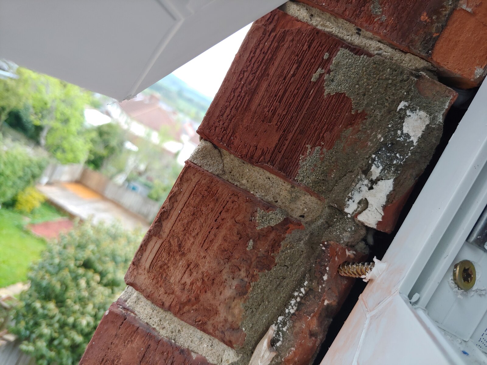

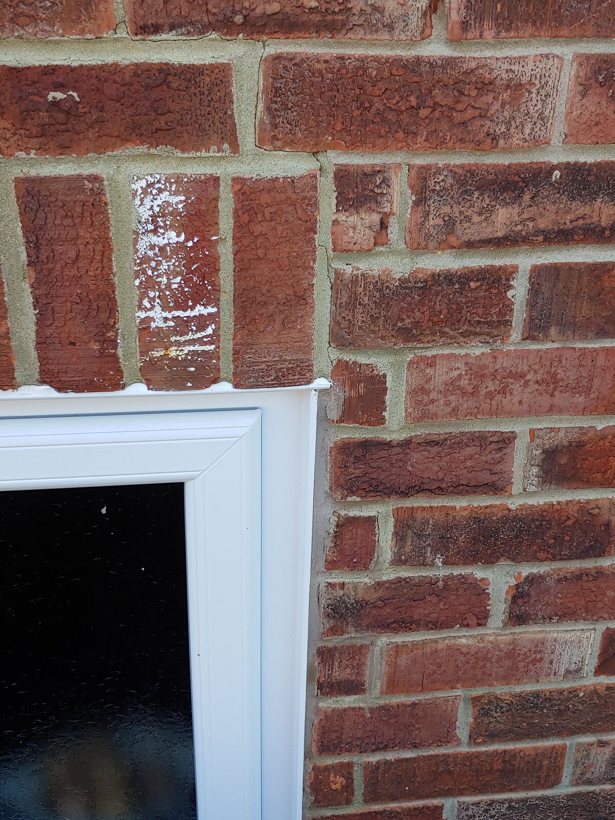

There are loose bricks around 2 windows.
I could go on all day with faults:confused:
Where do i go from here, looks like a stalemate.
I will upload a few of many pics i have
Any advice is welcome

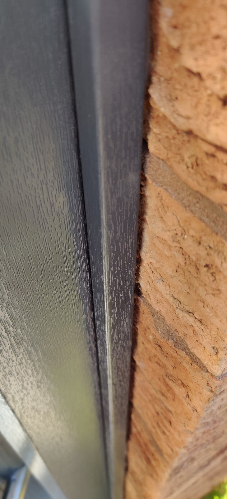

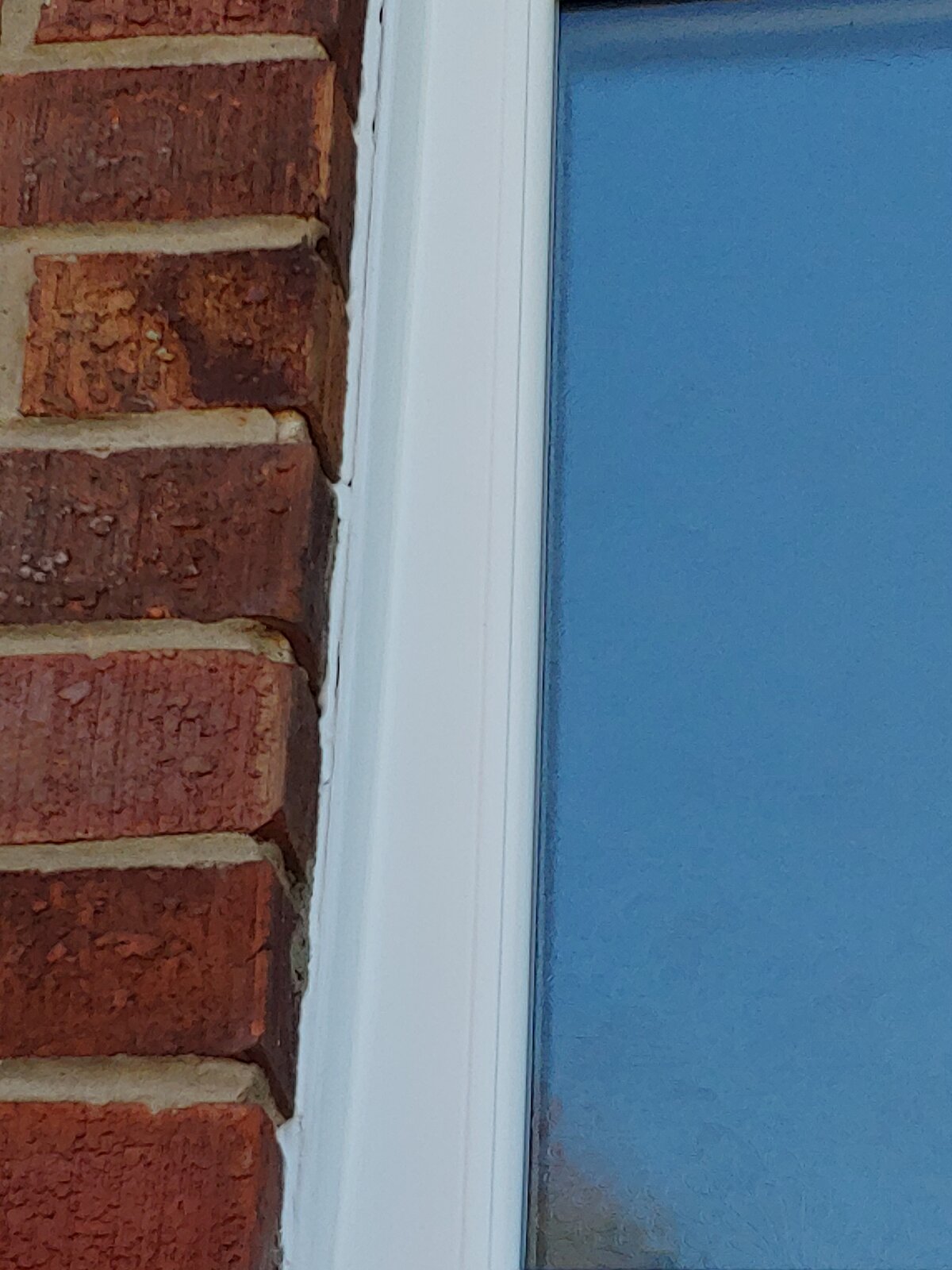

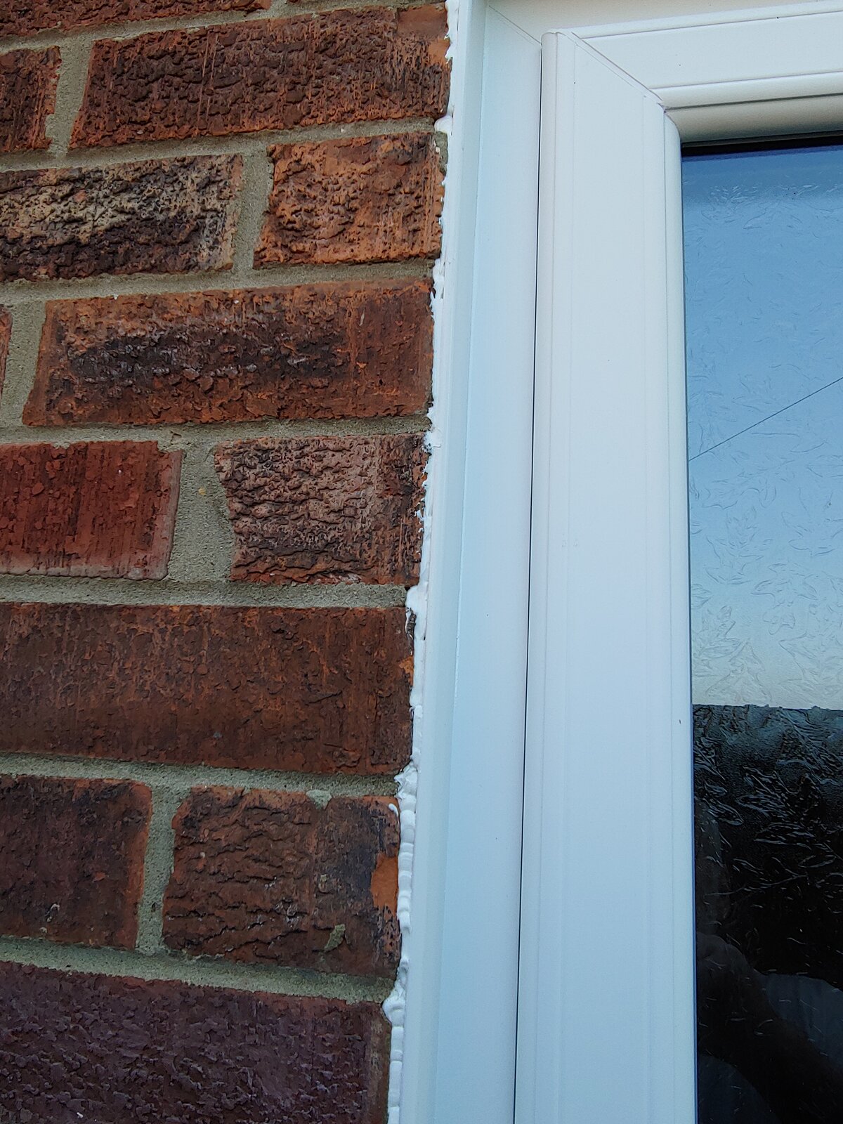

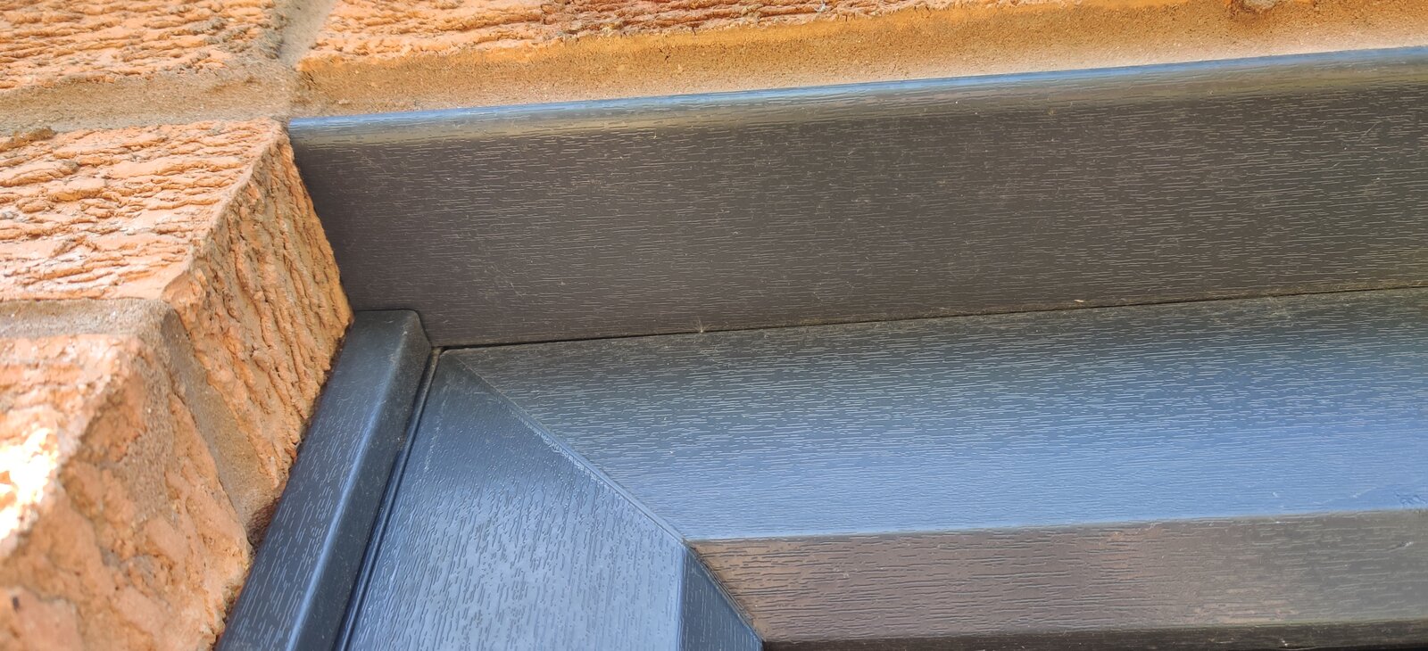

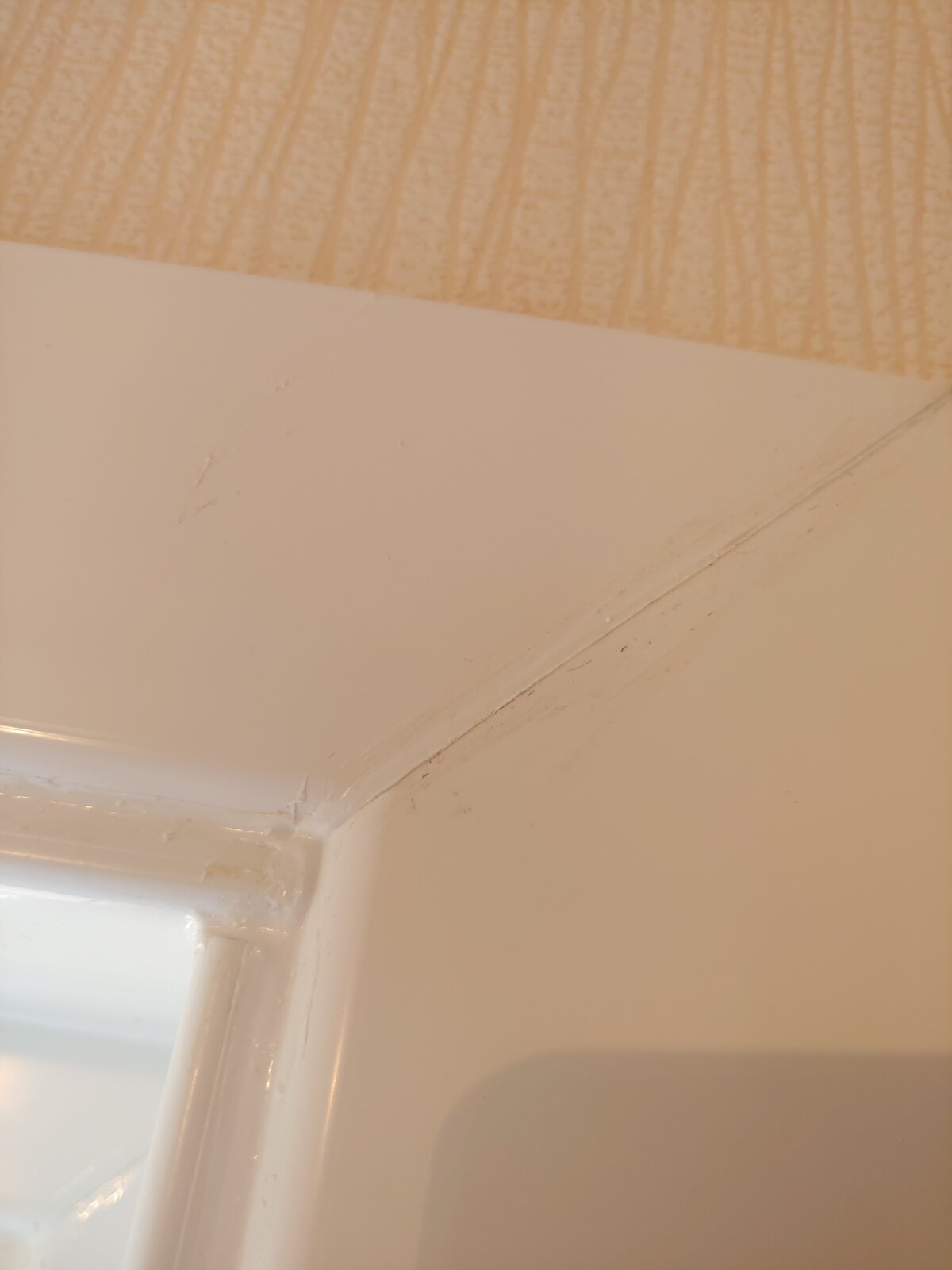

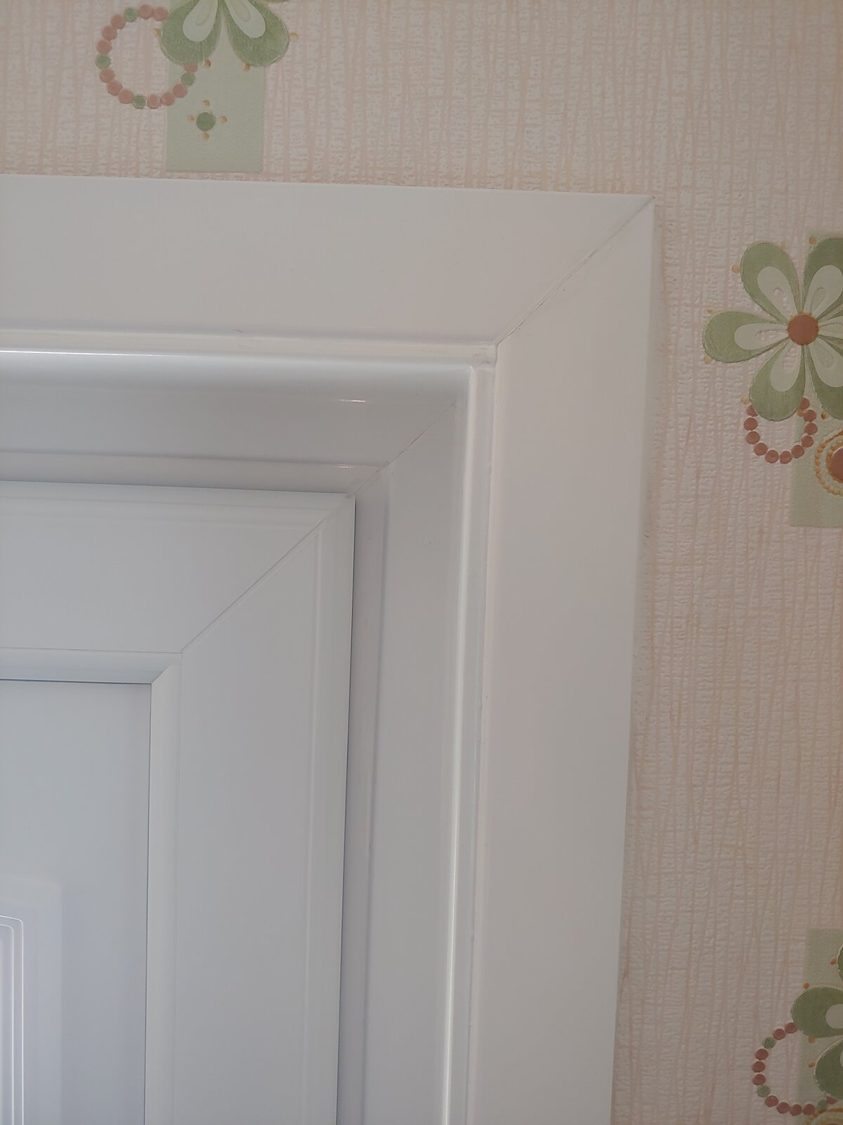

there are some pro upvc guys that run their own businesses on here -If you post some good pics they will give their opinion.
those images look like poor trimming / mastic work.
Thanks for the reply.
I will put some full size pics on

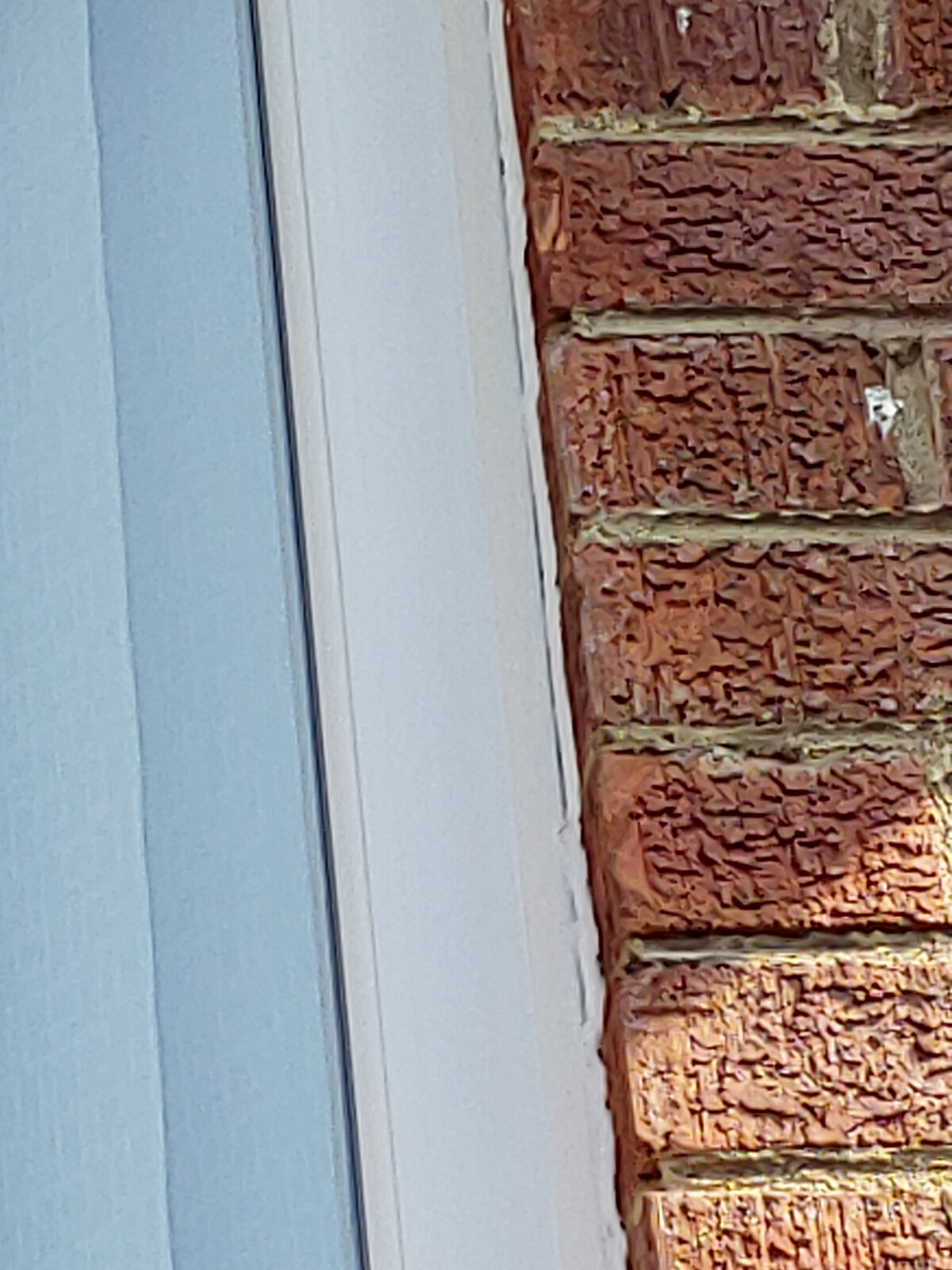

The sealing is appalling and has also shrunk away, now a question - was there a smell of vinegar in the air when they were sealing up or after they'd left for the day?
Hi.
No smell of vinegar but he said it was high quality silicone. Im sure it was called soudal??
He came out today but couldn't see anything wrong with the sealant:ROFLMAO:
I think it's best to seal gaps with silicone, then cover with trim which is not siliconed.
Silicone only weathers and looks garbage anyway
Soudal is good quality but looks like it's been applied with a spatula, the areas where it's shrunk would lead me to think they've used high modulus acetate cure rather than low mod neutral cure, low mod has a higher elasticity this able to expand and contract to a higher degree before it let's go of one surface, high mod smells of vinegar hence why I asked.
Other than that if he thinks there's nothing wrong with the sealant he needs to change careers
And like Notch suggests it's always a better finish if you can foam up then seal and then cloak over to tidy it up, I've done the same on my own house, much neater I think

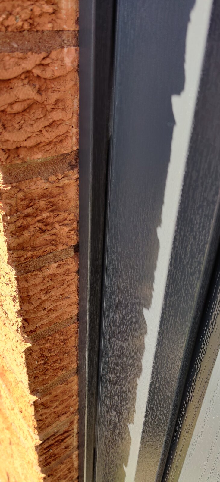

That is how the bottom of the cill is done. Only because he had silicone all over the brick cill and i asked him to cover it.
As for the sides of the windows they have a 50mm trim on it to cover the old silicone "his words" .
Could also be for other reasons too
That is absolutely shocking, ok the window is sitting over the cavity and can be a pain sometimes, you can either fill the void with construction foam and let it expand onto the side of the frame or knock in some 2 x 2 chocks into the cavity and fix into that. What he's done there is bad practice, taken from a fitting guide
• Corner fixings should be a minimum of 150 mm and a maximum of 250 mm in from the corner
No transom or mullion fixings should be closer than 150mm to the welds, or further than 250 mm from the centre of the transom or mullion. All intermediate fixings should be at centres no greater than 600mm
