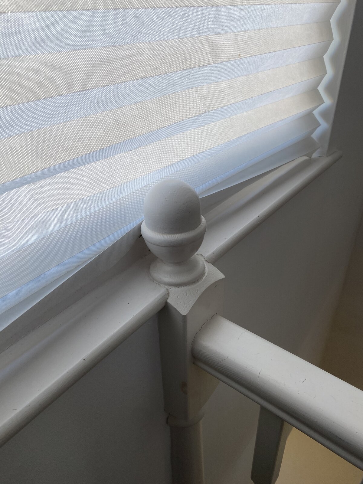

Hi all,
The top of one of our newel posts on our stairs comes through the window sill (related to the house being converted at some point) it looks weird and gets in the way of the blind.
So we’re considering sawing it off.
Does anyone know of any reason why we shouldn’t saw the top off so the sill is flat/smooth again? Won’t affect anything structurally will it?
Pic attached

that will be an addition [dowelled on] as its only a half newel, so tap tap tap in several directions around the acorn protected by a towel or similar
Ahh this makes sense.. I wrongly thought the other half of the post might be in the wall ‍♂️
It won't affect anything structurally but you are removing a bit of character.

Cut it off and cap sill with upvc window hockey stick board but extend it out past the cut off acorn. It will then also make your shelf a little deeper as it looks very narrow from the picture. Your Mrs will thank you as she can then put some **** or other on the windowsill :ROFLMAO:
Ridiculous, should have never been installed above sill . I would trim height and replace sill.
agreed - needs a new cill, and as averty says, a wider cill, I would bring it out to cover all of the newel post
