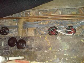

Nightmare lighting installation circa 1966-1977

ARRRRGGHHHHH!!!!!
It could have been worse. Some penny-pinching git could have saved on boxes by twisting all the earths together outside. :shock: :shock: :shock:
PS: Did you take the lids off yourself or is that how you found it. I ask because there aren't enough lids to go round. :? :? :?
No, we took the lids off. There's another out of shot.
As for the cpc's outside the jb's, they had those, too!!
Whats wrong with it? Just that its a mess and its impossible to know what wire does what? Or is dangerious>?
It's just typical of that era. Many many cables, all terminated in difficult-to-access junction boxes rather than loop-in. Some terminals have 6 conductors in. The terms can't cope: the grub screws go cross-threaded.
Also, the (already very shallow) joists have very deep notches cut out of them, with no protection for the cables from penetration.
I thought loop in ceiling roses have been common for years, I never realised they are fairly recent. At least our 14th edition install has loop in roses.
Exactly what I found yesterday whilst preparing for the new boiler to go in. Upstairs,downstairs, outside light and 1 extra in 1 JB with the earths dangling outside the JB.
All tidied up now with new JB's :oops: and separate circuits for up and down
