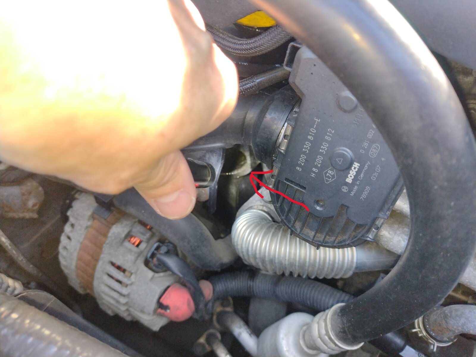

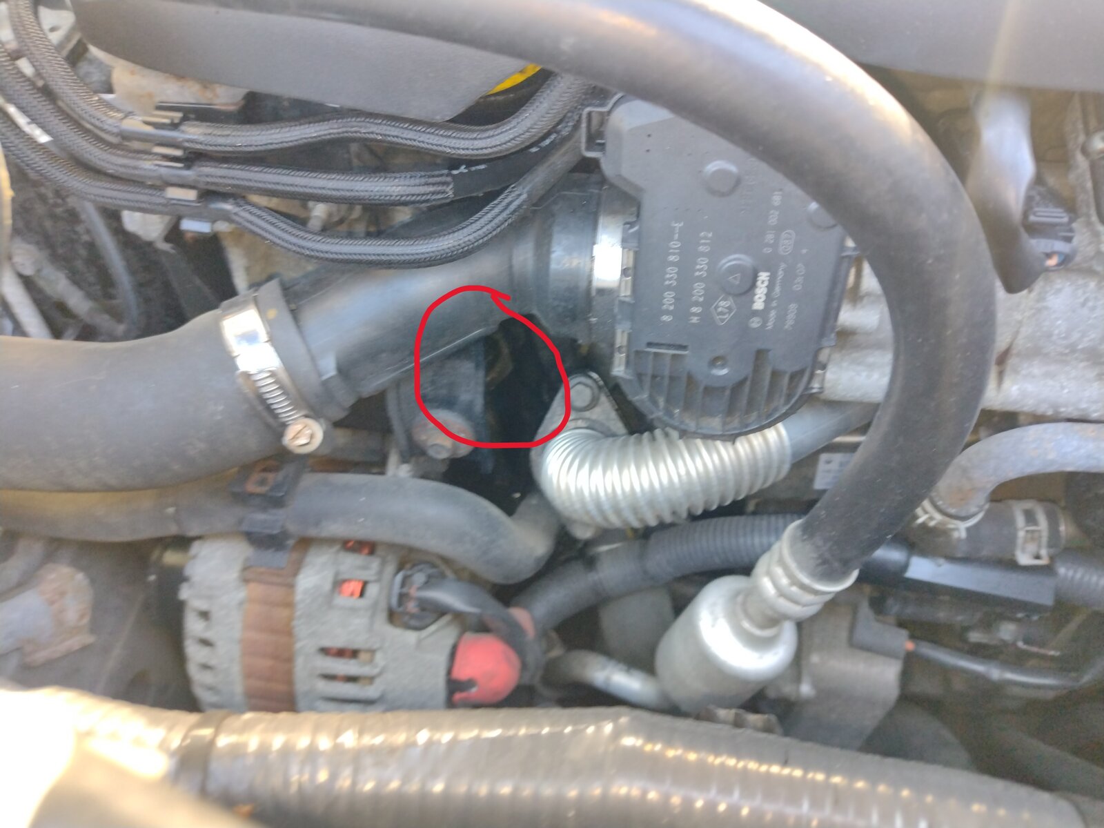

Hi, I have just bought a used Nissan X Trail Aventura 2008 oil leak, no advisorys on MOTs for last 3 years and appears in good condition. Except there is an oil leak. It appears to be coming from high up (I'm no expert). I've put quite a bit of oil in and still the dash is saying low oil. I took some photos, take a look... any ideas?

"What are common oil leak points on a 2008 Nissan X Trail Aventura?"
and you will get some suggestions.
Does the car have a dipstick? Much more reliable than the level sensor.
Re the oil leak, it doesn’t look serious from here but it’s time to remove some of the pipes in the area and give us some other photos. At the top of the engine the usual suspect is the rocker cover but that’s only a guess.
