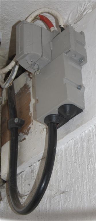

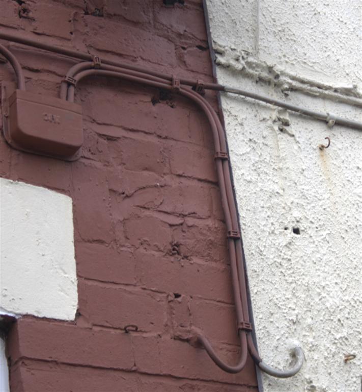

Being in a terraced house we have no outside to talk of, only at the rear of the house and then it is very small. Can not see the local supplier wanting to give us a PME, we are in the middle of a terrace. Any idea of what they charge to supply a PME. Here is a picture of how the wires arrive in the house. You can see on the top the original wires still in the render of one house. I guess that it is about 15m from the CU to the rear of the house where I could try some earth rods. Looking down the street it looks like a neigbour has put a rod in the front just as the house joins the sidewalk and buried it, can just see the wire. I've also posted a picture of the main fuse. The supplier replaced the original ceramic fuses with this and connected the meter tails to the top. It would look like the supplier has never supplied an earth and the house has always relied on the water and gas, now poly.

As its a concentric feed they may give you PME. Ask nicely.

Urban areas are more likely to be able to get PME due to their proximity to large substations (rural areas use small subbys because they only supply a few homes, therefore the cost of upgrading the subby to a PME-compatible one etc is more)
And whats with painting the cables? YEDL wouldn't do that :LOL:

The other way to go ( If yor lucky) is have a good look at the cable head and if there is a terminal for an earth then the supply authority have mis represented the supply provided and will have to provide an earthing arrangement.
